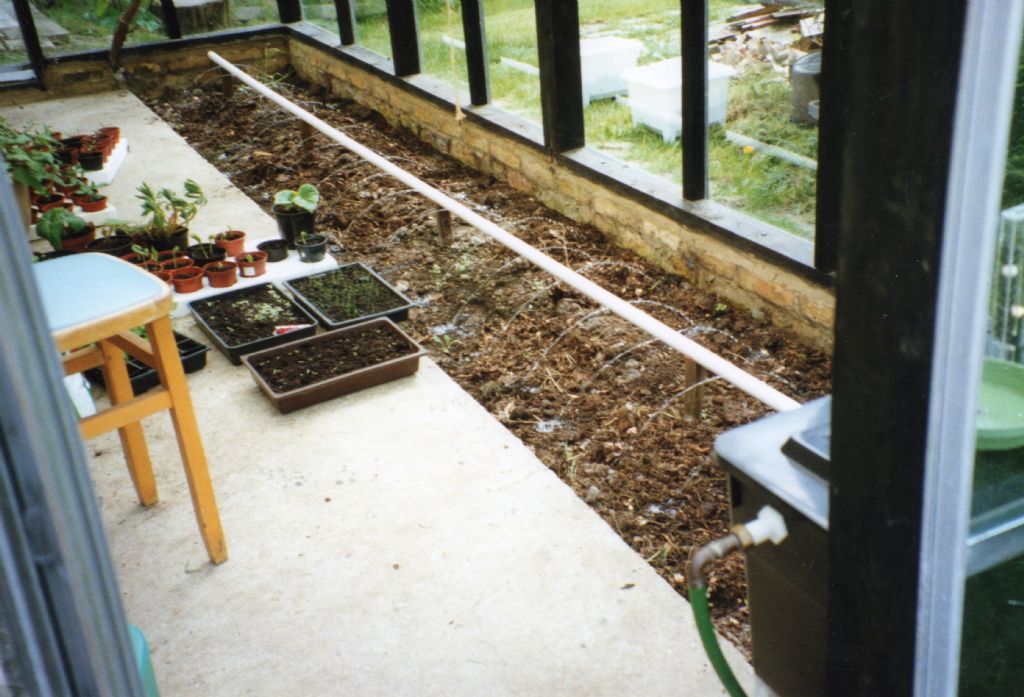

                                        watering system.jpgHi Colin,
                                        Here an evaporation controlled irrigation system. Wen the water in the top dish evaporates the water flows out then replenishes the tank for the next go.
                                        Alan
