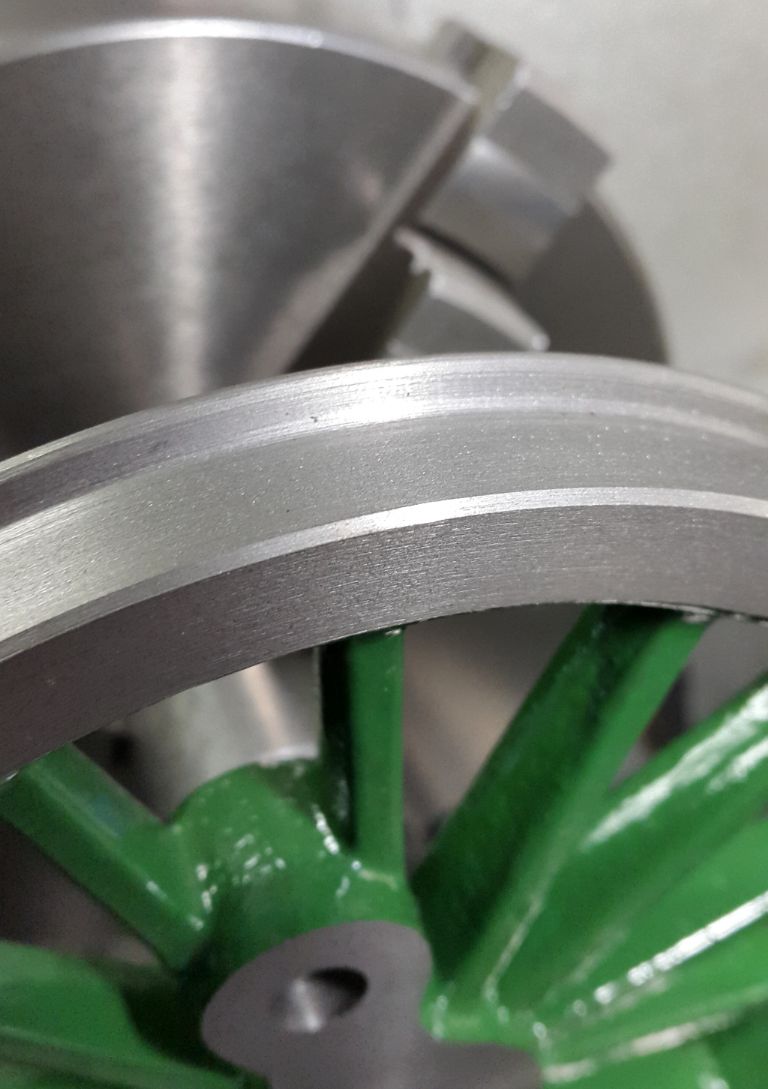

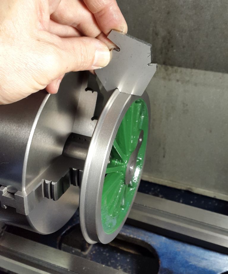

      Hi everyone,
      I have a question for the loco making guru’s. Whenever I machine the profile of the wheel I get chatter on the inner flange. Basically I machine a “square form” on all the wheels using a mandrel, then with a carbide (ground) tip, silver soldered to a dedicated holder I plunge to form the flange and finish off the taper using the taper slide. I machine in this fashion so that I can zero the lathe and cut all the wheels identically, and it’s much faster. The chatter only happens in the second I move from the top slide to the taper slide. I get the same with EN8 tires or from a profile machined directly to a casting.
      Is there a trick I’m missing?

          I certainly don’t qualify for your target ‘Advisory Panel’ … but I do know a bit about vibration.
          Mounting the wheel like that is inviting problems : It looks far too much like a cymbal.

          duncan webster 1
            @duncanwebster1
            I wouldn't do it like that! I'd get a disc about 6mm smaller than the finished OD of the wheels, mount a spike the same diameter as the axles in the middle. Make this spike longer than needed, then some tapped holes so you can bolt the wheels on through the spokes. Bolt wheel to disc, set up in 4 jaw using excess length of spike as datum and tapping wheel back against jaws then away you go.
            If starting from blob I'd just machine the back of the wheel, not the centre hole, bolt wheels on and machine rim and hole at same setting

                Luker,
                I machine wheels using a face plate method not dissimilar to the method described by Duncan. I have machined a few directly onto the face plate to get the hole straight and in the middle.
                I have read both the M Evans and LBSC descriptions and I don't like the bit about boring the hole from the back but they always seem to describe a faceplate (usually and old unused locomotive wheel) for machining the tread. I have seen a mandrel mentioned but I didn't like the look of it because it seems flimsy.
                I have never suffered with any chatter using the faceplate method. I haven't machined a huge number of wheels – about 25 to date.

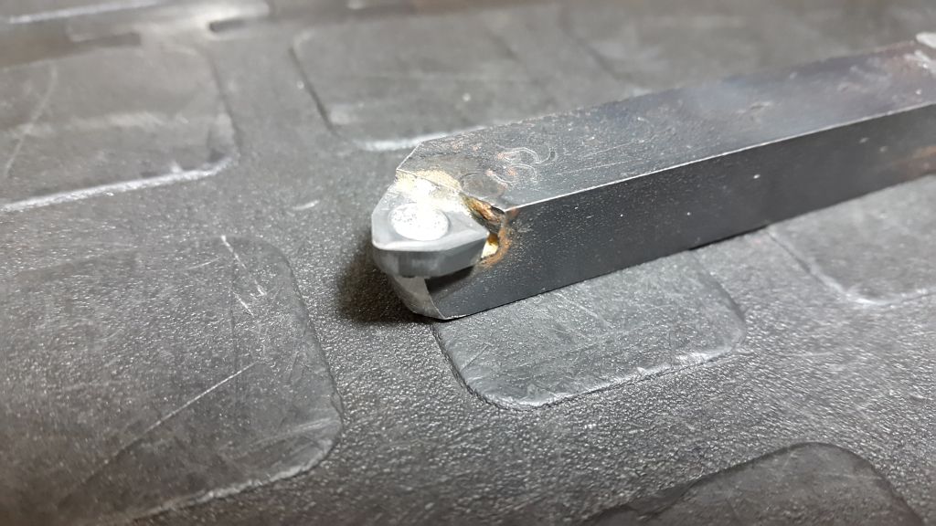

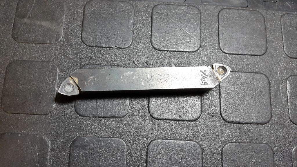

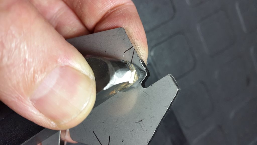

                    Luker
                      @luker
                      Posted by SillyOldDuffer on 02/04/2021 17:30:24:
                      Can you publish a picture of the tool in the lathe please Luker?
                      Looks like a vibration problem, and although Michael's cymbal is a credible suspect, tool shape and overhang may be making it worse. Vibration is a funny animal, not always obvious what the cause or mode is. That it vibrates at a particular point must be a clue, but I can't visualise what the cutter looks like.
                      Rubbing rather than cutting maybe, and that can be due to bluntness, incorrect rake and/or relief. The cutter may be scraping like a horse-hair bow across a violin string simply because the geometry isn't quite right. I'm guessing!
                      The lathe has another setup in at the moment, but here's the tool. I try to keep the overhang as small as possible, not more than tool thickness, in this case 12mm. Rake and relief is ground for CI but I machine the EN8 tires with this tool as well. It gets ground between wheels sets, that's why it looks freshly ground. I've just finished a wheel set.
                      Your descriptive words for vibration are brilliant! Please can I use paraphrase and recycle?laugh

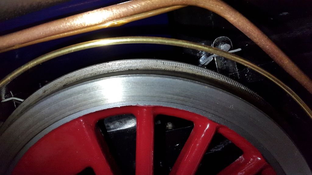

                              Luker
                                @luker
                                Posted by Michael Gilligan on 02/04/2021 18:58:10:
                                If the chatter pattern is identical on both spoked and solid wheels, and on different materials, then of course I’m happy to believe that the tool [or its mount] is to blame.
                                Top picture is of a spoked, tired wheel 150mm dia. Bottom picture is of a solid 65mm wheel. I think the pattern is very similar considering the large difference in parameters, but I'm not an expert in these things!
