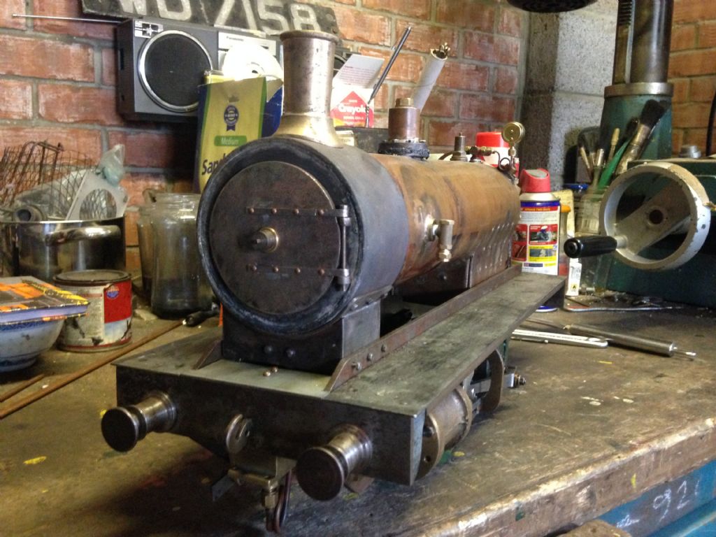

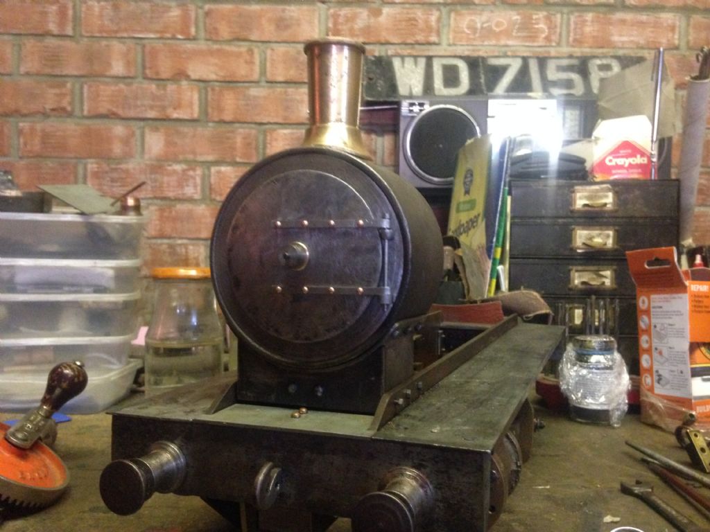

I've completed the smokebox door assembly; the hinge straps have been cut, had the ends rolled over (harder than it looks if you want neat results), bent to suit the contour of the door and have been drilled and riveted on with 1/16" dome head copper rivets. The copper rivets stand out nicely on the bright steel and I'm almost tempted to only paint the door and not the straps and rivets.
The hinge lugs were turned from square-section steel, rounded/shaped and threaded 5BA to screw into the smokebox door ring and drilled through to take a 1/16" dia. hinge pin. The hinge pin (not really described in the build articles or on the drawing) was made from 3/16" dia. BMS to a total length of 1 5/8" with the head of the pin being 3/16" x 3/16" (length of the pin without the head being 1 7/16".
The smokebox door ring was silver soldered into the recess in the smokebox. The petticoat pipe was also made from a length of copper tube and one end was expanded from 3/4" dia. to 1" dia. by heating the tube and squeezing it in a vice with a necked socket in one end. This was press fitted into the hole in the top of the smokebox. The chimney was also bored out to be a snug fit on the petticoat pipe so no ugly fixings will be required, I'm sure as long as the loco doesn't end up upside down I won't lose the chimney.
I have also made a blast pipe jet, it's made to the drawing however when talking to a Juliet owner at my club he says he has a much smaller jet screwed onto his blast pipe. I suppose only time will tell if bigger is better!? (the advantage of having screw-on/off blast pipe and blower jets!). All of the front end plumbing has been completed and dry fitted for testing of which it passed with flying colours.
I air tested the engine, with the frames up on blocks, by screwing a pipe to one of the clacks for the air line to fit on. The pressure gauge worked, all the back head valves worked (blower valve doesn't seat fully but not overly fussed about it), the regulator did what it was supposed to, and most of all the wheels turned until the air ran out. Something must be working correctly internally and in the front for air to get from the boiler to the cylinders and make them work!
For a quick check, I brushed around the engine with a solution of washing-up liquid and water to check the air-tightness of the valves and joints. Soldered joints were good apart from a slight hairline in the dome cap, so not a terrible thing to sort. Water glass needs some tampering with to get it to seal up fully and the majority of the front end pipe work leaked although none of it has gaskets or PTFE tape/jointing compound on it so I'm sure they will be fine when I do the final assembly.

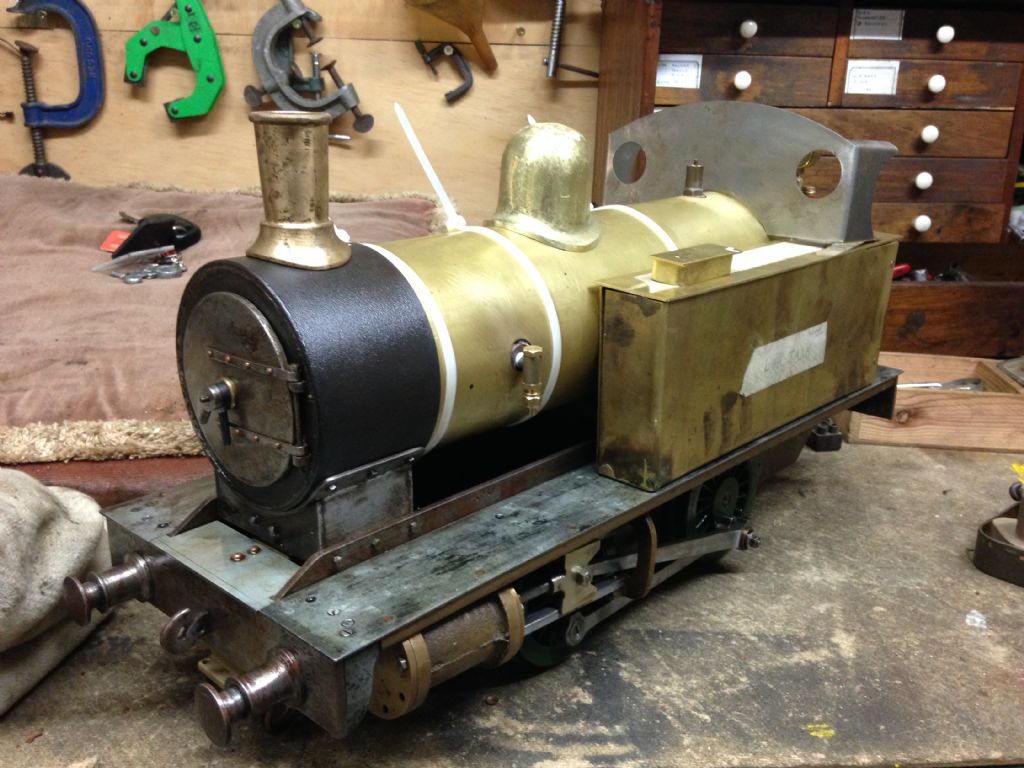

There's been a fair bit of milestone work carried out since the last report, mainly the finishing of the side tanks. The top covers have been cut to length and shape. I made up some square rings (rounded corners) for the tank lids out of strips of brass sheet by annealing then some awkward pulling and pushing around a small wooden former trying to get the corners to form nicely and keeping the ring square in all 3 planes. I then cut the excess material off and silver soldered the two ends together in a butt joint. These turned out fairly well and remained largely uniform.
Next I made the lids themselves out of brass sheet and chamfered one end to help with silver soldering on the hinge. I made the hinges out of brass bar with a 1/32" hole through. The hinges are in three sections, with two being soldered onto the ring and one soldered onto the lid to fit between the two on the ring.
Since the lid assembly was complete, I decided to drill the tanks with tank tops in situ with four 8BA holes along both edges of each tank. The holes were drilled through the tank top into the brass angle underneath. The tank tops were drilled with a clearance drill, then a tap was run through the hole in the brass angle and the tank top was countersunk to accept the screws. Once this had been completed, I worked out where I wanted the lids to go and set to milling the holes out to fit the lid rings. A 3/8" slot drill was used to do this as it fit the radius of the rings quite neatly. After this was finished, the rings and the tank tops were cleaned, fluxed and soft soldered so that the rings protruded roughly 6mm above the surface of the tank top. In order for the tank tops to fit flush to the tanks, a recess needed to be cut into the brass angle to let the bottom protrusion of the ring to come through. These recesses were filed out until the tank tops fitted.
Once the main structure/assembly of the side tanks was completed, I then finally fitted the hand pump (one of the very first things I made for the loco). To find the right position, I placed the pump in the tank with the handle positioned 90° vertically and so that at this point it was in the middle of the ring. Its position was marked and 2x 4BA holes were drilled into the hand pump base and clearance holes drilled through the bottom of the tank and through the running board.
Since the hand pump was now in and I had a spare few minutes, I marked out where I wanted the union to go (the one that carries the feed from the hand pump, through the tank wall and to the clack valve). This was marked out, drilled and tapped 1/4" x 40. The short piece of pipe work between union and clack was then bent and fitted and is now on the bench waiting to be silver soldered.
Plumbing preparations have been made to the LH tank (axle pump) by drilling and fixing the bypass valve to this. My plan is to make a 90° double union to screw onto the axle pump outlet to connect to the axle pump and the bypass valve. I have made a 90° single union for the bottom of the axle pump for the feed from the side tank.
I have planned for the RH tank to be dedicated just to the hand pump and the LH tank will be just for the axle pump rather than having a balance pipe to connect the two as is described in the ME articles.
The rest of the plumbing will be finished off, the tanks will get silicon sealed and the fitting on the grate/ashpan will follow in due course.
