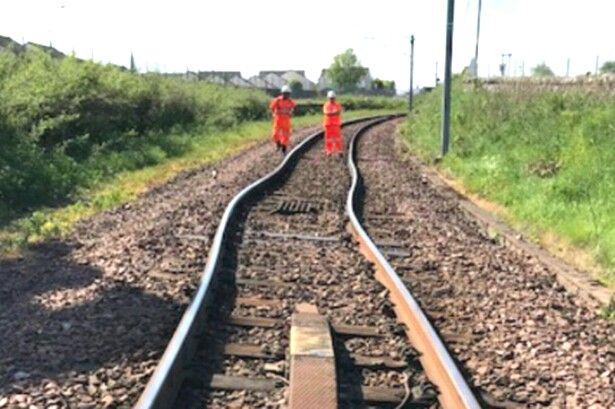

                      There was a photo of some buckled track near Glasgow in various papers…

                                        Continuously welded tracks are pretensioned before being welded to give neutral rail forces at some temperature, I think it might be 20 degC or maybe 25 degC. When the temperature exceeds the neutral temperature the rails are in compression and looking to buckle like the picture above. To counter this the ballast (loose stones holding the sleepers or ties in place) is extended a minimum distance either side of the sleepers (one foot springs to mind) to constrain movement. At the limit, all is well until a train comes along and gives everything a good rattling. At higher speeds the rattling is worse and the track is more likely to spring out of line. Hence the speed restrictions on very hot days.

                                                In modern long welded rail sections the rail is cut and welded into place under tension to reduce the likelihood of distortion under expansion. Basically once in situ the new rail is cut slightly too short using laid down formulae to determine how wide the gap should be depending on the ambient temperature at the time of installation. Once cut the resulting gap is often only an inch or 2 but the new rail then needs to be stretched using hydraulic rams (referred to as pulling kit). When the rail is stretched an the resulting gap closed up it can be welded into place, the pulling kit holds the rail under tension until the weld is completed. After welding has been carried out the pulling kit is removed and the excess weld is ground away to leave a smooth continuous running surface.
                                                Effectively it means all continuous weld rail (CWR) is deliberately slightly too short and under constant tension. After years of use the pounding of the wheel on the rail tends squash the rail and make it longer when this happens the risk of heat distortion becomes a risk so it is usual to 'restress' the rails by cutting out a small piece then closing up the gap to reweld it.
                                                Owing to the way rails are installed under tension it is rare for new track to be laid in the extremes of temperature / weather. Ocassionaly after derailment damage it is necessary to intall new track at short notice but ordinarily it is planned to take place when it is expected too be neither to hot or too cold for stressing
                                                This photo shows the pulling kit stretching new rails prior to them being welded under tension.
                                                https://permaquip.co.uk/en/product-store/stressor/stressor-hsm70-with-flat-face-couplings-(ffc)/

                                                    Dave, the rail is actually stretched despite it sounding far fetched.
                                                    In a length of CWR (usually 600ft) stretching by a few inches doesn't take as much force as you might expect and is easily acheivable with pulling kit.
                                                    It's usual to retress after rails have been in use for a number of years, this is because the downward forces (and heavy braking in some areas) cause the rails to lengthen (rail creep) and therefore reduce the inbuilt stress. Restressing by removing a small amount of rail then pulling the gap to reweld is primarily about restoring the stress and not necessarily straighten out any slack.
