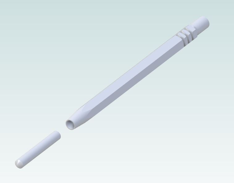

      Hi Guys well unless I've missed something high carbon hex steel is not easy to source in Uk especially in small quantities. So my options are;
      1.Just use round in stead of hex.
      2.Do it in mild steel just for the exercise
      3. Find another project
      4. Use an old suitable hex alum key after annealing
      I am tempted to do it in mild steel as it is the practice that is paramount and therefore no real waste.

        Another option as you are only going to be doing light punching would be to get some easily available 6mm or 1/4" hex mild steel and drill say a 4mm hole 25mm into the end and Loctite in some 4mm silver steel that has previously been turned to a point, hardened and tempered.
        While you are at it make a matching dot punch which is used first to accurately place a small indent that can be pulled over to correct any drift before enlarging the mark with a centre punch.
        This would still give you the practice with harder material, The hardening & tempering process as well as drilling holes. You would also have a usable tool at the end rather than a mild steel one that is no good to anyone.

          Hi Jason, I already changed my mind from using mild steel. Now going the 6mm silver steel route for entire thing. Like your idea. But questions in relation to your method.
          1. Why use silver steel for end piece would o1 be as hard when hardened? Can't see reason for silver steel other than needs to fit exactly into drilled hole.
          2. Would loctite hold as it will be subjected to shock? Any recommendation as to which loctite??

              Posted by Christopher judd on 21/08/2019 16:44:06:
              If You look back at the replies to your questions you will see one from Andrew "Silver steel and gauge plate are sold in the UK as such and are roughly equivalent to W1 and O1" It is basically the same thing, if you did not read American books you would not be talking using common American terms. Nothing to do with fit as I would not have said a drilled hole if things needed to be exact.
              My suggesting allows you to still use readily available hex stock but have a point that can be hardened
              Provided the end of the "point" was up against the end of the hole there would be no problem, on clock work you will only be needing a light tap not a whack with a lump hammer. I tend to use Loctite 648 for most things but 638 would be more than adequate.

                      Ideally you want to know the grade, go with a seller  who says their 1/4" hex is at least EN1A. This would be very easy to machine but no good a as punch
                      You won't be able to harden EN1A to use as a punch, without knowing what the other "freecutting" metals are it is hard to say but probably not hardenable for this use.
                      Does this mean you are now going back to using mild steel?
                      The bolt will be a 5/16" UNF thread form with 24 threads per inch (tpi) as imperial fixings tend to use tpi and metric the pitch between each turn of the thread.
                      In the long term think about what system you want to use, not much point in spending out on UNF taps just for a project when you intend to work mostly in metric in the future, alter bolt spec to suit
