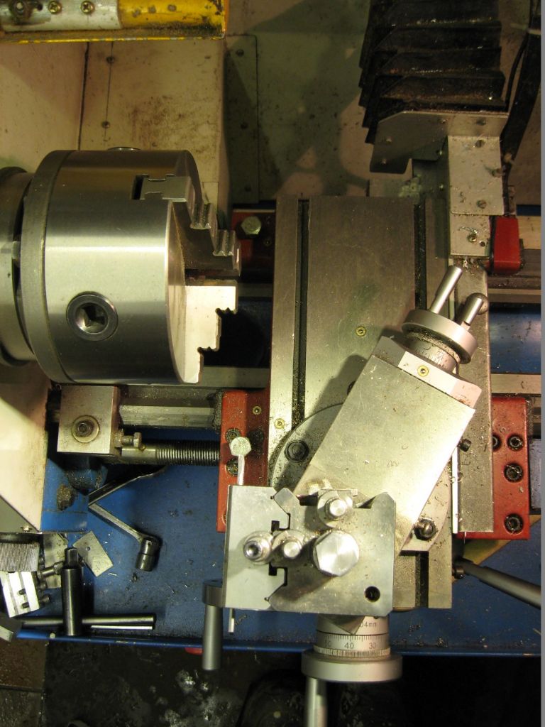

        This is a picture of the method I suggested. You may gain just enough on the diameter.

                      Thanks Les… I see what you mean. I may try that if I the boring bar idea doesn't work.
                      Why do they place the compound rest so far to the left of the cross slide? What's the rationale?

                            Like this
