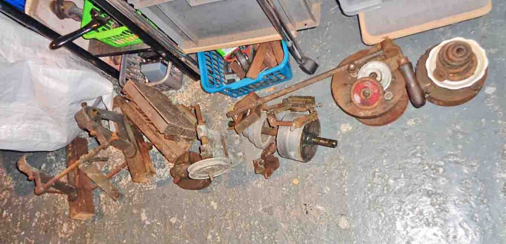

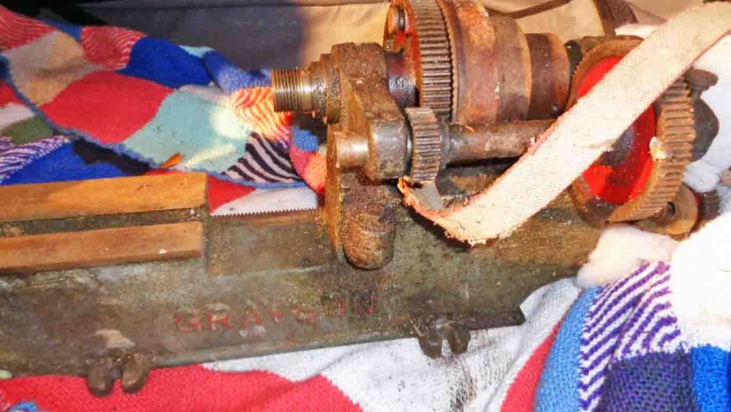

      Hi All,
      Funny how things sometimes come together!
      Sunday morning walking around a large car boot that we do not normally go to I saw an old lathe tailstock on a table and bought it for £3 from the sellers wife.
      An hour later I wandered by again and she called her husband over and said loudly 'That's Him!'; I was a bit taken aback but the bloke said he had some other bits and pieces like that which were in the way. He was unable to offer more detail other than there was a 'long metal thing' under a pile of rubbish in a shed that he was going to bin by the ned of the week.
      I took a chance and made a drive over about an hour away in the middle of a forest, waited for him to show up to get me past the biggest dog I have ever seen!
      This is what I got for £15:

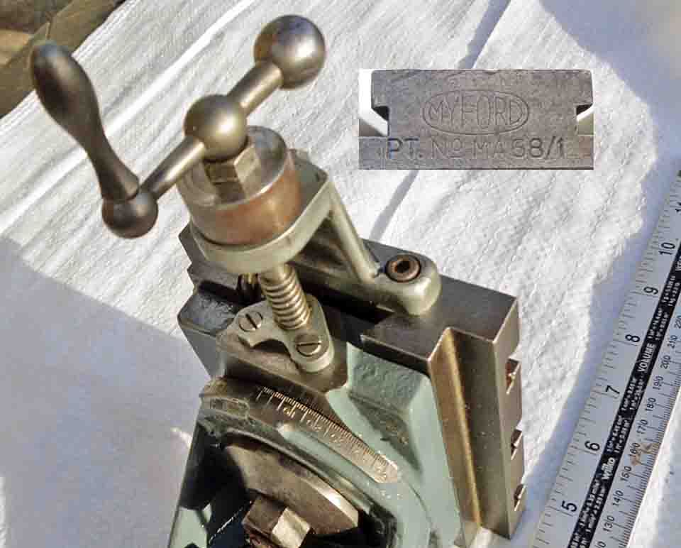

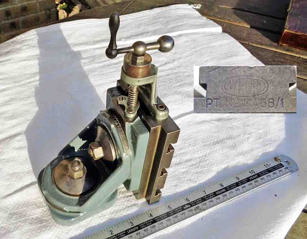

      Alsoin the box was a Myford Swivelling Vertcal Slide and a really nice undamaged 4" Starrett Precision level all wrapped in oiled leather!
      Just as I was leaving he said, 'Hang on there's also these' and produced the original change wheels and brass oilers!
      Thats this weeks cleanup project sorted out! smiley

          Martin,
          What a snip.
          The Starrett level alone is worth the dosh you paid. Keep the Myford slide (or flog it) then weigh the rest in with the tat man and your'e in an "obscene profit situation"! If thet old Grayson does clean up, someone will have a bit of fun learning how to use it. Well done you.
          I think the least you can do is buy the dog a couple of cans of Butchers Tripe!

              A bucket of brick cleaner will soon sort that out.

                  Hi Al,
                  Will pull the lathe apart tomorrow, weather permitting and see what we have,
                  There are a couple of broken castings on the countershaft brackets but the heaadstock looks oK so far. 3 jaw & 4 jaw chucks, cobbled up steady, face plate, full set of change wheels etc so not bad at all.

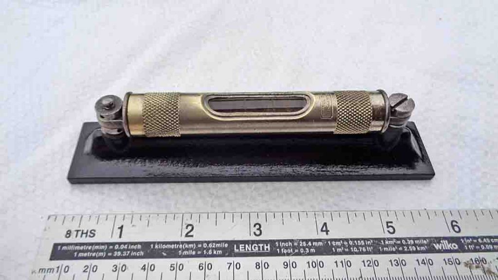

                  The level cleaned up well after freeing off the adjuster collars and running a 3/16£ BSF tap and die over the threads:
                  The Myford slide is all stripped and repainted, looks in good order.

                      It may not matter much but I doubt if a Starrett level has BSF fasteners.
                      The level looks very nice.

                          Hi ega,
                          I was a bit surpised also but the thread is 3/16" 32tpi so I assume BSF?
                          These levels are really very nice; I currently have about 10 in various sizes awaiting a source of new vials but will not pay £30-£40 as not viable. I sometimes get some at David Stanleys if a certain dealer is there, he will let me have a few now and then.

                            Got the Grayson apart today, taking pics as I went along.
                            It is mostly in pretty good order just dirty and gummed up, headstock is fine, tumbler reverse is good, one tooth missing on the small idler gear. There is no compound slide and just a basic toolpost with a set of cutters in a box. The ways look very good under just a light powdery surface rust, Scotchbrite will do the trick I think. Quite a few of the grubscrews have manky slots will replace them all. Tailstock missing one clamp just a bodge fitted.
                            The Myford Vertical slide was just covered in thick grease, cleaned up well and given it a coat of RAL7100 grey!
                            Will start the cleanup and reassemby tomorrow.

                              Thanks for your response. I have never felt at home with American threads but I think it more likely that your level has ANF 10 – 0.190" OD x 32 TPI and, of course, 60 deg thread form.
                              I have a 12" one of these lacking a cross vial. Checking the Starrett catalogue, I notice that the longitudinal groove in the base is of involute form for better seating on large shafts – something new every day!

                                ega,
                                Just checked the static screw, yup, 0.187" OD, For me, close enough to use BSF for cleanups.
