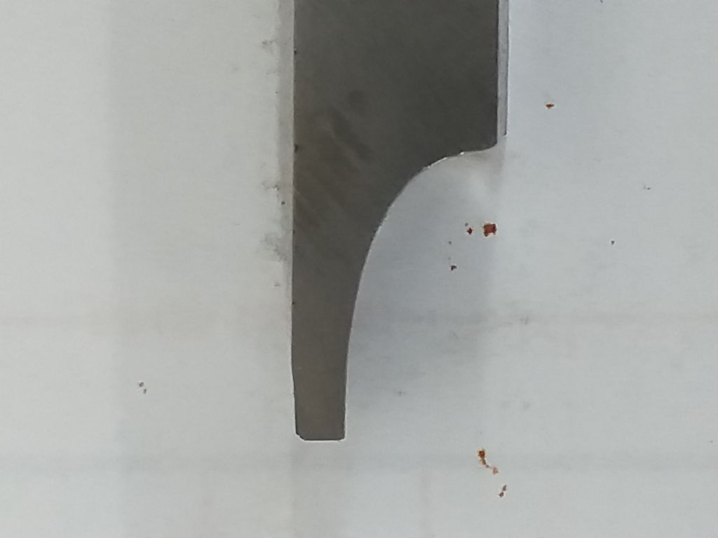

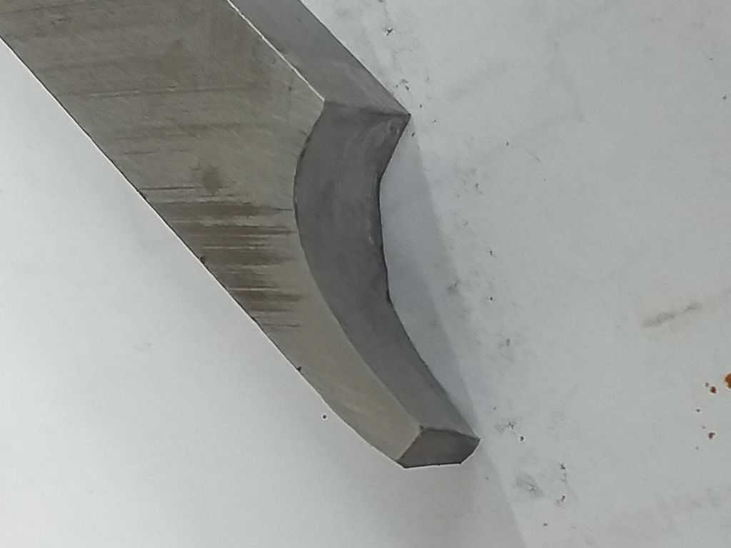

      Hi
      I have just used a bench grinder and ground my first form tool in HSS for making some brass bits. The cutting edge is about half an inch in length.
      Can anyone tell me what is the best way of smoothing out the edge and sharpening this? As its a curve its not obvious.
      Thanks
      Rich

        Howard Lewis
          @howardlewis46836
          A round fine stone, or a round diamond hone?
          Howard

            #408516
            ronan walsh
              @ronanwalsh98054
              Howard has it, i always smooth out cutting edges on ground tools with a stone.

                Baz
                  @baz89810
                  Bit of brass or Ali held in pillar drill chuck and run slowly with a finger full of valve grinding paste and then present the tool at a slight angle. In a couple of minutes you will have a narrow band finely ground, a quick stone on the top and the jobs done.

                  Mick B1
                    @mickb1
                    Once you're happy with the shape, finish and clearance angle of the curve, grind the top face to produce the edge. If you put a few degrees of side rake on it, it'll work well enough for most other common materials as well as brass.

                    Anonymous
                      For free form shapes I hand grind, possibly against a template, and finish with diamond hones. If the profile is important I'll machine it and finish with diamond hones.

                      Ian S C
                        @iansc
                        For a similar shape to your's Rich I grind out the bulk of the metal on the bench grinder (now I would start with the angle grinder), then get the shape near right with the Dremel, and use a slip stone to sharpen (as used to sharper wood gouges).

                          Dalboy
                            @dalboy
                            For sharpening my HSS turning tools I use a diamond card with a little window cleaner as a lubricant, so I would go with a round diamond file and do the same Once you have it very close to shape

                              Ian S C
                                @iansc
                                Rich, in the Dremel I use a stone just smaller radius than the the shape to be ground out, get as near a you can on the bench grinder first, Baz's method would then be good to finish the tool.

                                Nick Hulme
                                  @nickhulme30114
                                  You should grind your form tools such that they have the angles required, and not "Sharpen" them afterwards.
