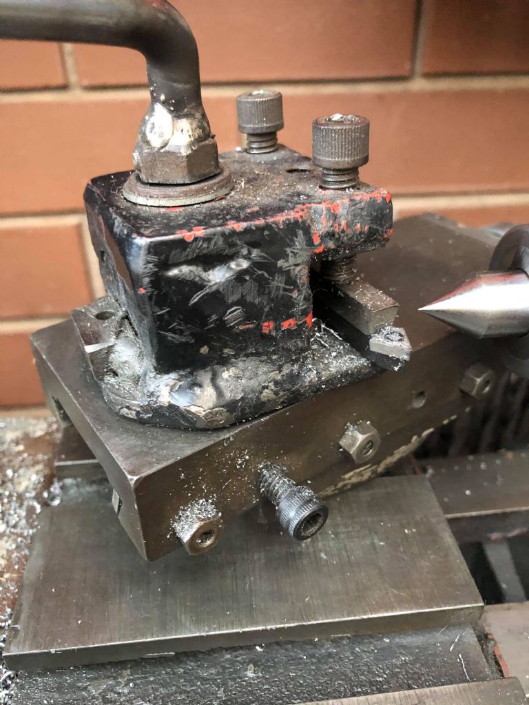

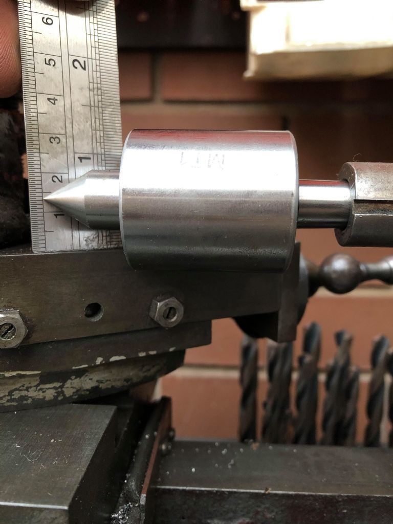

          OK upon further investigation i realised that my tool post is 100% 'home-made', and not even the good kind. In my head i pictured it very differently, and you are right, they are nothing alike.
          Standard 1/4 tooling is obviously not right, either.
          98001276_281218689716763_3493935326697619456_n.jpgThis shows me that centre height is 13mm approx without the base. I am so confused as to why anyone would be limiting their tooling to less than 1/4 instead of the factory 3/8 or so. Considering i have 13mm to play with im wondering why i dont just buy 1/2 tooling. Anyone had any luck with that? Or opinions as to why or why not?

              Your toolpost rather looks like this has a piece welded on the bottom , looks a little like a untidy weld to me , your 13mm gap beetween your centre and your top slide would allow you to use a 1/2 inch tool if than lump was missing on your toolpost. My Faircut is the Junior , I have checked the gap on my lathe , this just under 10mm or just right for 3/8 Tools.

                You are absolutely right. I tried checking the centre height from the chuck like Andy suggested, but i wasn't confident in it's accuracy as the chuck would not grip the taper of the centre properly. It appears that it is just right for 1/2 tooling, though i'm not sure if i should be focusing on 1/2 or 3/8. I don't really know what the practical difference is between the two, and im not finding much information online.

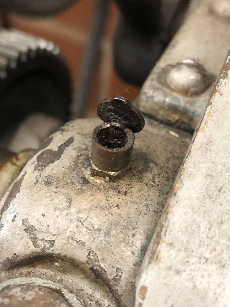

                I wanted to share the oil caps, they look factory to me.

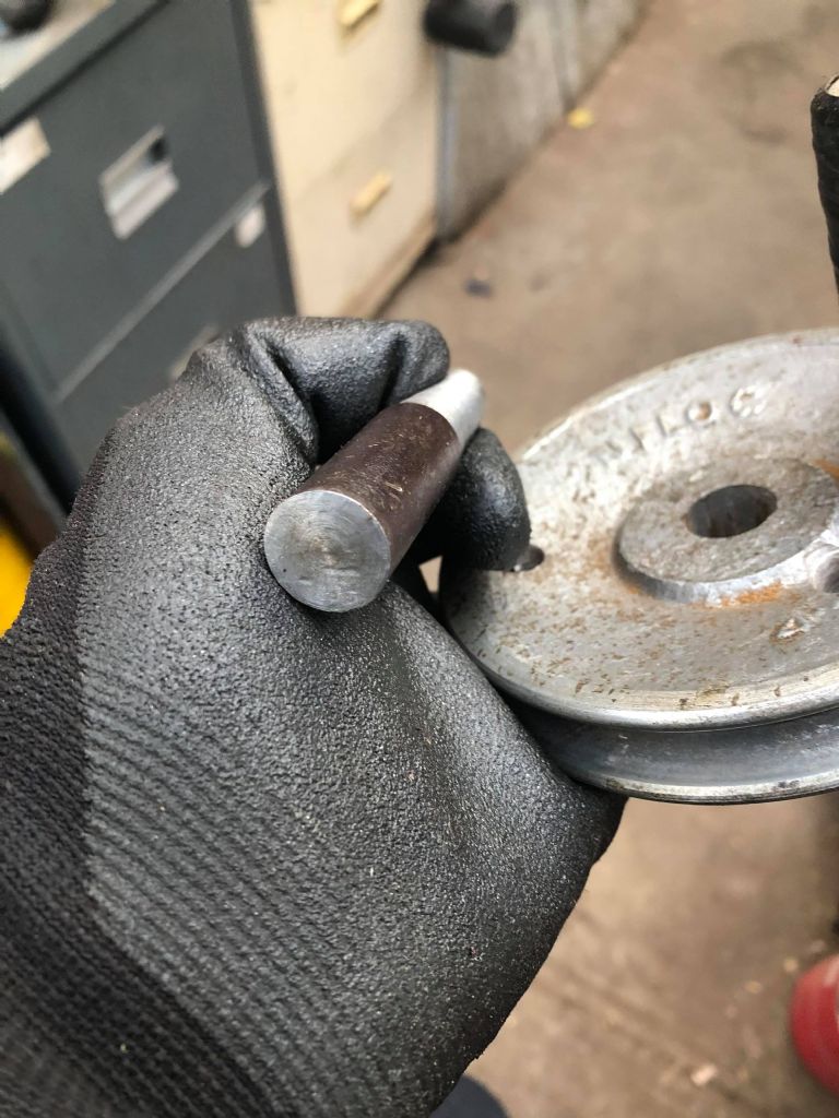

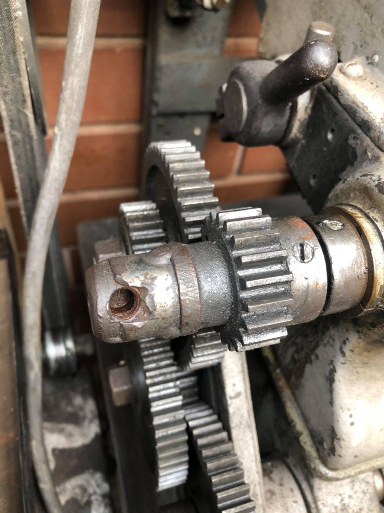

                Also i was wondering if anyone knew what this add on could be for? Perhaps a provison for spindle locking?

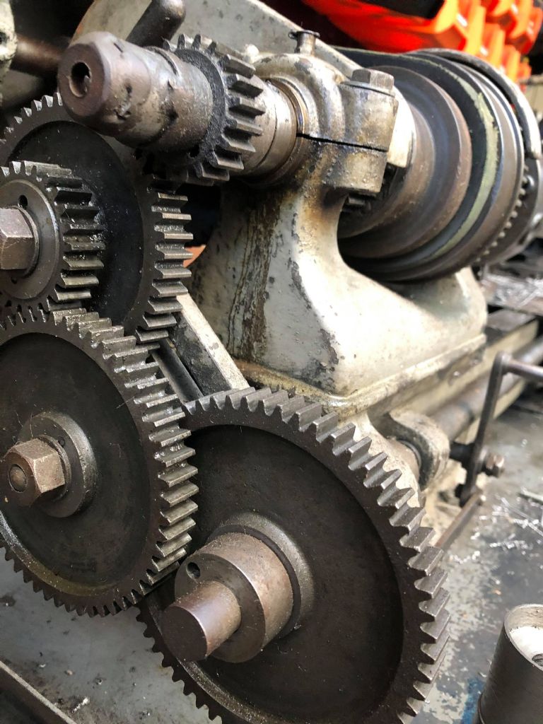

                And these are the gear sets close up
                99293203_533658857305674_7643206152217427968_n.jpgI would like to get around to working out exactly what i have and what threads i can cut with the appropriate combination.

                  I wouldn't rule out your oil cups being factory ones but they are different from mine. My lathe has plain holes and the spigot on the bottom of the oil cup is plain too. If you decide to replace them then don't make the holes in the bearing housing any bigger… which will probably rule out some off the shelf retro fit oilers.

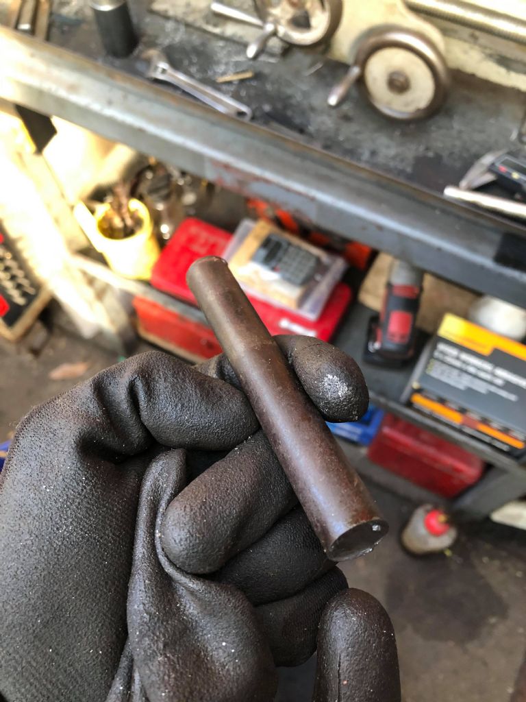

                  My guess is that the thing on the back end of your spindle may be the remains of a retro fit mandrel handle. These are used to turn the spindle by hand when screw cutting – it gives a lot more control over the stopping position… and is better exercise
                  Hopefully your mystery 'thing' will unscrew from the spindle. The original factory part in this location is a knurled collar. If you want to replace it then the thread on the tail end of the spindle is 5/8 BSF as far as I can tell. I now have the 'correct' collar on mine but prior to that the previous owner used a metric nut which didn't fit correctly and I replaced that with a proper 5/8 BSF hex nut.

                            I guess your Lathe chuck centre is 13mm to its centre from the bottom of your top slide , this should acomodate a 1/2 lathe tool . To remove your Lathe chuck use the chuck key give a hard tap with the palm of your hand this normally works on my lathe with all chucke and my face plate . The thread is 3/4 BSF Right Hand on my lathe I supose yours is the same . If the palm of your hand does not work a sharp tap with a piece wood may be a little more forcefu.

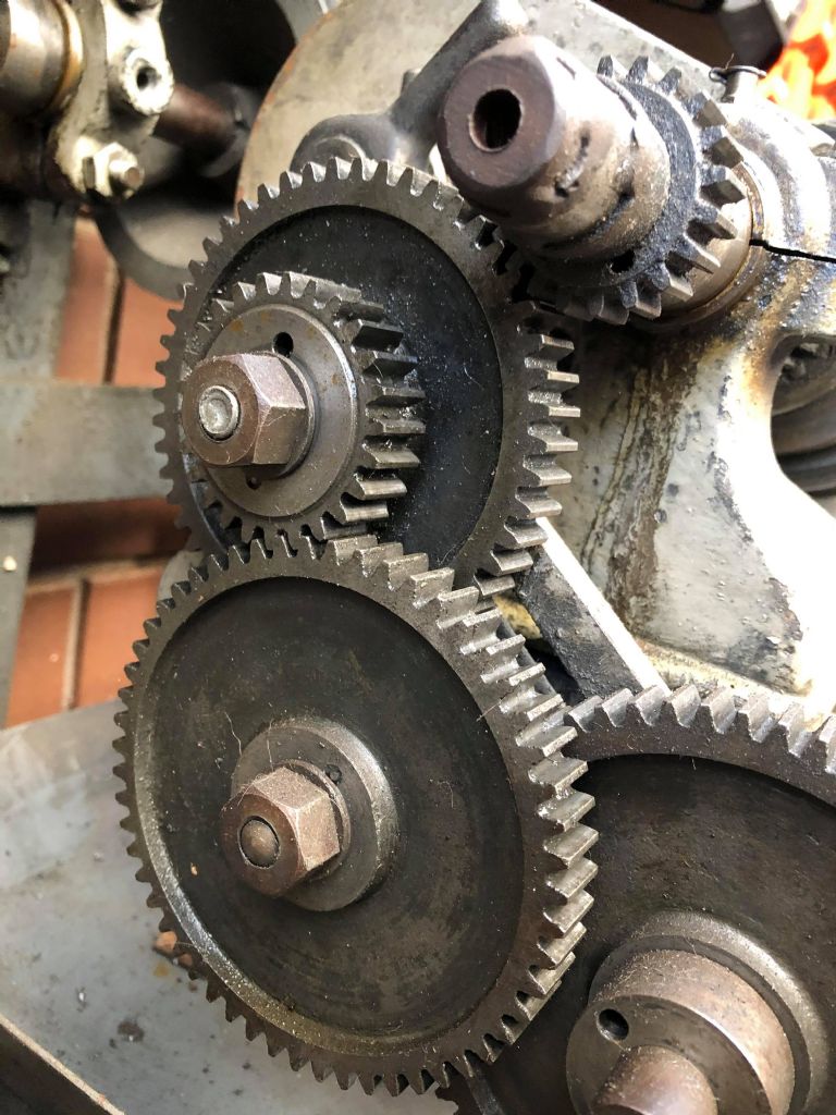

                                Your Pic 25/05/20. I wonder if this is picture is showing correctly , Your Main drive headstock gear only appears to be half engaged with the driving gear.
                                This may cause uneven wear on both gears, Hope this is just a picture fault ? i Think some adjustment may be required.

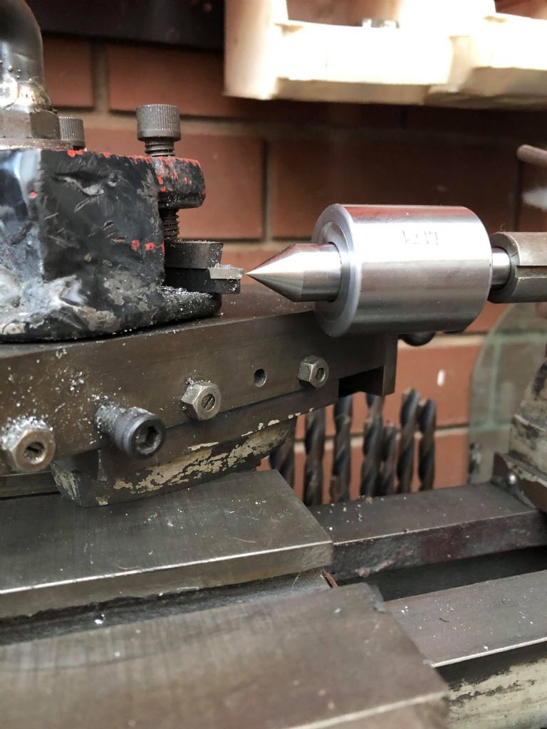

                                  Ok so i checked the centre height again by pushing the live centre all the way back so that the flat part of the back squared it up decently on the chuck jaws. Looks like my centre height is 11.5mm. This makes sense considering the fact that you have to shim the back of your cutters up. I also conducted a little experiment by shimming up the back of the 1/4" tool (thanks for the tip) to where it would no longer leave a pip on the face an measured that. It was 11.5mm again. So my question is: do i buy 1/2 tooling and shim the back up every time i change tools, or do i buy 3/8 and use a single 1.5mm shim? I was so close to buying 1/2" tooling i could almost taste the chips.
                                    Good Luck Brianl
                                    Looks like it is 11.5mm. The 13mm in the tailstock must be due to misalignment unfortunately.

                                          Yes I had a better look at it today. I managed to unthread it from the spindle quite easily. There is a cylinder welded to that knurled collar like you said. i'm assuming that collar is the factory part. How does it take up slack?
                                          I'll look into the gear engagement, I might have to adjust them slightly. Should it be engaging all the gear? Doesn't that wear out the teeth and the gullet?

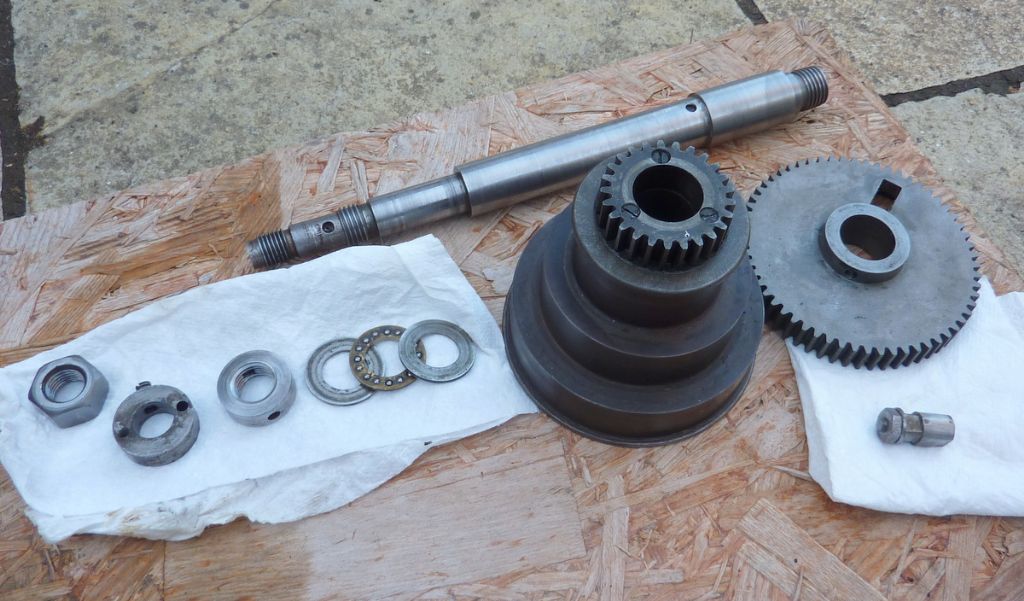

                                                One nice thing about the Faircut is that the spindle bearings are (phosphor bronze?) inserts into the casting… so if the worst came to the worst then new ones could be made but hopefully it won't come to that.
                                                The knurled collar is just for keeping the change gear in place. Starting from the rear face of the bearing on the back end of the spindle there should be…
                                                1. End float adjustment collar (screwed onto the spindle)
                                                2. change gear drive collar (slides on and is secured with a grub screw)
                                                3. the first change wheel (slides on and is secured by pegs engaging with the drive collar)
                                                4. the knurled collar (screwed onto the spindle)
                                                Number 1 is for adjusting the end float. this collar has a hole to take the adjuster – the proper tool for this is a 'C' spanner… which I confess that I don't have.
                                                Here is a photo of my spindle when I had it apart. The change gear is not in the pic. On the left you can see the three collars (but I had a nut instead of the correct knurled collar at this time). Inboard of the tail bearing you should have a thrust ball race which consists of the cage and two washer-like things. Then comes small backgear/cone pulley assembly and then the bull gear with its engagement peg before you get to the spindle nose bearing.

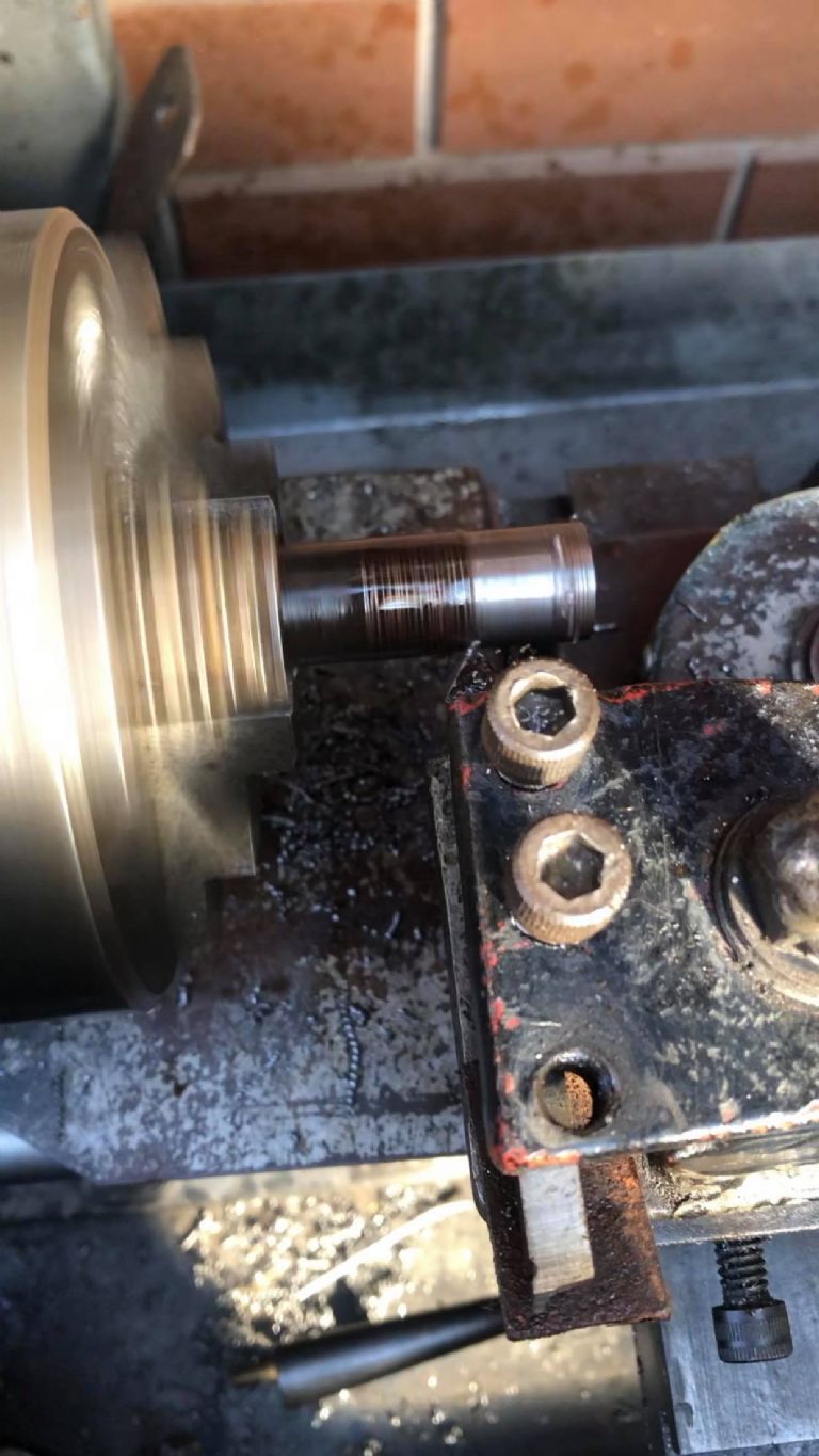

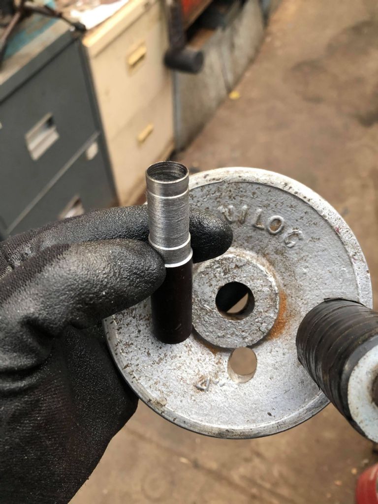

                                                  It's curious to say the least. It was the reason i thought my lathe was chattering at first, turns out it was just inexperience.
                                                  So today i am proud to announce that i made my first proper chips, thanks to the help i received from you both. I decided to make a shaft to convert the adjusting mechanism on my table saw from 'winding door knob' to 'handwheel'. I started with some 16mm round stock and turned down half of it to the required OD. I then drilled the inside to the required ID. Unfortunately i got too close to the OD when drilling and warped a third of the part. By this time i was probably 3 hours in so i quickly roughed out the rest of the part and drilled a hole with a bit more meat to spare. Worked really well and i am really happy overall. Up until this point i was unable to do anything with the lathe but today was the first time i felt like a machinist albeit an inexperienced one.
                                                  101742893_623779971815262_5941353013259426356_n.jpg 102660778_969049873547602_1911551645115789208_n.jpg
                                                  Ignore the poor surface finish as i was in a hurry having wasted a lot of time already. Ill probably go back and touch it up. Point being it didn't chatter and i was left with proper turning marks! The first time i ever tried, the finish was so poor i thought the lathe was broken. Despite the bearing play it still works well which is a big relief. I know that if worst come to worst i can make new bearings but this would require a bit more experience than what i currently possess. Especially so considering i don't have information on the factory specs for the bearings.
                                                  The only significant problem i had was with the tailstock. It needs adjusting and had a tendency to wobble the drillbit, especially the centre drill. I found that the MT1 taper didn't really lock in nicely as it spun with the bigger drill bit in the Jacob's chuck more than once. I couldn't seem to get it locked in nicely. I attempted to adjust the tailstock as best as possible by loosening the centre bolt but it was all by eye. I think the wobble is what warped the part initially once i turned it down thin enough to be a bit malleable.
                                                  As for the picture you posted Ill have a look at mine and compare. It helps me better understand the machine and what makes it work.
                                                  All in all i know it works and i am very happy!

                                                    That's great news Jake, glad you have got some useful work out of your machine.
                                                    Check your tailstock taper for scoring and get hold of an MT1 finishing reamer if that is the problem. Also check the taper on your chuck. If it has any 'dings' or scoring lines then take a stone to them by hand – you need to take the raised bits off and just leave the hollows.
                                                    The quick way to get the tailstock aligned is to put a dead centre in the headstock and tailstock and bring them together trapping a ruler or a bit of metal strip of similar thickness in between. If the strip skews left/right or up/down then you know which way the alignment is off. Left/right is easy as you have seen. For up/down you will need to put some shims between the main tailstock casting and the base.
                                                    The saddle/cross slide gets in the way when you are doing this job. You don't really want the barrel extended too far. My tailstock securing nut (the one that clamps it to the bed) has a tommy bar 'handle' screwed in. If you can get the tommy bar unscrewed (it may not play ball) then you can fully undo the securing nut, take the tailstock off and mount it on bed between the saddle and the headstock.
                                                    Even with the alignment perfect you will probably find that the barrel droops when extended. The barrel clamp helps but it still happens.
                                                    Regards, Andy

                                                      Hi Jake.
                                                      Looks good just give youself time you learn slower when you take time dont take one heavy cut i much prefer 3 cuts 2 nearly there and the last one correct, I have no free end play in my spindle perhaps you need another shim or to tighten the spindle nut a bit more . I have a bar that fits into my chuck with the tailstock end turned to fit , there are a number of way to align the lathe chuck centre and tailstock , One a ground steel bar centre each end , And a dial gauge held in the cross slide moved along the bar will show up any misalinement.you can hold the bar in your chuck or use a morse taper each end. or use a set of chuck soft jaws which have been bored to the correct size for the bar you are useing this way you know chuck centre is correct,
                                                      Well done Good Luck Brian
