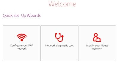

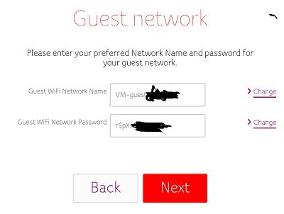

                      If you are on VirginMedia and probably most other ISPs your modem / router will allow for a visitor wireless network. This allows you to give a visitor a connection SSID and password for their phone etc that is different from your main one. They can connect in all the usual ways but are blocked off from anything else in your house.
                      Few people use this facility, I'd completely forgotten about it myself until a minute ago but it should be possible to use it for your Portal thus blocking the snoopers without any fafing around with other firewalls.

                          Perhaps if you google your ISP or router name and "guest or Visitor network" you will find something.
                          On my VirginMedia SuperHub 3 (over 4 million in service) I get:
                          A
                          B
                          C
                          Digression: By chance doing this reminded me I had turned off the 5GHz network a year ago for some tests. It is always best to have both frequencies with the same SSID and password so that your smarter devices can seemlessly switch depending on range and you move around.
