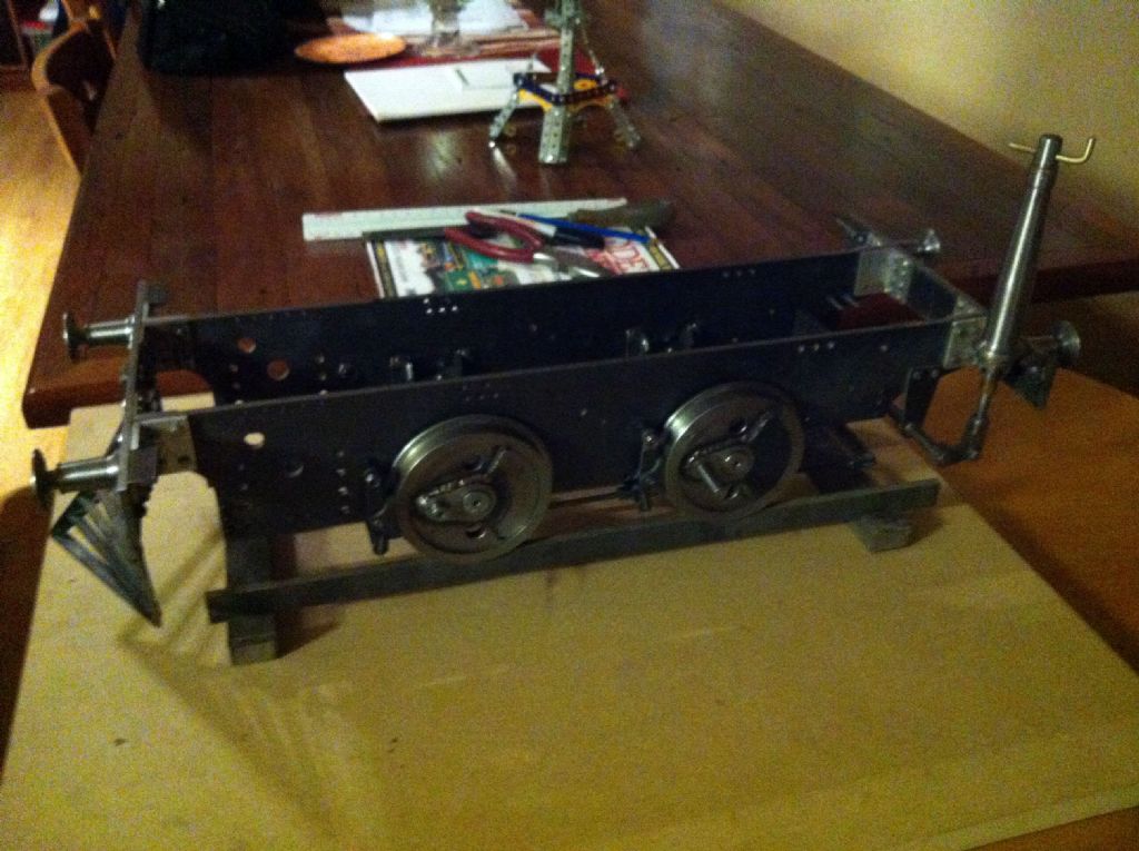

                                      HobbyNut
                                        @hobbynut
                                        I just uploaded some photos of my progress. I am attempting to keep up with the articles!. I know I will get behind, as I am fabricating/making from barstock. No castings will be used. I work as a programmer for a waterjet company, so parts are "easy" to get.frame assembly.jpg
                                        This is what I was going to do about the shortage.
                                        Edited By HobbyNut on 12/02/2013 00:57:04

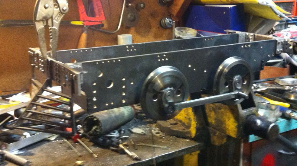

                                              #113415
                                              HobbyNut
                                                @hobbynut
                                                Still working along at the pace of about 12 hrs per week. Wondering when next installment is?
                                                I made my brake shoes from MS, waterjet cut naturally. I also cut some from .375" Q5 Brake material, that I may try at a later date.
                                                Should I be thinking of painting this frame soon?
