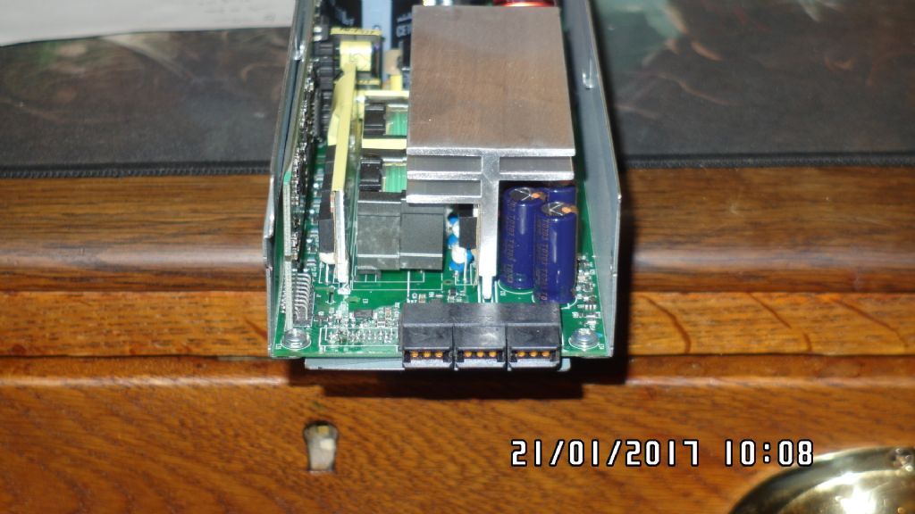

                          John C
                            @johnc47954
                            I followed up this tip from page 1 of this thread:
                            Posted by Bikepete on 16/01/2017 10:05:14:
                            – or this one with 12.1V, 69A, £8.54 inc postage! Often there are instructions on the web for hooking them up e.g. here.
                            and very quickly received said power supply. Modifying it was easy, although not quite as straightforward as the link. I used a junior hacksaw blade to saw through the plastic socket and then nibbled away at the plastic. I snipped off all the leads apart from 3 and 4 which I soldered together – I din't bother with a switch. I made plugs for the 12v out by milling down the pins of a standard 13 amp domestic plug.
                            Good one – thanks Bikepete!

                            #279243
                            Gordon W
                              @gordonw
                              I made connecting plugs from 2 pin plug and sockets as sold for mains electric lawnmowers and suchlike. You can make them polarised by cutting one pin short and putting the sawn off piece in the socket, you will have to work out how much to cut off depending on the make of coupler.
                              #279286
                              Bikepete
                                @bikepete
                                Glad it was of use John C. Have you tried using it to power a drill?
                                If you can find some cheap, Speakon connectors are good for high DC currents, if a bit bulky.
