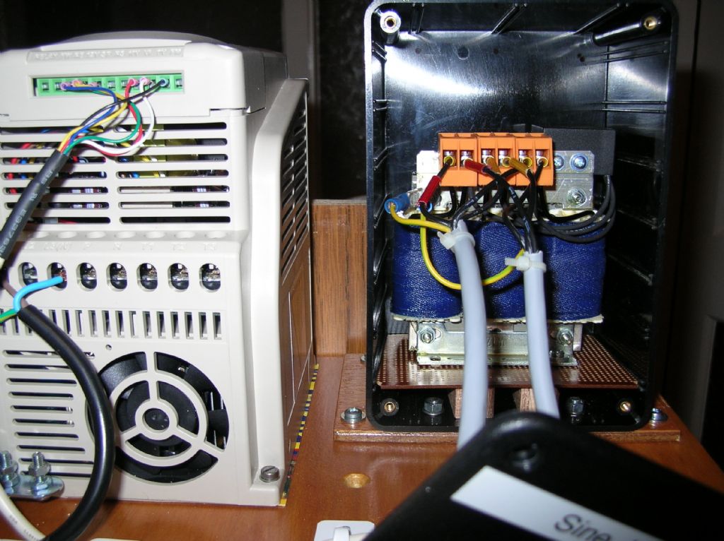

                              Equivalent problem. I had acquired a Pultra 1590 lathe and a Meddings Pacera drill. Both circa 1950. Both had damaged / missing parts. Both being sent for scrap. Motors are the original 3 Phase units and had not run for at least 40 years. The Pultra has the Mardrive unit and the Meddings a Brook motor. Taking advice I had both motors tested then bought a Drives Direct unit with a Sine Wave Filter (transformer). Avoiding winding insulation failure was given as the reason for the filter. Wanting to stay as original as possible my wallet suffered larger damage than I had hoped. Both motors run well after nearly 6 years: but a heart attack and advancing years has left me with limited progress.
                              Chris.

                                          Hello again Andrew Tinsley.
                                          Initial test set up. The black box is 180H x 120W x 65D (Maplin). Has tapered sides so the unit is sat on a Vero board with two tapered bits of wood under. The cables pass through holes in the front cover.
                                          Slide out of the box if required.
                                          The inverter shows the underside with the output cable not connected (T1 T2 T3 on the right).
                                          Now mounted vertically to show screen and the set up buttons to the front.
                                          The Filter notes just say : Sine Wave Filter. Input on U1 V1 W1 Output on U2 V2 W2.
                                          The invoice includes Sine wave Filter 3 Amp. All bought in 2015 and "just works".
                                          Not shown is the connected Control Pendant and the 3 phase socket. Accepts either the lathe or the drill.
                                          I admit that all else is a bit above my pay grade. Hope this is of some assistance.
                                          Chris.
