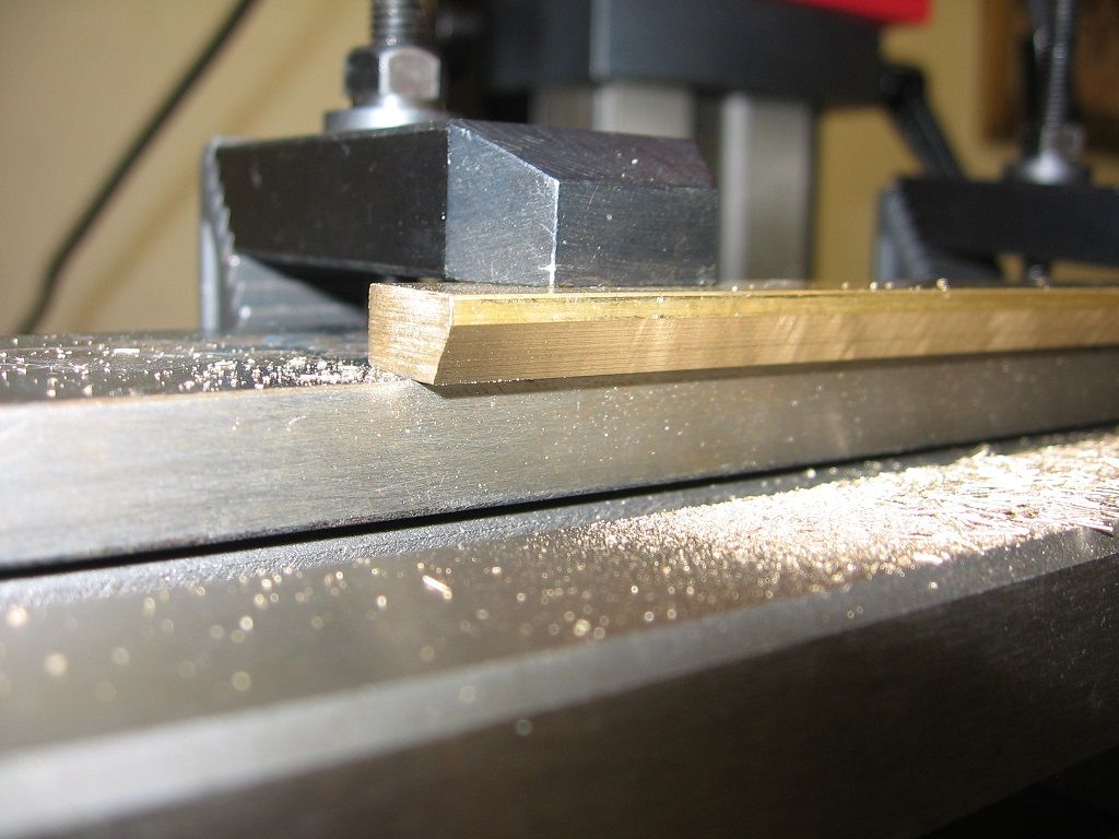

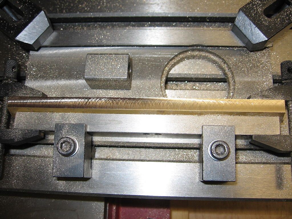

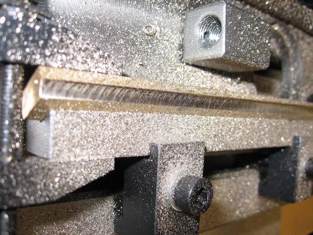

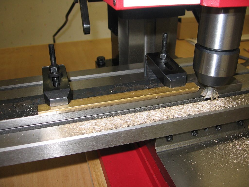

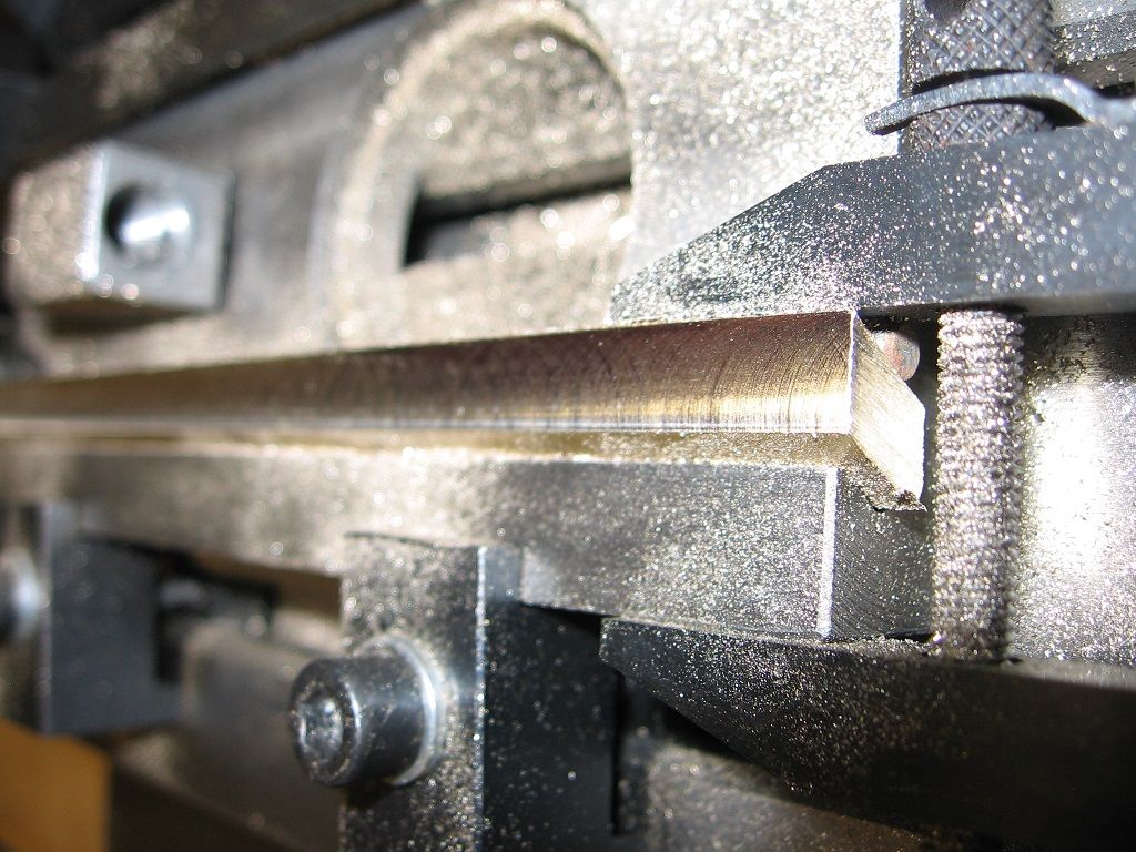

                #340858
                Martin Shaw 1
                  @martinshaw1
                  Following on from Thursday, I had to pop down south to see my Dad, at nearly 94 he is ageing quite rapidly. However here are pics of the set up, as you can see the swarf is, from Jason's description, about right so I think the tooth load is about right, but the close up shows the ridged paterrn in the cutting surface. Having had a couple of days to think about this I'm reasonably happy that it is a too high feed rate with a too slow rpm, but if anyone thinks otherwise I'm happy to be corrected.
                  Regards
                  Martin
                  #340862
                    If we are looking at the ridges across the work that can best be seen in the first photo at the left of the work then they look to be spaced at about the pitch of your lead screw. Could be caused by loose x gibs and as you wind the handle round there is a tendency to lift and then lower the table.
                    If it is the ridges that run along the work then that is down to the grinding of the tool.
                    I would also suggest a third clamp mid way along the work as it could be lifting a little. Your clamping method is also not ideal, if possible the studs should be as near to the point of clamping as possible and as far away from the stepped packers as possible to give the best mechanical advantage which may be letting the work flex slightly
                    #340866
                    Martin Shaw 1
                      @martinshaw1
                      Jason
                      Thanks for your thoughts, there is a bit of excess in the X gib but not for the full travel, so it 's probably part of the problem. Can't do much about the tool grinding however you have picked up the other major problem which is bad clamping practice. I have had a look and apart from the visibly obvious there is also a lift of the parallel at the rear because of it's location on the bed. Fortunately there is anough of an edge to realign when I have sorted a better arrangement. Thanks for yours and others help.
                      Regards
                      Martin
                      #340943
                      Robin
                        @robin
                        I am really worried about posting on these things because there is a huge risk of teaching Granny how to suck eggs and getting accused of all sorts of Smart Alecry. I've only been on here a few months and I didn't read the whole site, but In for a penny in for a pound, here we go…
                        I would guess machine and tool shank bending. We all know the difficulty in machining off that last thou. You advance .001" and make the cut, no difference. You repeat, nothing and then blammo, .004" undersize.
                        The tool puts up resistance to the cut, it would rather rub and bend everything than make the cut. Only when it can no longer resist the cutting pressure does it make the cut and then it takes everything available.
                        There has to be enough pressure to get your cutting edge under the surface. I have a notion that enough cutting teeth means one is always engaged and hold the tool against that surface when the next one arrives.
                        A scalloped surface may be indicative of a tool that is oscillating between rubbing and cutting. Everything bends while it builds up the cutting pressure and then blammo. To counter an oscillation you change feeds and speeds hoping to find a natural damping. You reduce overhangs wherever possible. You cut down hill to try and minimise the overshoot. If this were a production environment you might even consider unequal helix tooling.
                        #340945
                        Hopper
                          @hopper
                          Posted by Martin Shaw 1 on 10/02/2018 19:13:18:
                          Can't do much about the tool grinding…
                          YOu might be able to carefully dress each cutting edge with a slip stone, taking even amount off each edge.
                          I think some of these low-cost dovetail cutters are more suited to woodworking purposes than metal work.
                          Edited By Hopper on 11/02/2018 10:52:04

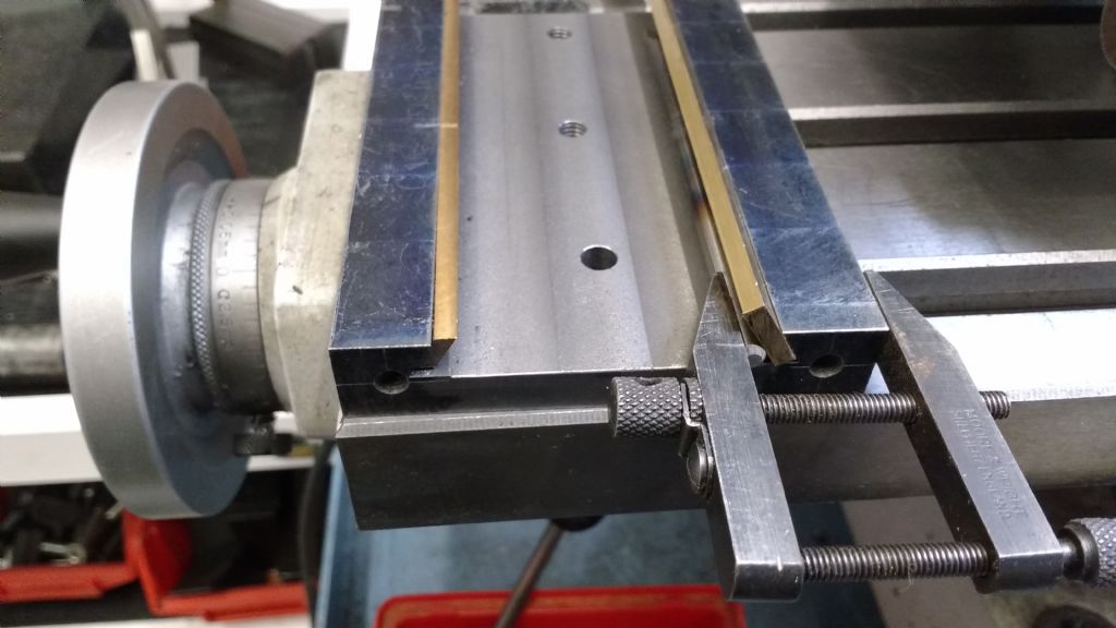

                            Just a thought, are you sure that the dovetail angle is 60? I ask because I made a brass jib for an X1 mill and the angle was 55! Necessary to use my method of clamping the material in the dovetail to get the same angle.
                            #340968
                            John Haine
                              @johnhaine32865
                              Here is a quick staged photo of how to hold a brass strip (1/8" in this case) in a dovetail so you can machine one of its edges to the dovetail angle.
                              On the left is the gib I made using the method. On the right I've clamped a length of silver steel into the dovetail angle using a toolmaker's clamp so that it clamps the gib material – in practice you would use 2 clamps, one at each end. Of course the slide itself would be clamped down to the mill table. To make the angle you just have to align the strip approximately parallel to the table X axis and machine off the square corner with an end mill. Then unclamp, turn the strip end for end and refit with the sharp corner you've just milled snug into the dovetail corner, with a mite of packing (~0.5mm?) underneath, and apply the clamps again. Mill down the second edge until very nearly flush with the top of the slide. You can smooth down the bearing face of the gib by draw filing.

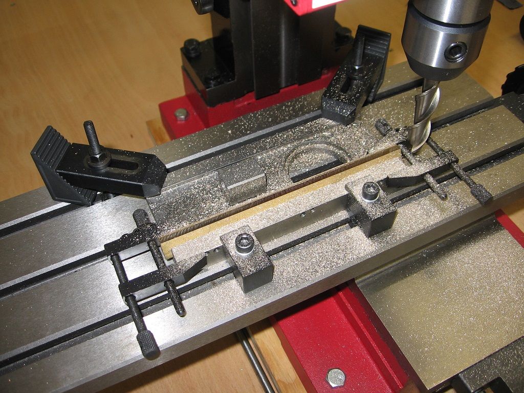

                                #341178
                                Martin Shaw 1
                                  @martinshaw1
                                  A number of folk have been exceptionally helpful, and as a thank you , I though I would post some pics of the Mk2 approach.
                                  The first shows the revised set up, thank you John Haine, which works well. The second and third pics are the result of a few passes of a 14mm end mill, it looks a bit rough because it was, certainly somewhat better than the last attempt, but the cutter was putting a lot of vibration into the exercise. I suddenly twigged that the cutter was blunt, I can't recall what I might have used it on, but blunt nonetheless. I was going to use a 16mm cutter, regrettably the brand new, never unwrapped R8 cutter holder wouldn't take a 16mm cutter shank, so it'll have to go back to the supplier for a new one. A new 12mm cutter of course cut properly. The fourth pic shows the final surface finish, which in high enlargement looks rough but in practice isn't. What you see is really the striations of the cutter tips, which polish out on a bit of wet and dry. The cutting was done at 1200rpm, it felt right even if 1500rpm is a better speed, and the feed rate was a bit lower, either way it's all worked out quite well, so my grateful thanks to everyone who has contributed their thoughts, it's appreciated.
                                  Regards
