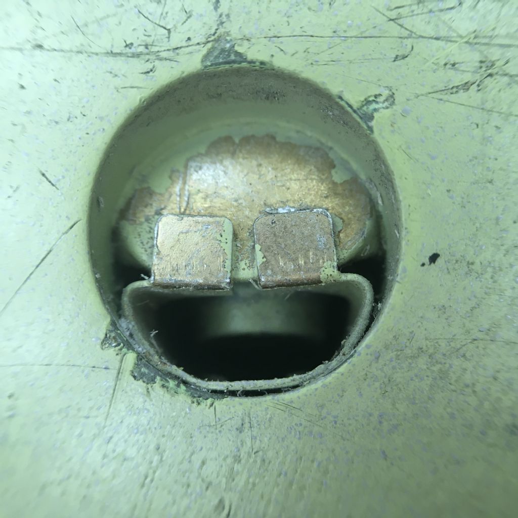

      Given the paint-job … I am almost sure that this lump came from an aircraft fitter.
      It has a half-inch diameter hole, with this natty little insert carrying a captive nut.
      … I scraped some paint off, in the hope of finding an identifying mark, but there is none.
      Simple questions:
      1. is it a standard part, and does it have a name ?
      2. does it, as I suspect, just push into the hole, to be retained by spring pressure ?
      Grateful for a simple answer … but if none is forthcoming, I will probably remove some more paint and try pulling !!

          He's never seen anything like it, but wondered if it might have originated in a wooden framed plane, such as a Mosquito or Wellington.
          What's the larger item which houses it?
          Bill
          #628377
            Just a lump of metal, Bill … no longer identifiable,
            I am led to believe it’s an off-cut from a bucking block.

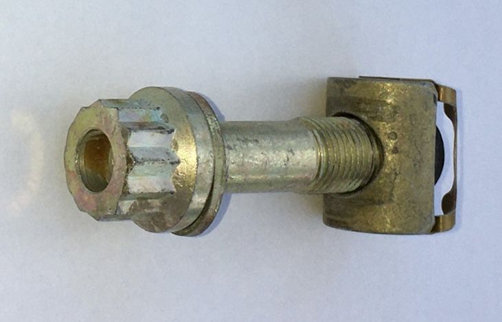

              It’s a barrel nut. This picture is an aircraft nut & bolt that used to help hold the wings on a PC-12 aeroplane, for example.
              Edit: I have just retrieved it from the windowsill where it lives.  The thin metal part holds the nut in the bore when the bolt is not inserted.
              Edited By DrDave on 09/01/2023 22:17:22
              #628393
                Thanks DrDave … that looks spot-on
                I just didn’t know the name.
                Looks like my assumption that it would just slide out is O.K.

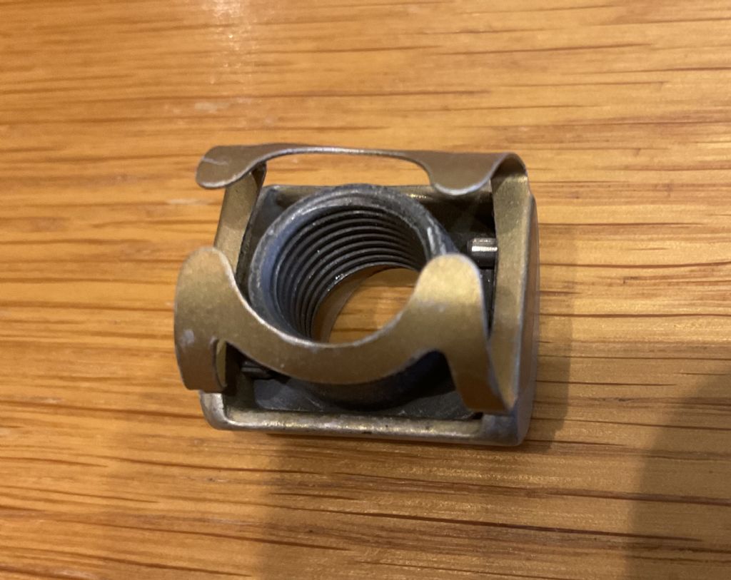

                              I took a close-up of the working side of the nut to show its features. The dark grey nut can float slightly on the barrel section to allow for mis-alignment of the bolt. A pair of roll pins retain the nut (you can see one in the upper right of the nut). You can see why they cost an arm & a leg.

                                    Slightly different design and a lot bigger than the ones I'm used to. No room for pins on the smaller ones but installation forces are probaly a lot lower.

                                        If I may correct you, Lee, this is a tension bolt. If the shank is loaded in shear, something has gone wrong with the design! When installed, the bolt is torque tightened to a specified value, normally high enough to prevent the joint gapping under the maximum expected tension loading. The barrel nut has to carry the full tensile load in the bolt. The barrel nuts would be used in places where it is difficult to install an ordinary nut, for example.
                                        For reference, on aircraft at least, a shear bolt would be installed in an interference fit hole and the nut screwed on.

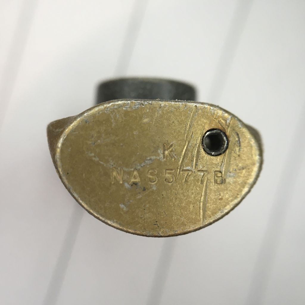

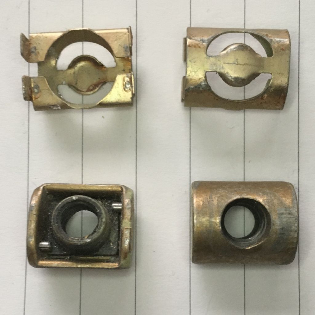

                                            I am pleased to confirm that:
                                            1. Both of my barrel-nuts slid nicely out of the 1/2” hole, with only light tapping applied
                                            2. The plain hole is actually more useful to me
                                            3. The design of the barrel-nuts is similar, but not identical to that shown by Dr Dave
                                            4. One of them carries a part number
                                            5. The line-spacing on that paper is 3/8”
                                            Thanks everyone … mission accomplished

                                              Everything aircraft usually carries a number. Thin plain washers being an exception. It can be the part number, but more usually it is the production or batch number. Each item being recorded in the build log of the particular item. Be that a fuel system, undercarriage, propeller, etc.
