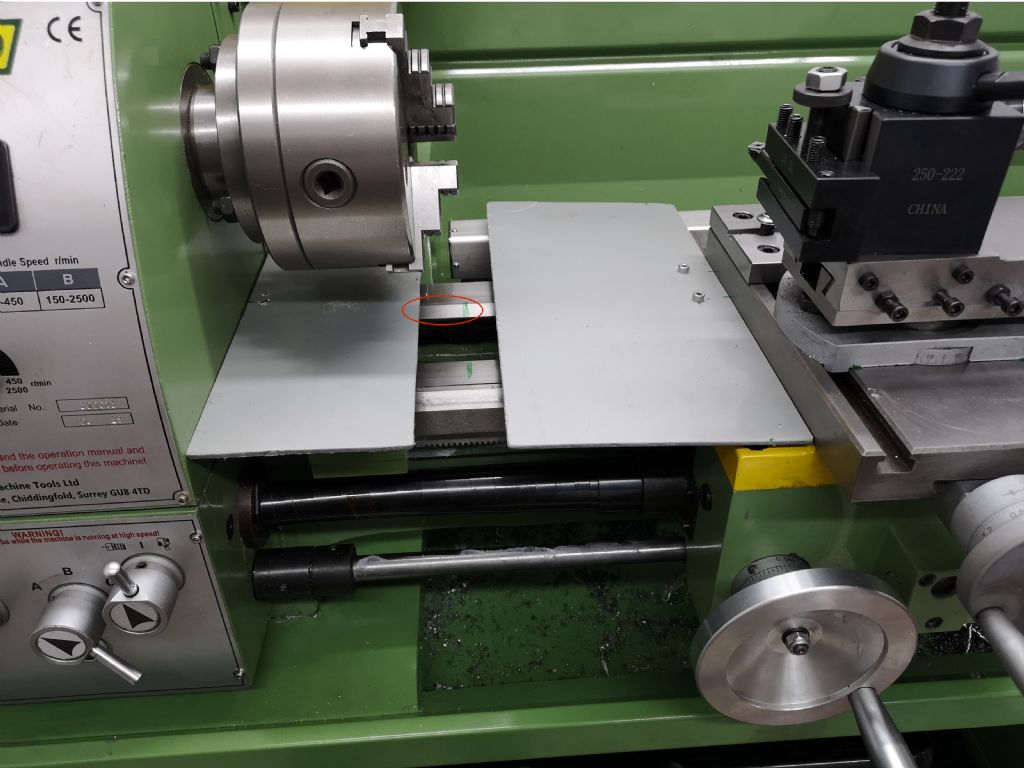

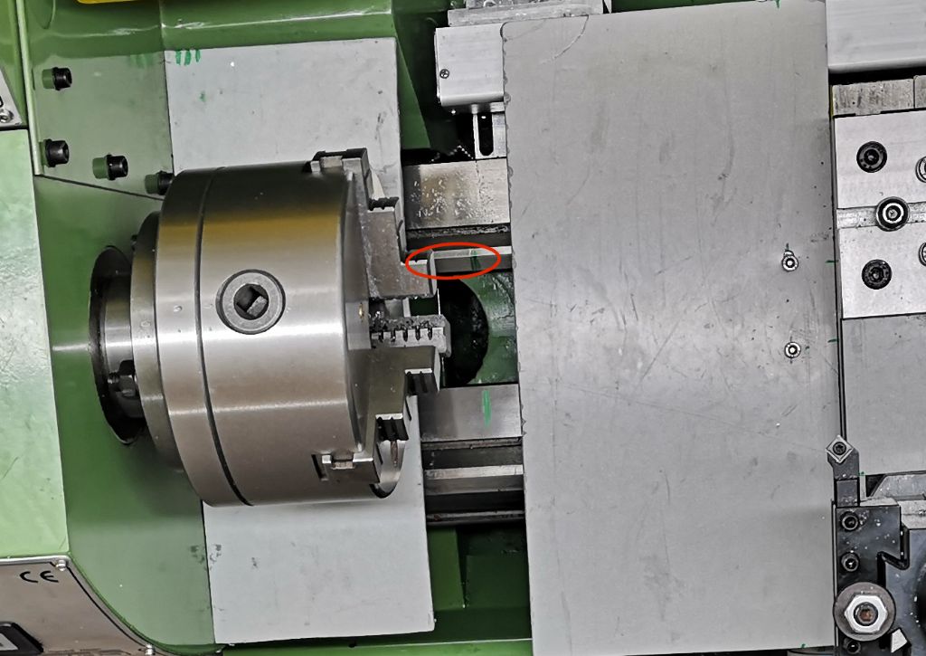

      I'm just about getting used to my Warco WM290V lathe after buying into the game in November, very late in life. One of the things I had in mind was re-facing the discs from the family's cars and my van which only seem to last a year these days. However the biggest of these discs is up to 10mm bigger in diameter than the lathe swing will accept.
      Therefore, my question is, can I cut the bed to give me the room I need or not? The red outlines on the photos show the only chunk I'd need to remove, a few inches of the inverted V section. The green lines on the ways show the limit of apron travel.
      I'm also curious as to why the chuck/spindle is centred the way it is, neither over the flat ways or the inverted vees?

        Is this a good idea or not?

        Simon Williams 3
          @simonwilliams3
          Hello Terry, good afternoon.
          It's your lathe — but…..
          I'm in the no don't do it camp, though not because I wouldn't buy a lathe which had been modified so drastically. I might look at it and marvel at the bravery, but I suspect the resale value of said machine has just plummeted. I'm also not too bothered by the argument that you will have affected (detrimentally, but how much I know not) the stiffness of the machine.
          I'm anti because I don't think you're going to be able to resurface a disc even after chopping a bit out of the lathe bed. Firstly I don't rate your chances of mounting the disc in a three jaw chuck (run out and grippability) but I don't think you'll get a surface finish worthy of the name. It's a big flat disc and the tool surface speed at the outer periphery is going to be off the scale and chattering (screaming) like fun. As I understand it a 290 is inverter drive, you need low speed torque for this job, not speed.
          The finish on the disc would be much better ground, and frankly I think you'll get better results with a linishing disc on a hand held angle grinder!
          And how certain are we that there is enough meat on a modern brake disc to allow for a re-surface anyway? What's the thickness lower limit?
          There, that's put the kibosh on it! Sorry!

            Posted by Terry Kirkup on 24/04/2019 13:09:45:
            As the carrage sits on the front vee and the rear flat the cutting loads are not going to be over a pair of either. I think you will find the spindle is centered over the whole be give or take a few mm.
            Regarding the other questing I'd be looking into why your discs wear so fast unless you are doing many miles or the car is sitting with them rusting away.
            You will also find that the two legs of the carrage stop you getting near the disc so tool overhang will be a lot, I have found this when turning 10" flywheels which will hit the yellow bits.

              You will lose the rigidity of the bed which is probably not that stiff already. The new cheaper lathes are built a lot lighter than the older ones and can twist when under load.

                I think it would be crazy to do that to a new lathe to save a few quid on new discs. As Simon says if there is a lip on the discs and enough thickness left take it off with an angle grinder with a flap wheel.

                  The centre height is given as 150mm. If that is from the ways to centre line, then the lathe should actually swing very slightly more than double, due to the ways being separated? A tool post grinder would finish off the surfacing better than a cutting tool, I think?
                  I would not be carving up my lathe like that. Even though it is 50 years old! If surface hardened, the bed could easily warp, let alone the risk of reduced bed stiffness.
                  New discs, unless ventilated, are dirt cheap anyway – unless you are buying from a dealership (when they will likely double the price just for supplying them). Hardly worth the bother, what with time, etc taken into account.

                    +1 on not cutting a gap into the new lathe. You will compromise its' rigidity.
                    To reface car disks years ago a friend made an adapter mandrel for the back end of the spindle, and an auxiliary toolholder at the back end of the headstock on his Standard Modern lathe for cutting large ID parts. This setup came in handy for car disks but also for large flywheels. The only thing was, the spindle speed could not be slowed down enough for cutting larger dia items. Sometimes chatter would start when cutting close to the 10 or 11" OD's of the disks and flywheels. It was not easy to slow the drive down mechanically on that lathe and a VFD was out of the question for cost reasons.
                    Back to the car disks – You are aware that many newer cars have disks that can not be refaced? And that these disks are much less expensive on some cars that they used to be? If you are working on stuff for old cars, fine, but if you are doing newer car repairs I would not bother setting up to reface disks.

                      Wow! Thank you all Gentlemen, I think we have a winner. I half expected a negative reaction and I'll forget all about the idea now under such a deluge
                      The disc thing is of course incidental, not the main reason for buying the lathe but just an add-on idea, and Simon, I did get a four jaw chuck with the machine so would have been using that if you'd all said "yes". I will now dispose of (or cut up and utilise) the old discs I have laying around, some vented, others solid.

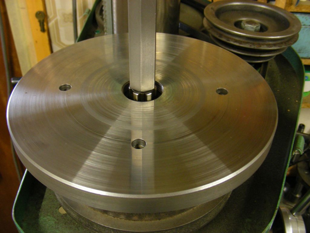

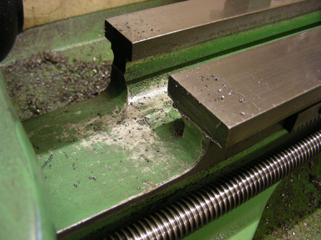

                                    Before getting a larger lathe I made and fitted a 9" flywheel to the quill of my mill/drill. This was made from black MS but the idea came from someone who had used a brake disc for the purpose. Mine was faced on the Super Seven by bolting to the faceplate. The finish is adequate but far from perfect:
                                    Another job in the Myford just fouled the ends of the shears and I confess I trimmed them to clear it:
                                    This is not to suggest that I would encourage the OP's suggestion!

                                                      Well, it's Terry's lathe and he can do what he likes with it!
                                                      Bodge maybe, but it's an inexpensive modern machine unlikely to become a collectors item. It's just a tool.
                                                      Cutting off the section of prism Terry highlighted is unlikely to effect the rigidity of the bed much; I think on the 290 the rear V stops at the headstock anyway. The rear prism has no function at that point – the tailstock can't get anywhere near the proposed gap unless the saddle's been removed.
                                                      Jason mentioned the problem that would put me off most which is the difficulty of getting tools close to a large disc on these machines. On these machines the saddle design makes it awkward to approach an unusually large diameter object without overhanging the tool risking chatter and poor finish.
                                                      Why Terry's brake discs have such short lives only he can answer. Moving heavy loads in hilly terrain near salt water would do maximum damage. Friend of mine traced his problem to being a keen musician performing 2 or 3 times a week. With the band's heavy kit packed into his car his late night drive home included a long empty ring-road where he would hammer up to several roundabouts at 70mph (possibly faster, ahem) and then slam the brakes on just in case. His discs lasted a lot longer when he took to driving less enthusiastically!
