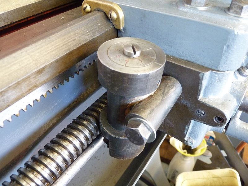

            Hello Peter,
            This is the dial fitted to mine:
            I don't think it's an original part though as it looks homemade. I've had a look at the manual and there is no mention of a screw cutting dial so possibly the lathes didn't have one when originally built. I would expect one fitted at the factory would have had a cast body.
            It looks pretty easy to make one. Couple of bits of bar soldered or welded together, with a spindle, dial, and gear wheel.
            Just had another look at the manual and there should be a leadscrew guard that bolts onto the end of the apron where mine has the dial. That was obviously taken off and lost when the dial was fitted.
            Edited By John Baguley on 25/02/2016 12:14:42
            Edited By John Baguley on 25/02/2016 12:23:41

                  #226888
                  John Baguley
                    @johnbaguley78655
                    Hello Peter,
                    Yes, it's got 8 divisions. You might be able to get a suitable gear ready made or perhaps adapt a complete unit from a lathe with the same size leadscrew (4tpi) if there is one.
                    Will send you a pm with regard to the manual.

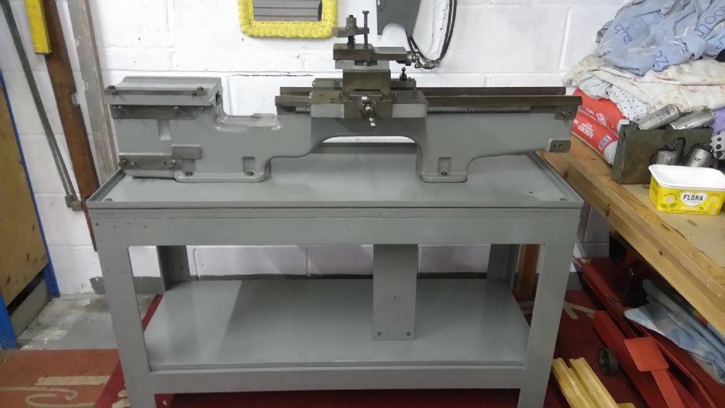

                      Hello guys i am new on the forum as i have aquired a denham junior MK2 (keighley lifts) lathe and i`m currently in the process of cleaning it up and getting it ready to run.
                      It has a 1hp single phase motor and all the capacitors are blown so a new motor will be required. Do you think a replacement 1HP motor will be ok as i doubt if the motor that is on it is original even though its very old.
                      Also is there any chance of a copy of a manual if someone has one.
                      Many thanks
                      Paul

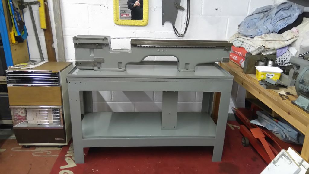

                              #277427
                              Paul Langford
                                @paullangford24032
                                here`s a before
                                Edited By Paul Langford on 12/01/2017 23:04:18
                                #277428
                                Paul Langford
                                  @paullangford24032
                                  Here`s WIP

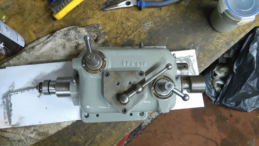

                                  #278308
                                  Paul Langford
                                    @paullangford24032
                                    Bit more progress today and well pleased with how its going
                                    #278322
                                    Ady1
                                      @ady1
                                      Well done you.
                                      Took me around 2 years to get my Drummond sorted and to really understand it
                                      #278403

                                        Posted by Paul Langford on 12/01/2017 23:04:46:
                                        Here`s WIP
                                        Were that my shop the first thing to go would be that bottled gas heater. I wouldn't want to undo all that good work with corrosion from condensation having made a good job of cleaning up that fine lathe.

                                          #278429
                                          Emgee
                                            @emgee
                                            Great job being done there Paul, is the vertical member supporting a central lengthwise support ?
                                            Emgee
                                            #278476
                                            Paul Langford
                                              @paullangford24032
                                              Cheers for the comments guy`s
                                              The main table frame is large angle steel and there is a plywood top and bottom shelf. Then there is a steel drip tray fixed to the top which the lathe bed is mounted to. The vertical support i believe was for a drainage container to be fixed to as there is a drain point in the bottom right hand corner.
                                              Overall its very solid and weighs an absolute ton.

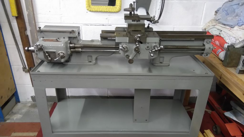

                                              #278638
                                              Paul Langford
                                                @paullangford24032
                                                Bit more assembly today and coming on nicely

                                                Brian Oldford
                                                  @brianoldford70365
                                                  Nice work. Has the LPG heater gone?
                                                  Edited By Brian Oldford on 18/01/2017 19:19:51

                                                    peter briggs 1
                                                      @peterbriggs1
                                                      Hello Paul
                                                      i have one of these in daily use, did you get a manual? i can email one to you if you pm me i got it from john Baguley on here he has one of these also.
                                                      mine doesn`t look as pretty as yours though
                                                      my denham has no reverse gears for the saddle and i dont know what they are like so i can make them, did you by chance take any pics of the inside of the lead/machine screw box before refitting it? it would be extremely helpful.
                                                      Regards
                                                      Peter
