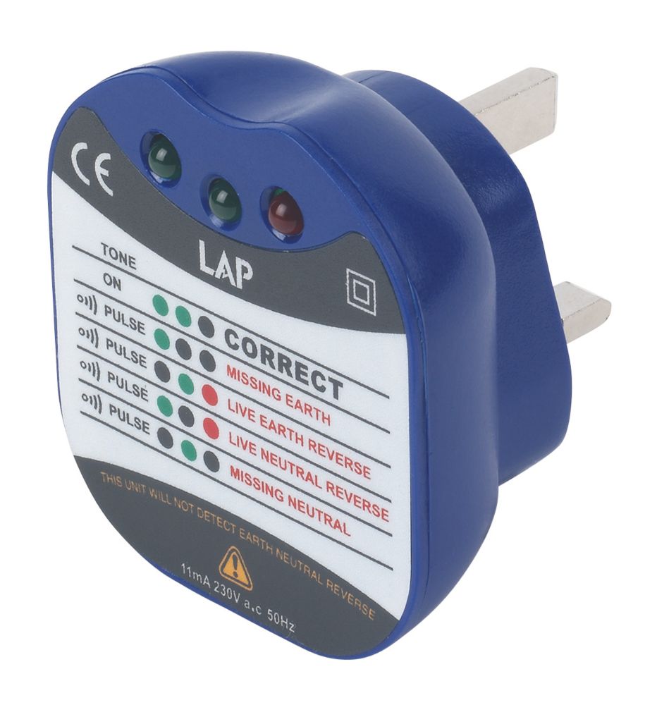

                                  Posted by fizzy on 24/08/2019 23:24:16:
                                  … I dont think there is a workshop wiring fault as it is installed to Iee regs.
                                  May have been OK when installed but there's always the possibility of wear and tear later. I've had the neutral connection inside a well-used wall socket lose enough spring to spark due to a fatigue crack.
                                  A socket tester would confirm all is well with the workshop wiring, this example is £7.99 from Screwfix.
                                  Though I trust nothing I agree faulty workshop wiring is unlikely. A more likely cause is damage to the CNC machine's power lead, perhaps the earth connection in the plug has been strained or the wire pulled off inside the machine. Or a manufacturing problem left the earth disconnected.
                                  Easy enough to test with a multimeter as Joe described. There should be close to zero ohms resistance between the plug's earth pin and all the CNC machine's exposed metal work.
                                  Most likely the cause is simple.
