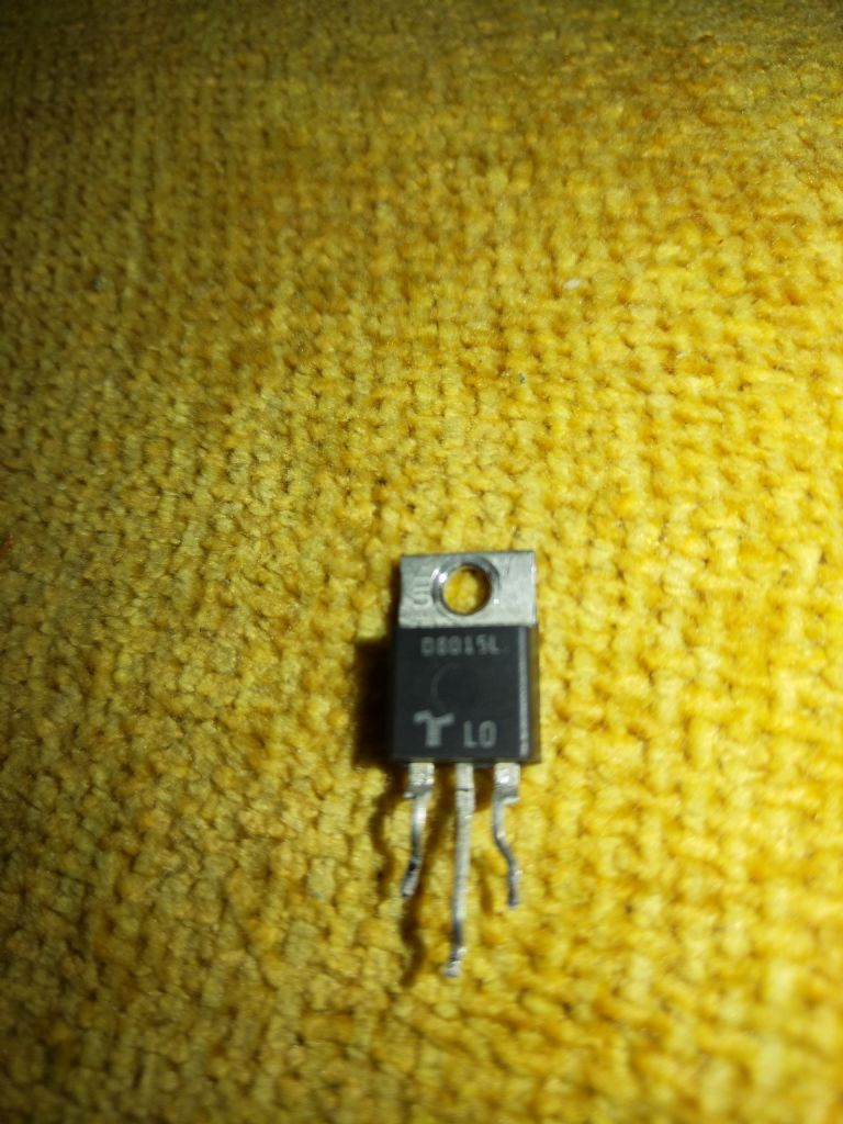

                                    Hi again,
                                    I have 5 of these diodes on the board which I have de soldered, if I set my multimeter to 200k ohms 3 of the go to zero, but 2 of them stay on 1 on the meter, can anyone tell me if any or all are faulty please,
                                    #596674

                                          Only after that would I look deeper, and the device Steve has removed is a suspect. As I don't know the board in question, to be sure of what the 3-legged beastie is, I would have to look on the web for a data sheet matching its part number. Could a bipolar transistor, FET, SCR, or a Triac; it matters – how they measure on a multimeter varies.
