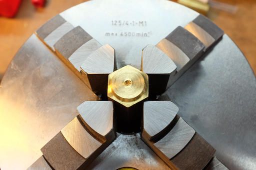

                                              Hmmm – my 4-jaw SC holds hex just fine.
                                              It depends on what you are machining, isn't it? (if you have more than 1 chuck, that is).
                                              For the last few years, collets and 3-jaw SC, and the odd bit with the 4-jaw SC;I do expect some faceplate work and lots of 4-jaw independent work coming up with some cylinder work from castings.

                                                What I mean is it wont actually contact all 4 jaws on the faces of the hexagon. Only a 3 or 6 jaw can do that.

                                                    Posted by Michael-w on 03/03/2018 12:36:03:
                                                    Posted by John Alexander Stewart on 03/03/2018 12:32:52:
                                                    John.
                                                    Michael W
                                                    You might find this previous thread interesting, Michael: **LINK**
                                                    http://www.model-engineer.co.uk/forums/postings.asp?p=3&th=102279
                                                    … Try the last few posts on the linked page.

                                                      Michael W and others – it is not intuitive, but works very well.
                                                      We had this discussion at our club a few years ago, and it came up again recently.
                                                      Here should be a staged picture I did for our club discussion:
                                                      It does work, and there's no issue with the jaws impinging on the sides of the hex.
                                                      I'm always trying to learn new things, while trying not to forget things already learnt. Not sure if someone showed me this in my distant past, or that I just had the 4-jaw SC on, and needed to do a quick bit of turning of some hex and lazyness got in the way and…
