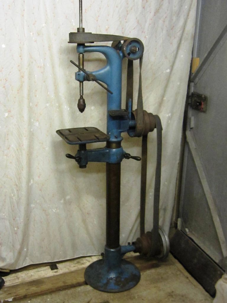

      This drill has a brass plate marked: " C.H. Joyce, Engineers Tools, London S.E." – I think that may be the name of the distributor rather than the manufacturer. I plan to buy new belts for it and get it working, driven by an electric motor, I am puzzled by the belt tensioning arrangement. It looks like if the top belt is tightened the bottom belt will go slack. Please can anyone give an explanation?

        #284361
          If it moves the pulley sideways it will tighten both belts?
          #284371
          Brian Wood
            @brianwood45127
            Hello Richard,
            ​Surely the top set of jockey pulleys are mounted on a short stalk that goes into the angled housing, moving that outward would tension the top belt.
            ​Unless the very lowest mounting near the floor can rise and fall on the column, or has a build in eccentric shaft mounting, then tensioning that belt must be by shortening the belt and refitting the serrated belt clips again, a rather tedious and hit and miss way of going about it.
            ​The mid point mounting is I think fixed, so everything is relative to that position.
            ​Regards Brian

              #284498
              Richard Hughes 3
                @richardhughes3
                Thanks for your replies.
                Neil, None of the pulleys can move sideways.
                Brian, The stalk that holds the top pulleys is part of the casting so cannot move. The only adjustment I have found is the lever that can be operated to slacken the mounting of the central pulley shaft and allow it to be moved up or down, tending to tighten one belt and loosen the other. When this lever is in the "loose" position the pulley shaft droops slightly, slackening the lower belt, which could be useful for changing speeds. The bottom shaft is fixed: it cannot be moved up or down and does not have an eccentric mounting.
                Bill, There is a square headed bolt in the base of the upper section. I have tried loosening it but could not move the upper section or rotate it. I suppose it could be rusted in place.

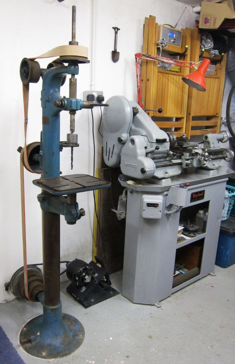

                #295086
                Richard Hughes 3
                  @richardhughes3
                  Well, I got it to work. I made the new flat belts as short as I dared and mounted the motor on a hinged platform so that the v-belt can be tensioned and swapped between pulleys. For the flat belts the required length is indeed the same over all three speeds and it is possible to get enough slack to change speed by loosening the central shaft using the lever. It is possible to obtain the following speeds: 146, 211, 292, 422, 583 & 843 rpm. Not exactly in line with modern notions of HSE but it runs with an impressive whirring and clanking sound.

                        #295127
                        peak4
                          @peak4
                          On the H&S aspect, the majority of the pulleys wouldn't concern me personally, but unless you're folically challenged, I'd be tempted to arrange a basic curved sheet metal guard for the front of the top pulley.
                          It might just save getting scalped.
                          #295132
                          Hopper
                            @hopper
                            Lovely old machine and a joy to have in the shed, even if it takes a bit of tinkering.
                            What is that long pinch-bolt sticking out the side of the base just above floor level? Is that some kind of adjustment to move the whole pillar up and down, thus tensioning the bottom belt?
                            Motorbikes of the same era were similarly fiddly to adjust the chains. To adjust the primary (engine to gearbox) chain you moved the gearbox back in the frame. Which of course meant you had to then move the back wheel back to adjust the slack out of the back chain. They had more time to fiddle about with things in those days as the internet had not been invented.

                                #295237
                                Roderick Jenkins
                                  @roderickjenkins93242
                                  Posted by Hopper on 27/04/2017
                                  What is that long pinch-bolt sticking out the side of the base just above floor level? Is that some kind of adjustment to move the whole pillar up and down, thus tensioning the bottom chain.
                                  My guess is that there could have been a foot operated pedal to engage the drive from line shafting, perhaps via a fast and loose pulley system
                                  Rod

                                    #295283
                                    Richard Hughes 3
                                      @richardhughes3
                                      Thanks for your replies and the interesting discussion. I got the drill as part of the deal when I bought a very old Barnes No.5 lathe and I thought it would be interesting to get it working. I also have a fairly modern drill press but I like old machinery too and I enjoy turning what may appear to be junk into something useful.
                                      The bolt in the base has a spring washer and it does seem plausible that it was the pivot for something which is now missing.
