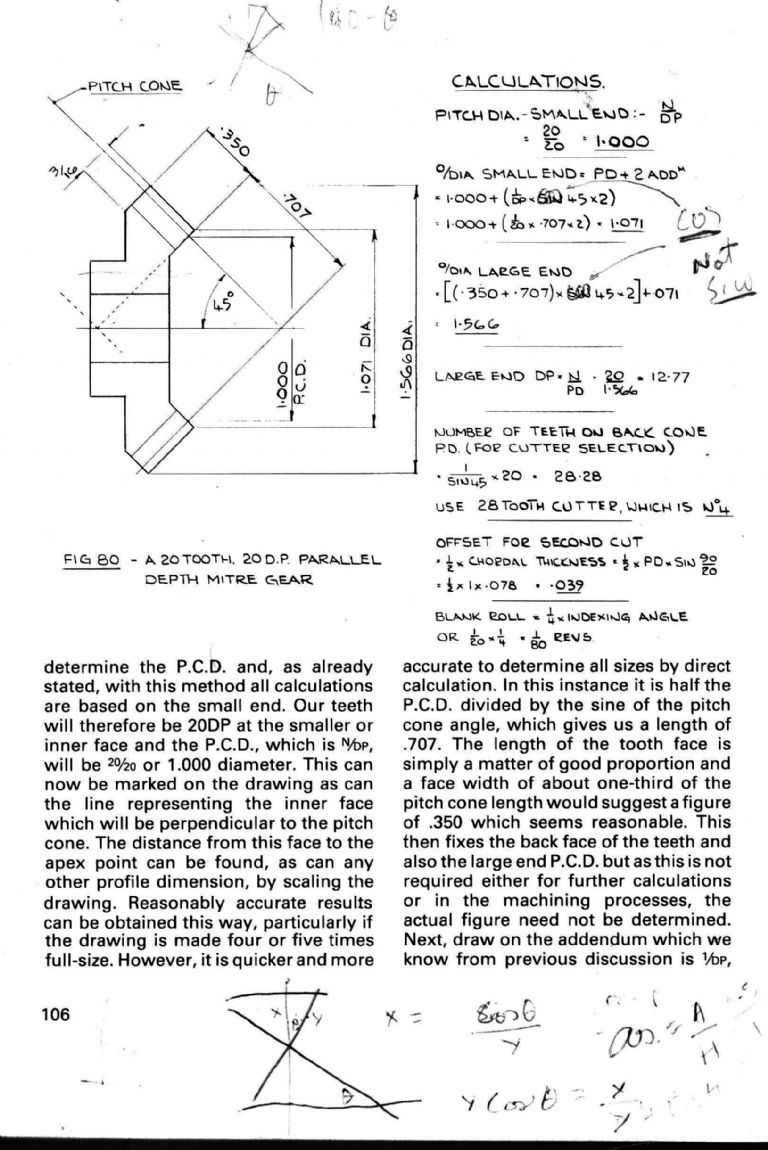

      I am also looking for the way to calculate correct dimensions for making bevel gears and bevel pinions. I cannot find where to purchase " the Climax Book", or the one by Dave Lammas. Can anyone help, or come up with another solution.
      Many thanks,

            "Gears and Gear Cutting" by Ivan Law descrbes the method for cutting parallel depth bevel gears.

              I have this book but there seems to be a fault with the formula, as I can't get it equate properly.

                        Ivan's book has a minor error (SIN and COS swapped over in one formula) that affects the results if you are making an inequal pair of bevels.
                        I try and look out my corrected copy later.

                          I have a spreadsheet  for designing parallel depth gears with the sin / cos error fixed.  I built this a few years back to make some gears for my Stuart Victoria.
                          The calculations are primarily from the Ivan Laws book,  but then I have another book by Franklin Jones,  which I used to tweak a couple of parameters.
                          This should work for you:
                          https://www.dropbox.com/s/gkb3w2lfmlig8oa/Gears_Final_180410.xls?dl=0
                          You do not need to register for dropbox or need a login to access.   The worksheet is previewed,  but there is a "download" button in the top right hand corner of the screen.

                                In Ivan's book, page 106, the formula for O/DIA SMALL END change sin to cos. For the large end change cos to sin. It should then work.

                                  In my 1988 edition of Ivan Law's book, both formulae on page 106 use sin, neither using cos. Should both change from sin to cos or just the one for the small end?

                                    … My 2002 edition [reprinted 2006] also shows Sin in both formulæ

                                      If the gear angle remains at 45 degrees for the bevel gear in question, as the example shown on page 106, then cos 45 and sin 45 have identical values of 0.707 [ square root of 2 divided by 2] and the actual term used doesn't matter
                                      I will look and see what my other reference books suggest and report back on bevels having other angles.where the trig function chosen has more influence. It is not difficult to change though since sin x= 1/cos x and vice versa and the values can only vary between 0 and 1.

                                              Ok, as far as I know SIN has to be changed to COS in the two upper formulas, not the lower one. This is a scan of the page from my copy with my scribbles on it.
                                              As Rod pointed out, I have produced 2:1 gears using them and the results are shown below.

                                                    Sorry, it's the old eyesight failing. My copy of the book has exactly the same scribbles as Neils. Both formulae should use cos.
                                                    Russell.
