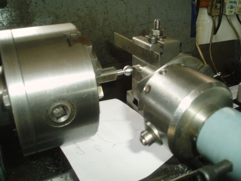

                I also made a Bedair type tool here is a pic of it in action actually being used for a concave cut rather than convex, not sure if the up and over do both ways? My cross slide is long enough to leave the top slide in place.
                You do need to have a fair amount of work sticking out of teh chuck with this type the up and over can be used a bit closer.
                The Bedair design is easily found on teh net and adapted to suit your own lathe.
                J

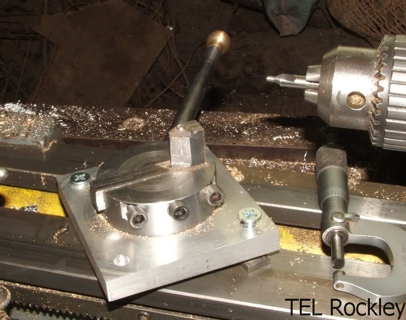

                            Over the years I have tried several different designs, but the Steve Bedair design is by far the best IMHO. Here's my version for the Myford
                            Edited By Tel on 17/05/2012 00:15:02

                                David, see the photo of my Bedair type cutting concave that I posted above, no mod required for small concave but I built it with a double ended holder so it will do large 2" rad concave if needed.
                                J

                                              Hi Tel,
                                              Did you make you ball turning attachment with a plain slot (As in the original design.) or did you use a dovetail slot ? I am thinking of making one and was wondering if it was wort going to the trouble of making a dovetail slot.
                                              Les.

                                                  David, width seems fine to me  no probs with Ads.
                                                  Les My Bedair just has a parallel slot and it seems solid enough.
                                                  J

                                                    Les Jones 1
                                                      @lesjones1
                                                      Hi Jason,
                                                      Thanks for letting me know there are no problems using the parallel slot. I will saveme the cost of a dovetail cutter.
