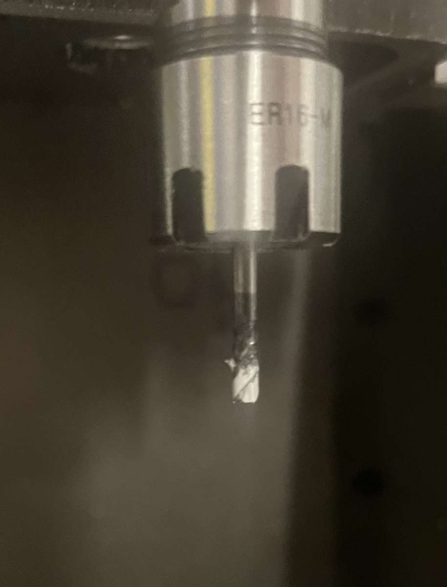

      First part.
      just a pocket and a boss.
      As I have a fair amount of Scrapbinium thought I would try that.

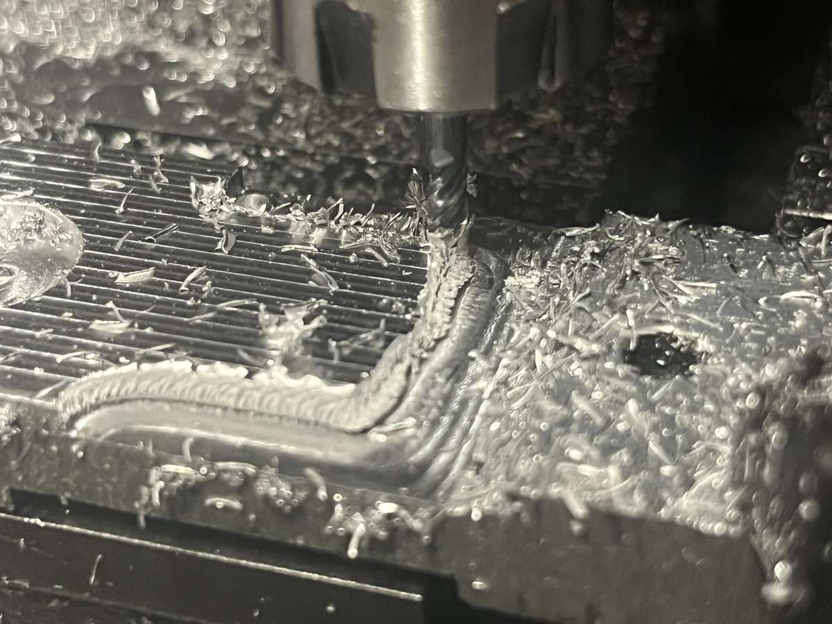

      Yuck.  I’ve not got coolant sorted yet,  and that might make some difference, but chip sticking nightmare.
      IMG_6525IMG_6529
      3mm carbide, coated with probably the wrong thing but all my small mills are. 20k rpm, 1200mm/min feed – fusion seems conservative there, although it did try to do 100% step over a lot.
      Managed to catch it as it clogged with the pause button and clear the chips then resume, so got a part out without snapping anything (unusual for me 😉 )

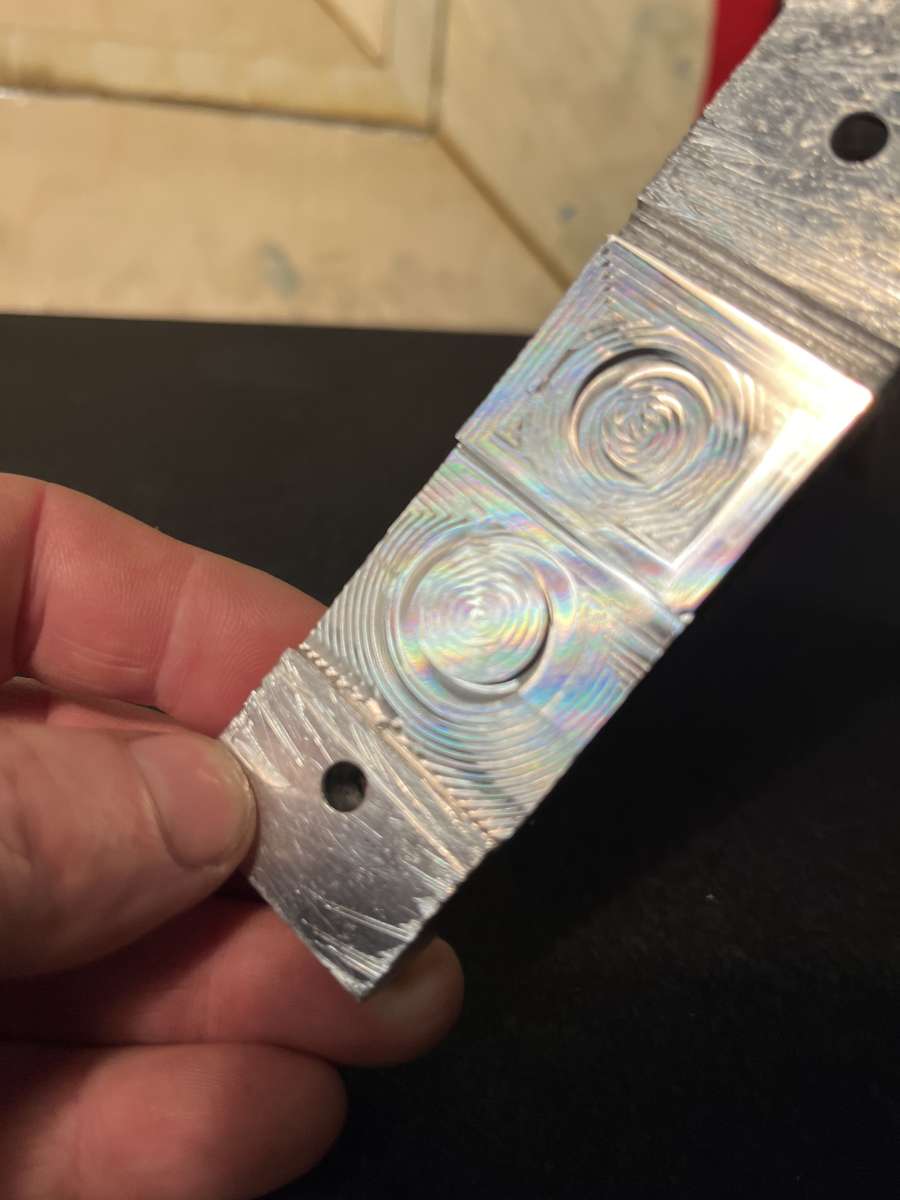

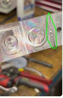

      IMG_6537IMG_6532
      Surface finish is smooth, need to check dimensions and I think the tram/nod (it’s literally bolted together and I’ve not verified square yet)
      Lots of learning in the tool path generation to do, but the basic machine seems sound 🙂

            I think the main issue was chip recutting/not clearing, and the coated endmill…
            I applied wd40, but it’s a spray bottle and so not that good at clearing.

                We’ve all been there and clogged cutters and drills!
                Most aluminium alloys machine reasonably well. I have mostly used 6082 and that machines fairly cleanly with a few caveats such as using lubrication/coolant. A few comments:
                • Don’t use stuff from the scrap bin, it is unknown and might well be unsuitable for machining.
                • Use the largest cutter possible given the tool path; it could be bigger than 3mm looking at the part?
                • Use a cutter intended for aluminium, they have larger flutes, are polished and are not coated. Some coatings, such as TiAlN, encourage aluminium to stick to it.
                • Ignore feeds and speeds from Fusion, it’s a CAD software package. Go with cutter manufacturer charts as a starting point. For the 3mm cutter you are running too high an rpm with too slow a feed. Speeds and feeds vary according to the type of cut so adjust them as needed. Manufacturers data usually specify cutting data for a range of cut types, eg, deep but shallow width or full width slotting.
                • Climb milling helps and, without coolant, gives a much better finish.
                • For manual milling of aluminium I use the odd squirt of WD40, for CNC milling I use flood coolant, as well a preventing sticking it washes the swarf away.
                Hope that helps.

                  I’ve had this happen a couple of times. I put some of it down to the wrong type of cutter (coating), but maybe I was feeding too fast as well. At least you can reclaim the cutter by putting it in caustic soda.
                  #788510
                    I think Julie has covered most things.
                    Aluminium is the only thing I cut with some fluid, small jobs just brushed on paraffin, and for larger I add the liquid to the air as I don’t want to stand there for a couple of hours brushing it on.
                    All use air to keep the chips out the way.
                    Uncoated ali specific cutters and climb cutting for me.
                    You don’t give cut details but generally if using the full width then the feeds need to be quite a bit less than if using just the edge particularly as the cutters get small.
                    Not sure what you looked at on F360 but a 3mm in aluminium comes up at 12,000rpm and a feed of 1200mm/min so your 20K was fast and the feed slow for that given spindle speed. They also assume flood cooling for those rates so you need to adjust them for dry or minimal lubrication and chip clearance.
                    I’d only be using a 3mm if the job specifically needs it such as where a larger cutter won’t fit or I want to leave a small internal fillet. Even then I may rough with a 6mm and then go back and do rest machining with a smaller cutter.
                    If in doubt start with a conservative feed and if all is going well you can overide the feed as the job progresses but do watch out as certain path types will do a full width cut first as they start a new area before stepping over and it is those that can often catch you out and start th ebuild up.

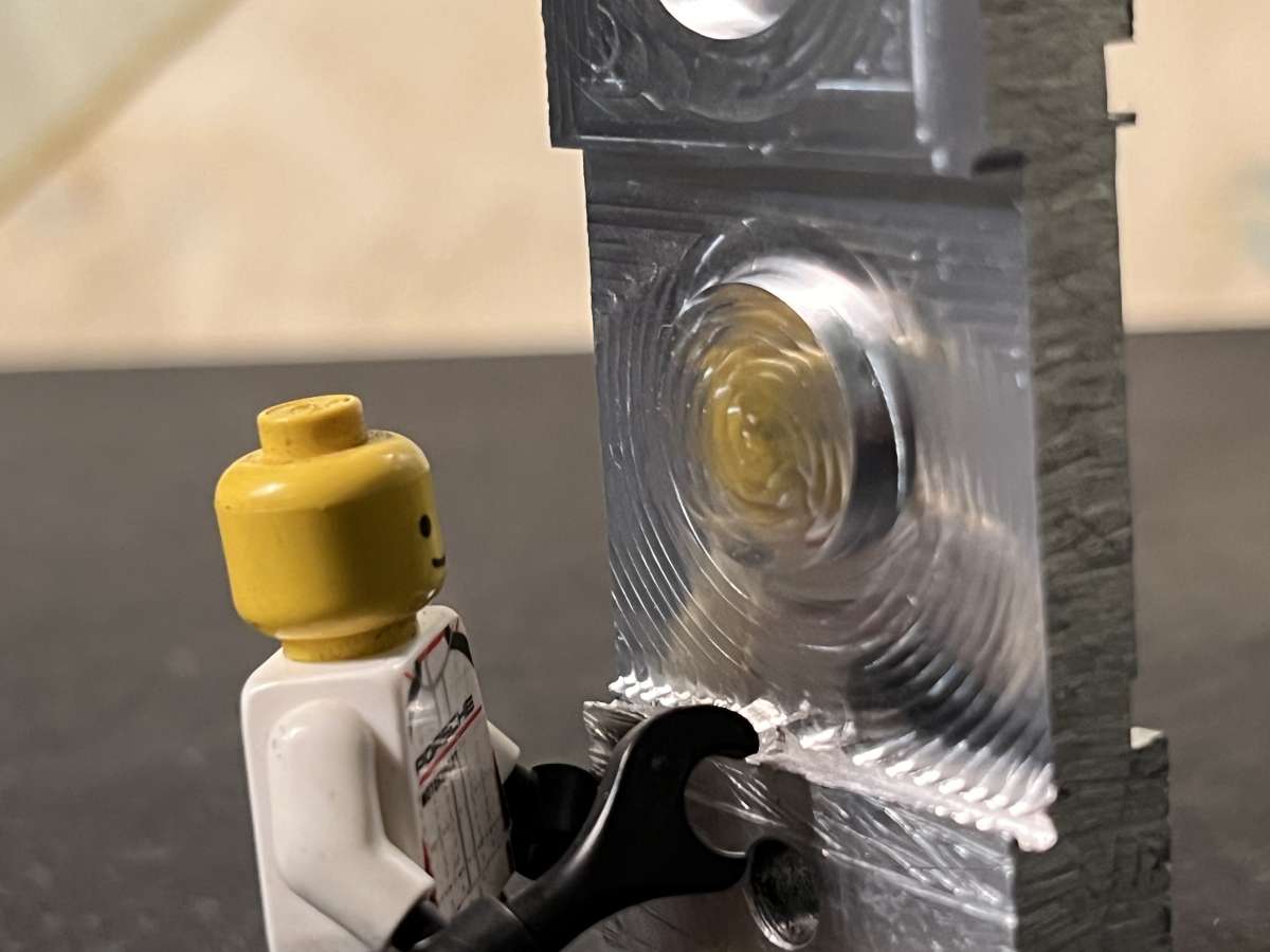

                        Those big engagements where your little man has his spanner are going to be what is loading up the tool, not quite sure what you had set to leave those. Also you could reduce the tool stickout, hold at least upto the coating or right to the top of the flutes
                        engage

                          The big engagements are where the model stock isn’t. I trimmed a big slot first, but I guess the tool path ran further out than I thought.
                          Ive not got a vice sorted yet, so I left the stock long so I had something to clamp on without crashing into the clamps.
