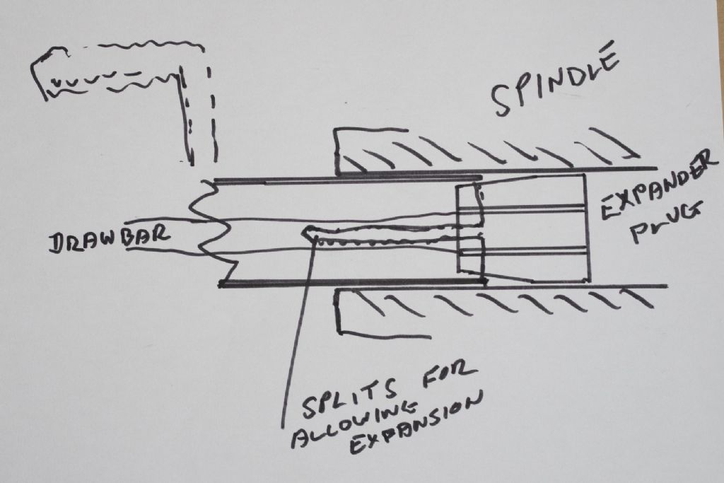

      Posted by Jim Beagley on 22/05/2020 17:23:00:

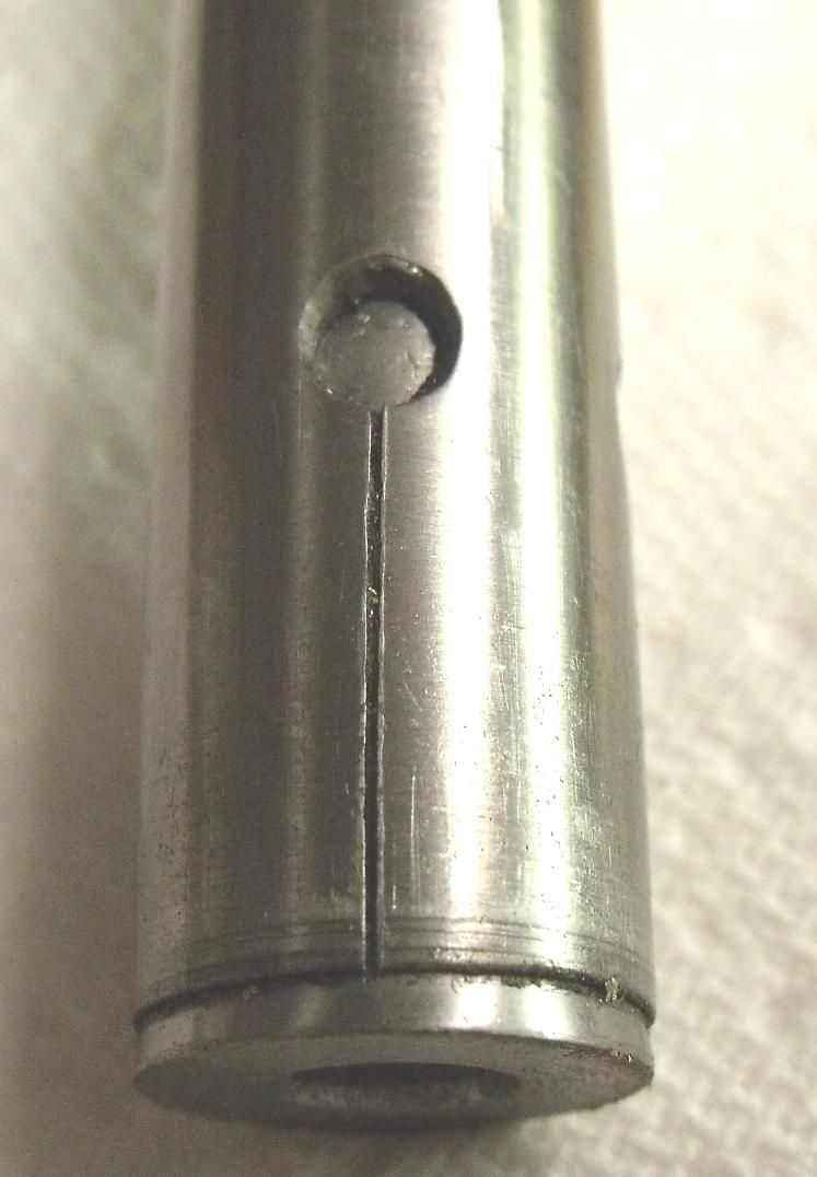

      Any clever solutions for knocking up a manual winding handle?
      Can't find a picture unfortunately but I made one for my mini-lathe based on the mechanism used to adjust bicycle handlebars.
      Turn about 75mm of aluminium rod so the diameter just fits in the spindle. Drill a 9 or 10mm hole through the rod to comfortably pass a long M8 bolt. Then saw the rod at a 45 degree angle across the middle and fix a crank handle to one of the pair.
      No need for any precision.
      Assemble so the head of the bolt is inside the spindle and supported by a large washer on the flat end. With the bolt loose, insert the two parts into the spindle and tighten the nut. Tightening causes the two angled surfaces to slide and expand to grip the inside of the spindle. Undoing the nut releases the grip allowing the winder to be removed.

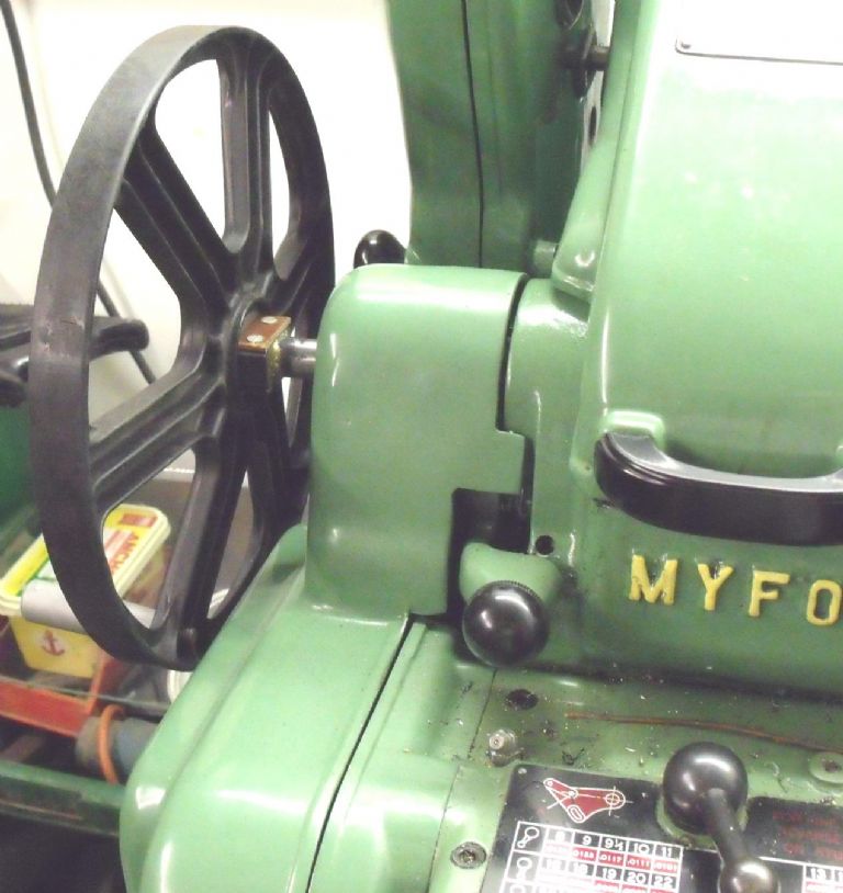

              Hi Guys,
              I made my lathe winding handle from a scrap plastic drum pulley from a old front loading washing machine. I made a revolving handle and screwed it into one of the spokes to make it easy to turn.
              The collet is similar to the one in the drawing above.
              There are other pictures in my album.

                That handle will make all the other Myford people green with envy. You will never get me to post a photo of the one I made.

                  Posted by old mart on 22/05/2020 20:52:12:
                  Oh go on ! It can't be that bad if you still have and use it.
                  That wheel came from a scrap yard just for the price of taking a bolt out of the hub and I kept the belt. Handy keeping a mover in the boot.

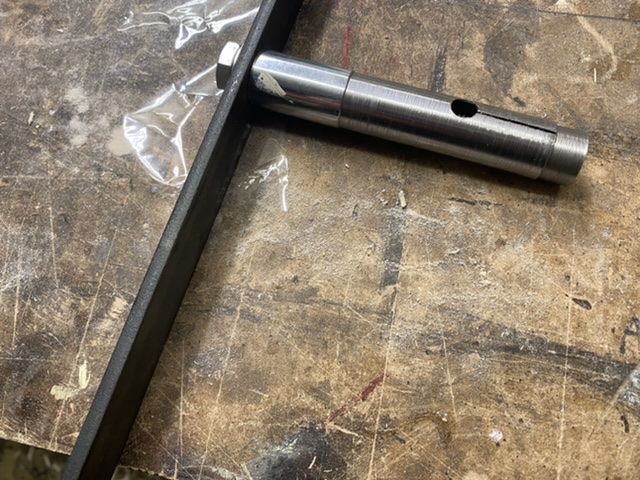

                        None of the backplate stuff arrived for the weekend to I made a spindle handle instead. Thanks for the inspiration.

                          Hi Jim, Guys,
                          Not bad, not bad at all ! I've seen far worse.
                          I put a collar on mine to stop the winding wheel from fouling the change gear cover. You can't see it in my pictures above. But it was too easy to put the handle in and then find that you couldn't turn the handle because it was pressed up against the cover.

                            The joint between the handle and the shaft needs to be strong because of the force needed to cut these large threads.

                              I’ve not finalised the handle arrangement yet but I’ll take note of your comment.
                              The tube has a bush at the handle end that will probably get welded in somehow and attached to the handle.

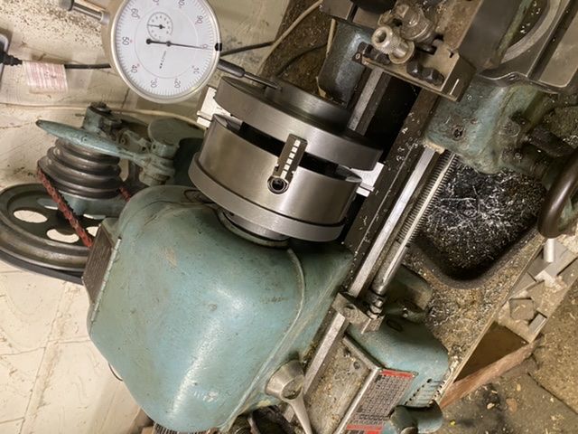

                                Well the Boxford backplate has arrived and it fits in my 4-jaw.
                                All dialled in, plus I’ve got the BSW insert.
                                So I’m guess the first step is to completely bore out to the ID to start the thread from, and the afterwards counterbore the boss for the spindle clearance?
                                jeez this is nerve wracking!

                                  I have started with this process and bored the plate to 1.59D.
                                  How critical is your measurement shown of the 0.55 depth of the 1.75D counterbore?
                                  I have measured the plates I have, and the original S&B one is deeper than that by some amount.
                                  Can I simply cut it to 0.55 then at the end of the procedure just extend the counterbore till the plate screws up to the face of the spindle?
                                  cheers, Jim

                                    You could screw cut the whole thread first then counterbore but that just means more thread to cut. I think the best thing to do is match what you have already since you know it works.

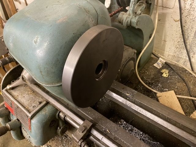

                                      Well I’ve cut the bore and counterbore to Old Marts numbers. I’m strictly metric so there was some calculator action going on!
                                      Tomorrow I’m going to attempt the threading
                                      Boring Complete

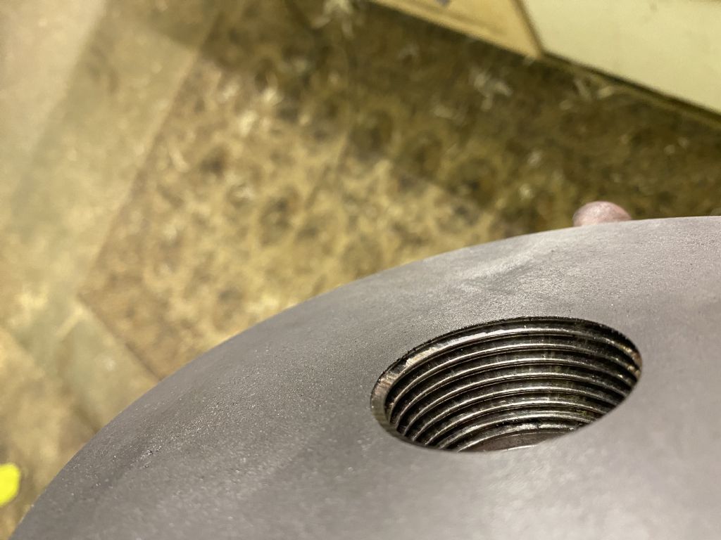

                                        b37e7594-db83-4623-afe9-ecc72dcdf81c.jpegSuccess. That’s all for now, but it wasn’t plain sailing so I will have some questions in the morning.
                                        but mainly, it’s done! Yay

                                          Now you have it screwed on to the spindle, it needs bedding in a bit. Make sure every bit of swarf is removed from the internal thread using a small wire brush. Also deburr the ends of the thread, a Dremel comes in useful here if you have one. Clean and oil the threads and with lowest back gear engaged, screw the plate on and off several times, fairly tight. Use a strap wrench to start it unscrewing. The plate must come into contact with the face of the spindle, if it gets tight before contact is made, you will have to cut back the threads a little adjacent to the 1.75 register in the plate.
                                          A light facing cut or two will ensure the plate is true to the spindle axis.

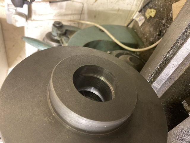

                                            So I wonder if I can air some of the problems I had to see if I can find out where I went wrong.
                                            When the thread started to show on the counter-bore, the thread cut registered on the outermost edge of the boss (nearest the spindle in fitment) but didn't run along the full length of the counter-bore, which at the time I didn't understand.
                                            I stopped at this point and reversed the plate and chuck, and the thread would start but go hardly any distance onto the spindle, so I reset, cut the thread a thou deeper and tried the fit again.
                                            This went on for ages, with my trying to get the thread to show the full length of the counter-bore, and trying the plate on the spindle. With every pass, the thread would engage very slightly more, but nowhere near fully.
                                            Eventually, I gave up this method and took a tiny cut off the counter-bore face and the plate screwed on instantly.
                                            So but conclusion after all that is that maybe the counter-bore was slightly tapered?
                                            Now I used the compound slide to machine the counter-bore, as its got a dial, whereas the carriage doesnt.
                                            Is this a boo boo, as its the only way I can think that I could have got the taper.
                                            In hindsight I realise I could have used the DTI to get the depth of cut from the carriage.
                                            So, sorry for the long post, but its complicated (to me anyhow).
                                            Anyone got any thoughts on that lot?

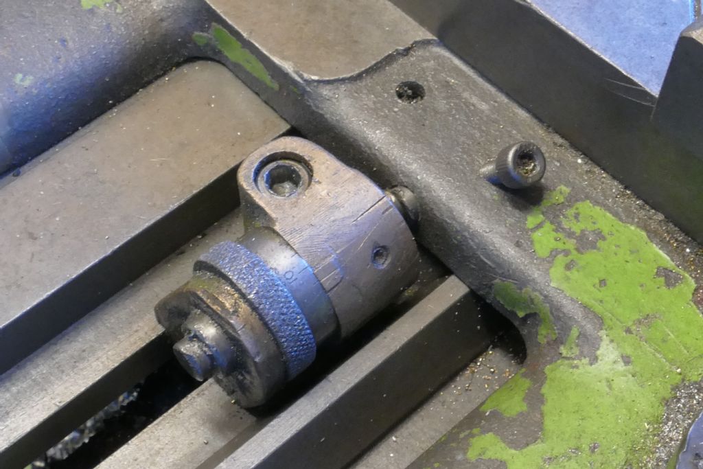

                                              You should have used the carriage to cut the register without a taper. You can use the compound slide to set the depth and use a stop for the carriage to do this. Some Smart and Brown lathes have a positionable stop that fits between the ways, there is a small hard point on the leading and trailing faces of the carriage that contacts it. If you don't have one then a simple stop can be made to grip the nearside dovetail to act as a carriage stop.
                                              Position the stop, move the carriage up to the stop. Set the compound slide dials to zero with the tool just contacting the face of the workpiece. Wind the carriage away from the work piece and advance the compound the required depth.
                                              Now when the carriage is taken up to the stop the tool goes the correct distance into the bore.
                                              You can use the compound to do the job but it must be set to exactly parallel to the ways using a dti and suitable test bar.
                                              Slight errors in the compound angle away from perfectly parallel to the ways will not cause issues setting the depth (cos of a small angle is very close to 1) but will cause tapering of the bore produced.

                                                Hi Martin.
                                                That all makes perfect sense.
                                                I have a stop and did exactly as you suggested and now have a perfect counterbore using the carriage.
                                                Its so so simple when someone tells you what to do but it seems insurmountable beforehand.
                                                My apron has a clutch but I have not used it except to adjust it to engage the apron or cross slide.
                                                I seem to have a slight fear of breaking it!
                                                OK so now to cut the thread again and see how it works this time.
