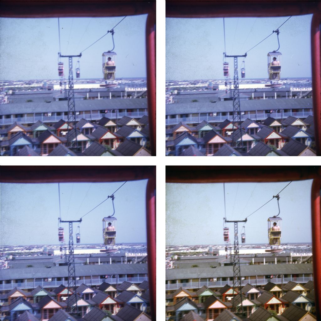

                      Hi, after reading MichaelG's post of 24/10 and with reference to the link about Kodachrome scanning, yesterday I picked out a Kodachrome slide from only 28 that I have, which was taken in August 1971 at Butlins in Skegness while on the chair lift that used to run from one end of the camp to the other end. This is one 93 slides that I ever took and all of these were keep in a good quality wooden slide storage box, however, it did speed a few years unopened in a room that was always cold and a little damp and even though the box was closed, dampness had got onto many of the slides and a few were completely destroyed, quite a few have damage with mildew and others are a bit grubby. This chair lift one, is one of those that are a little grubby, but it's not grubby all over and is more noticeable in the skyline of the photo. The scanner I've used is an Epson Perfection V550 Photo. It has four different modes, but I've used the Home Mode and the Professional Mode. Each mode has a selection of adjustments that one can make, but the professional one has the most. The first picture below which consists of three scans and used the Home Mode, and looking at frames from left to right and top to bottom, all were scanned at 1600 dpi / 48 bit colour. First frame was at the default setting, second was using Digital ICE and the third one was using Digital ICE and Colour correction, all were set to scan at a target size of 50 x 50mm.

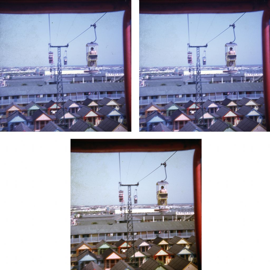

                      In this second picture, all the frames were done in the Professional mode at 2400 dpi / 48 bit colour and 50 x 50mm target size. The first frame was default, the second using Unsharp mask on medium and dust removal on medium, the third was using Unsharp mask on medium and Digital ICE and the fourth using Unsharp mask on medium, Digital ICE and Colour restoration. There are other settings available such as brightness and contrast and red green and blue colour settings can be made individually, but I didn't use any of these. It is quite easy to spend all day just on one slide for all the settings available, but all I wanted to see is if fine lines on Kodachrome slides would be washed out as the link in MichaelG's post suggested they would, but viewing the slide through a single lens eye viewer, that I scanned, the two fine wires in at the top middle that attach to the stanchions can been seen by about the same amount as shown in the pictures above.
                      Anyone interested can view / download a copy of the user manual for an Epson scanner that I've mentioned Epson V550
                      This slide was taken with my reasonable priced instamatic Halina camera Halina Simplette which was the best one I had available funds for at that period of time.
                      Regards Nick.

                        An interesting demonstration, Nick … and it reminded me about one nagging doubt about my first link:
                        The author states:
                        “As known, the ICE does not work in black and white films. Now I mentioned in the beginning that in principle, a Kodachrome film -Film is a black and white film that does not get any colour until the developing process. In fact, the Kodachrome film contains similar substances (for example silver) that are also contained in black and white films and are impermeable to an infrared ray. The ICE proceeding fails with such kinds of particles.”
                        dont know
                        It’s a long time since I worked at Kodak, but I am almost certain that [in theory, at least] there are NO remaining particles of silver in a correctly processed Kodachrome ! … and therefore his analysis is probably based on a false premise.
                        For any interested geeks … The fiendishly complicated process is described here:
                        **LINK**
                        and, if you are a glutton for punishment, the chapters run from z50_01 to z50_10
                        Edit: __ I also note, from his comments about ICE Professional, that the page might date back to about 2004/5
                        Edited By Michael Gilligan on 27/10/2021 09:53:24

                          Glad to see you are experimenting.
                          If Kodachrome forms such a small proportion of your collection then I would not overthink it TBH, just do the best you can and concentrate your thinking on the slides that form the majority of the set.
                          Some of the scanner options change the way that the image is captured – ICE dust removal does an infra red pass for example. Some options change nothing about the actual capture but are instead using built in postprocessing steps in the software. My own preference would be to get the capture as good as possible (sharpness, resolution, exposure etc) but avoid the built in software steps because I would be willing to do these myself and play with the settings using my own choice of software (Darktable usually) but if you want less effort and are happy with the results then stick with the steps in the scanner software.
                          Maybe you are doing this already, but have a good quality blower to hand – something like a Giotto's Rocket and shift as much dust as possible before scanning.

                            Hi Andy, as I tried to point out in my post, these scans were to see if Kodachrome slides could be scanned to an acceptable level with my Epson scanner after reading MichaelG's link, which in my view, with the age and condition, it did, as I said, fine lines with Digital ICE, didn't get washed away as suggested in the link. The Kodachrome slides are almost a third of the total slides that I ever took, (successfully) only being a "point and shoot" type of photographer them days, taking mostly holiday snaps, I was influenced to use Agfacolor slide film by a friend who did more serious photography, turns out the Kodachrome film holds the colour much better over time even though they were mounted in cardboard frames instead of plastic ones, but I did most of my photos using print film as it was easier to show them to others and even back then prints from slides done professionally where not so go as they were from print film, not at a standard kind of price anyway. I have more or less scanned all the slides that I really want to hold on too and I do know how to remove as much dust and dirt from them and negatives, but thanks for your input.
