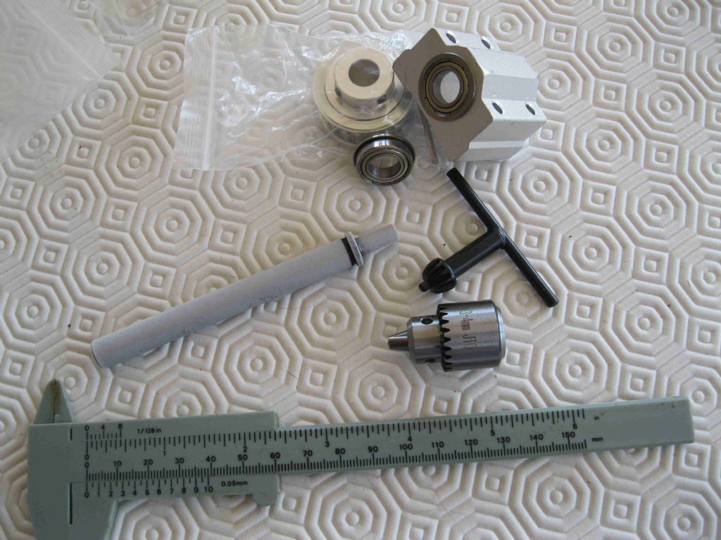

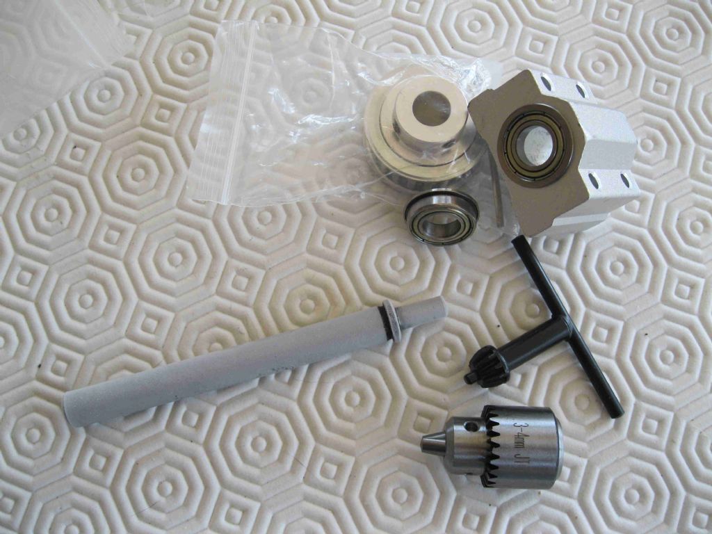

      Couple of pics below of some imported components for a drill spindle. Looks to be well made and needs to be assembled. Thereby lies the problem – the tolerances are 'marginal', in that one of the bearings slotted into place with finger pressure., the other is very much an interference fit. The spindle, as is, won't accept either bearing. Not sure what the fit discrepancy is but I've had the spindle in the freezer for a week or so and still not a finger pressure fit in the bearings. I can foresee jamming problems so would greatly appreciate adfvice on best practice assembly routine for spindle to second bearing and then to housing or second bearing to housing THEN spindle through both at the same time.??? Plus any action to the remaining bearing – heating (and how). Ideas very welcome!
      rgds
      Bill

          You had better luck than I did. In my case the bearings rattled around in the block recess with about .8mm clearance – completely useless.
          Had I been fortunate enough to obtain one with a decently tight fit, I would have lubricated thoroughly, pressed the shaft to front bearings then to the block, then tapped the back bearing with tube down over some blocks with something large and heavy (or resorted to the trusty 12 tonne press if all else failed). Other methods would probably work just as well, such as place bearing in block then press shaft in.
          If you are of a sensitive disposition, pre fitting, you could polish the spindle up a bit with fine silcarb paper on't lathe to a tight sliding fit , but go easy as easy to overdo.
          #416741
          Martin Hamilton 1
            @martinhamilton1
            Have a look on Youtube as Steve Jordan done a review recently in these, including assembly. His bearings were both on the tight side & used the vice with a plate to push the bearings in one at a time, his spindle was also tight & sanded/polished it in the lathe. If you have a loose bearing use some Loctite 641 bearing fit.

                  Martin X 2 – many thanks – helpful (and reassuring) It would seem that my overly tight fit is the better bet.

                        Even liquid nitrogen will not shrink a small diameter by much, a domestic freezer has little chance of working if the interference is more than 0.0001". You could try heating the bearings to 140C, the lowest most modern fan ovens will go to, which will not damage them. Measuring the bearing bores can be difficult, a set of rocker gauges would be the most economical and quite accurate with care.
