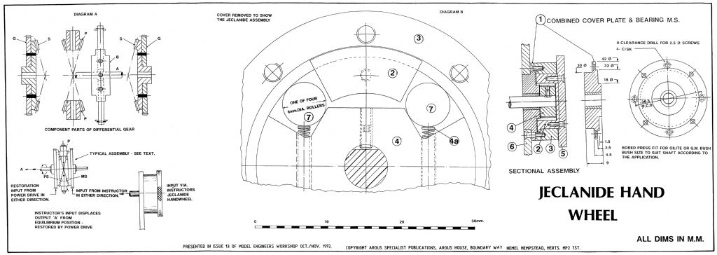

Diagram A identifies components of all six diff units incorporated in the display mechanism. A typical diff assembly is also shown. (Together with notes relative to the specific unit by which the instructor fed commands into the display, about which more below).
Article continues below…
Instead of driving the spider by a crown wheel, the spider-boss (B) complete with two stub-shafts is fixed to a central shaft (A). Two bevel planet pinions (P) are free to rotate on the spider stub-shafts, held captive by circlips and washers.
A pair of bevel gears (S) – the sun wheels – are free to rotate on the central shaft (A), again held captive by circlips and washers. Both sun wheels have spur gears (G) attached, their PCDs selected according to the ratio required when meshed with their respective drives. (We obtained all our gears from S.H. Muffett Ltd, Tunbridge Wells, Kent- usual disclaimers – but for those interested in building an experimental diff, take a tour round second hand shops and select two identical bevel drive hand drills).
The display had to reproduce all aspects of the cause, effect and corrective measures used in restoring a disrupted state of equilibrium so, as may be expected, some of our diffs operated in the car-mode, others followed a slightly different operating mode whereby two inputs were applied to the ends of the ’T’ cross bar and the result taken from the leg.
With reference to the assembly in Diagram A, the instructor’s jeclanide handwheel rotated the manual input of a diff operating in the double input mode, i.e., turning the handwheel rotated the ’manual’ sun wheel (NIS) of the pair, the other sun wheel (PS) being coupled to the power driven mechanism. In the neutral or equilibrium state, the differential unit was at rest. (ie. the pigeon in its loft). By turning the handwheel, the instructor could move the pigeon to some remote spot, thereby disrupting the status quo.
At the differential, the high resistance to rotation of the motor driven mechanism ensured that sun wheel (PS) was too stiff to be turned by hand. Consequently the rotation applied by the instructor to his manual sun wheel (MS) caused the planet wheels to roll round the ’drive’ sun wheel (PS), thereby rotating the spider and its carrier shaft (A) away from the neutral equilibrium position.
From a slow start, the mechanism gradually responded to the non-neutral state, the power drive rotating its sun wheel in the correct direction to restore matters. It gradually decelerated as it approached neutrality, so preventing an overshoot as the spider and its shaft regained the original neutral position.
Needless to say, there was much more to the system, but it was vital that whenever power was applied, it caused the planet wheels to roll round an unyielding manual sun wheel, otherwise, instead of returning the spider shaft to its original equilibrium position, the power drive would merely spin the handwheel.
Consequently it was necessary to prevent the manual sun wheel from rotating when twisted from the diff end while at the same time leaving it completely free to turn either way when twisted from the instructor’s end.

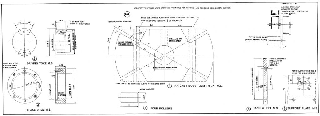

The eventual outcome is shown in Diagram B. The cover is removed to show the non-rotating brake drum (Item 3), two of the four rollers (Item 7 ), the ratchet boss (Item 4), the two roller springs (Item 4A) and the hand operated driving yoke (Item 2).
In its relaxed state, the two springs force the rollers into close contact with both the ratchet and brake drum, locking them together as one. Turning the yoke in either direction forces the appropriate pair of rollers out of the wedge mode and allows the ratchet to rotate accordingly, the other roller pair trailing in ‘free-wheel’ fashion.
The driving yoke (Item 2) and the ratchet boss (Item 4) were made in that order from a reasonable length of trued 35mm bar stock, turned to 30mm dia. to within a few mm of its end face, leaving stock to form the collar. The yoke was turned and bored then milled in the lathe to leave two lugs, each having a 56 degree included angle between faces, following which it was parted off to length.
The remaining piece of 30mm dia. stock was re-faced, centre drilled and then milled to form two flats, after which it was cross drilled to suit the springs. We salvaged springs from discarded ball pens but, in retrospect less bulky lighter-flint springs may have been a better choice.
Once the drillings were completed, the four ratchet teeth were milled. We fixed the chuck at 30 degrees above and 30 degrees below horizontal and used an end mill, cutting two teeth at two settings, then repeated the manoeuvres for the opposite pair.
The remaining items are straight forward machining tasks, responding as always to accuracy and attention to detail.

With regard to the original application, a fractional degree of lost motion was of no concern from the instructor’s point of view. However, as an experiment to satisfy our curiosity, one of the subsequent units had a solder layer added to each face of the yoke lugs in an effort to minimise lost motion. It proved highly effective and was noted for further reference.
