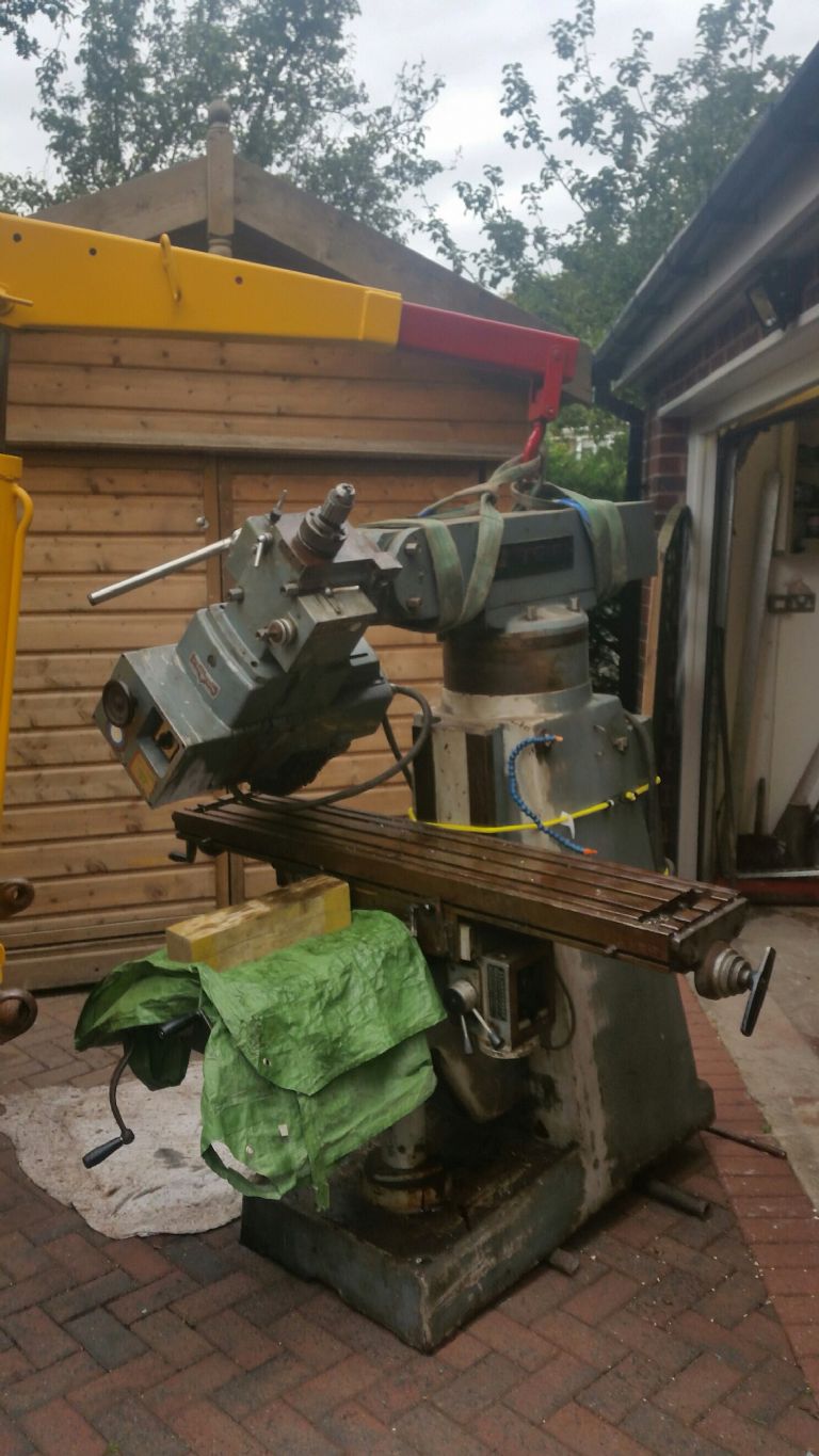

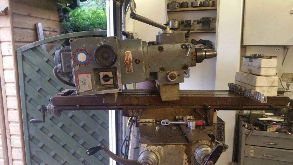

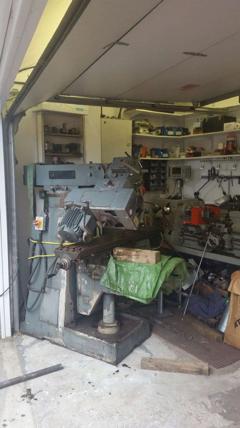

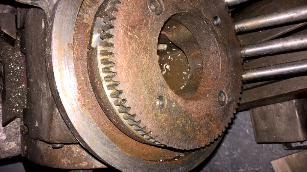

        I was going to start a new thread about my newly acquired Beaver, I'm not contemplating a full restoration, more a clean up and repair job, but is seems sensible to just add to this thread and keep all the Beaver info in one place……..hope thats ok?

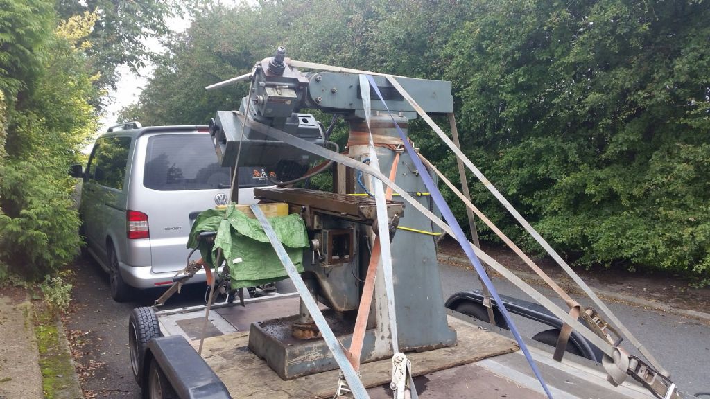

        Rewind a few days, and i saw a Beaver VBRP advertised on Gumtree, it was cheap and local…….Tempting ! The only problem being space, my workshop is crammed in the corner of an oversize domestic garage, with a door that limits headroom when open.
        Out with the tape measure and after some 'Man' measuring i convinced myself it was a goer, so me and a mate hooked up the trailer and set off to collect.
        This is my unsuspecting universal mill before it was ousted to make room…..
        The seller had a forklift and agree to load the mill onto my trailer, we decided to swivel the head down on to the table to lower the COG, there are 4 bolts to loosen, and then the head should rotate on a worm and gear, unfortunately it wouldn't budge more than a few degrees either way. after much faffing about we decided to undo the bolts completely and withdraw the head enough to clear the ring gear, this allowed the head to spin. we had a strap around the forklift tines to support the weight of the head.
        After some initial forklift wheelie shenanigans, (heavy old thing) we eventually got her loaded up….do you think we had enough ratchet straps on cheekyimage.jpg
        The journey home was uneventful, apart from it raining heavily and the mill spewing loads of oil everywhere, pity anyone following us. As it was late we stuck the trailer in my mates workshop overnight.
        Today we brought her home, luckily my aforementioned mate has a bloody big tractor, with a home brewed crane on the back, which made short work of unloading, he dropped it right in front of the garage, and in ten minutes we had it shoved in place on steel rollers.image.jpgimage.jpg

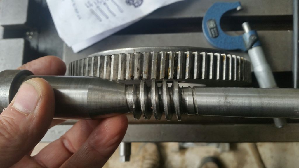

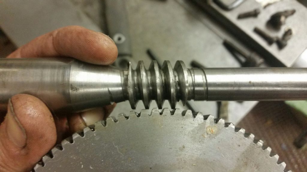

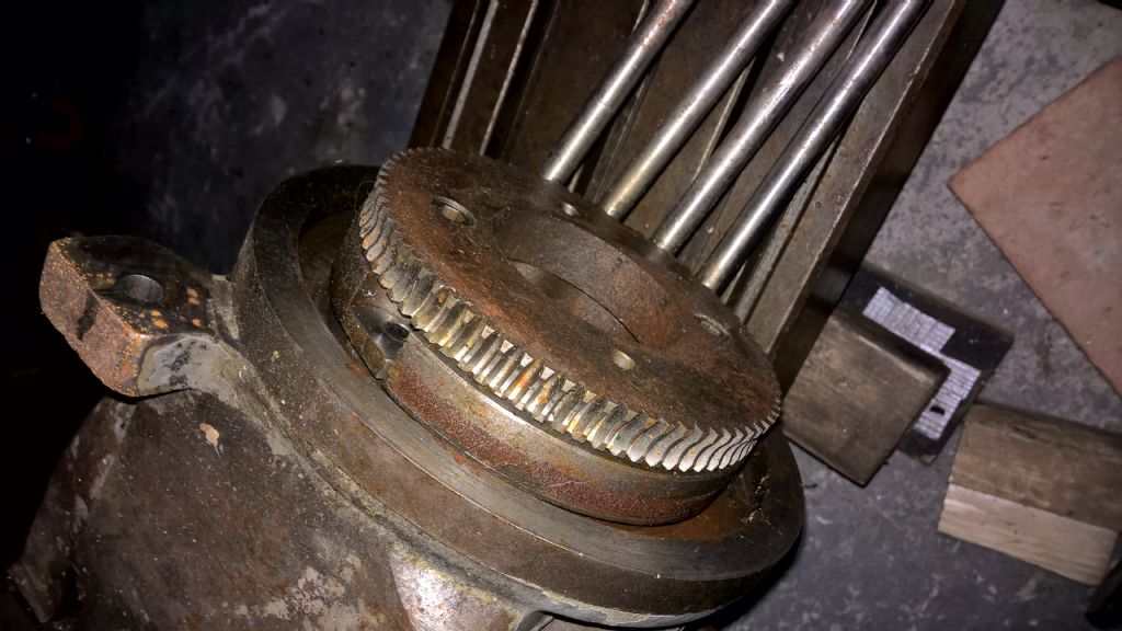

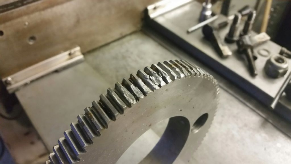

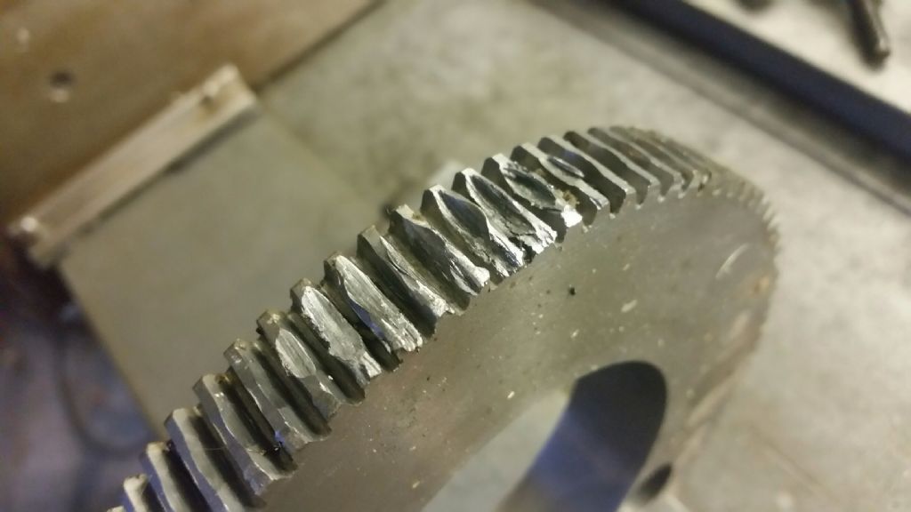

        First job was to work out why the head wouldn't rotate, so i wound the table up to support the head and unbolted it completely to gain access to the worm and gear.
        Once inside it was obvious what the problem had been.
        Strange thing is, i can't see how this gear and worm could have ever worked together, think someone has had a fiddle before……image.jpg

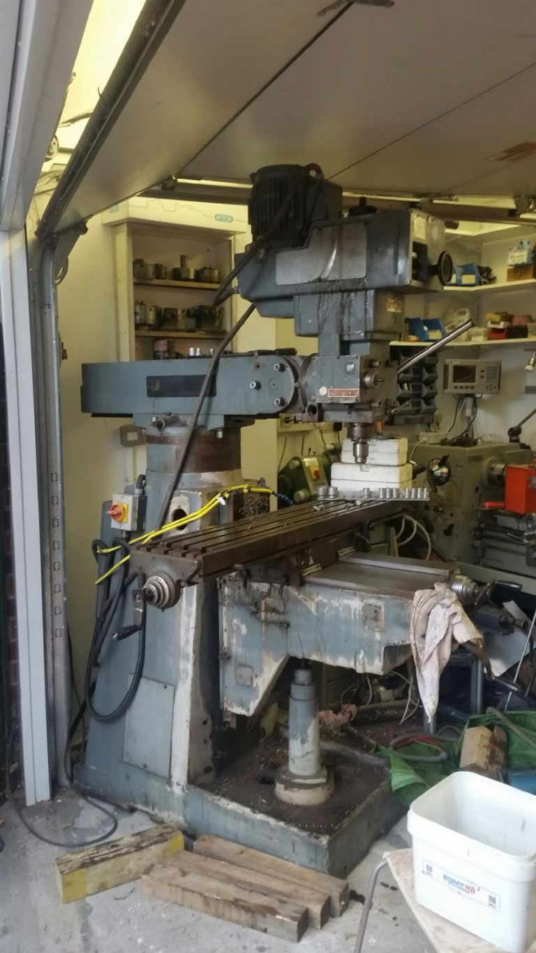

        I decided that would have to be a job for later, so boiled the head back on minus the gears and set to manually rotating it back vertical…….bugger me its heavy! in the end i used a small trolley jack and loads of wooden packers to get me most of the way vertical, with the last 30 degrees done by brute strength.
        Result…..it fits….and the garage door opens…..just !

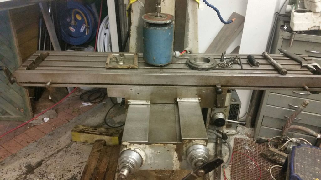

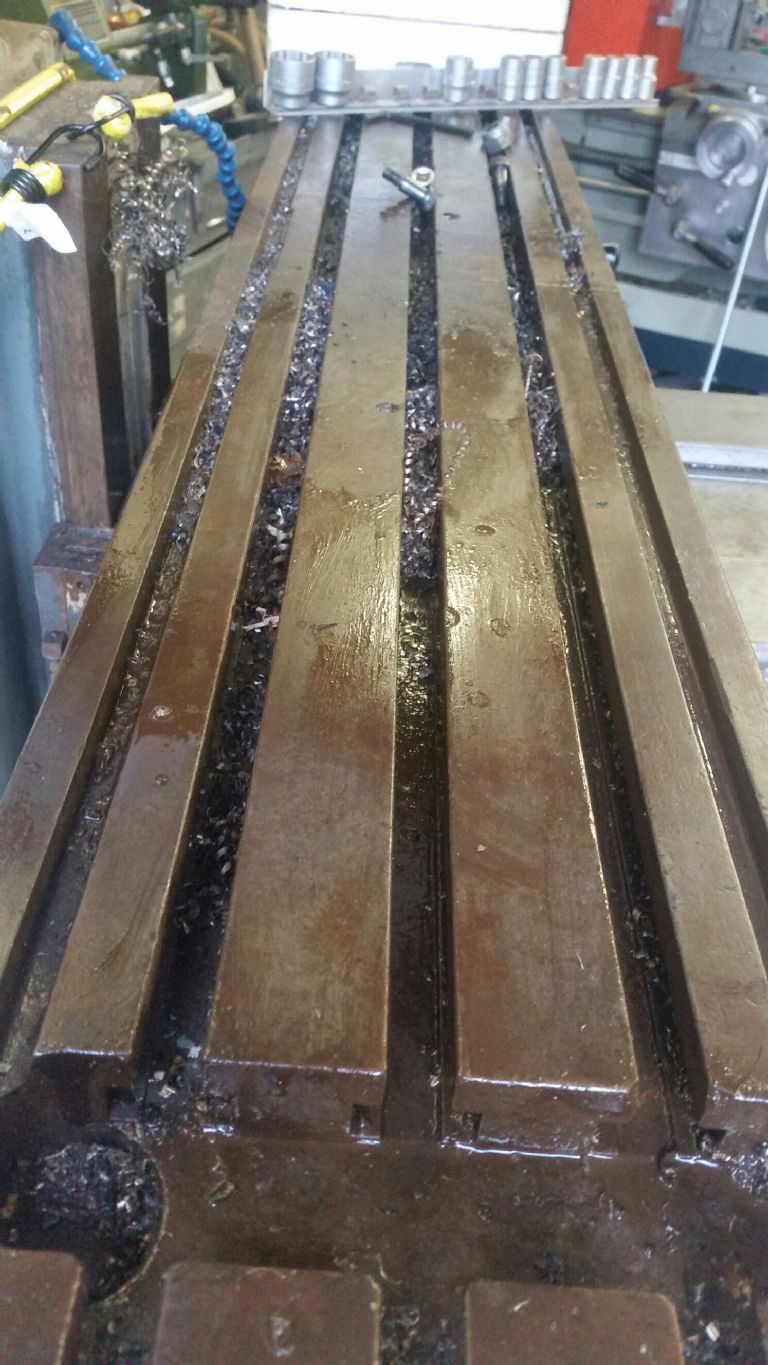

        Decided to have a few hours of peace, cleaning off all the swarf, oil and shite….first impressions are good, minimal backlash, and no visible wear to the ways….The table has a few battle scars, but nothing that's going to affect anything i do in the future. Interestingly it has piping for a one shot oil system, although no resevoir or pump are present, this may account for the good condition of the ways.
        More updates to follow wink

          I wonder if the wheel is from a series 2 Bridgeport, or just a random gear made to fit, the gear profile looks wrong to be a used with a worm but I'm not clued up on these things.

            I'm no expert either Russ, but something's not right, trouble is I'm unsure if it's the gear or the worm (or both) that are wrong.

              Posted by Alan Waddington 2 on 09/10/2016 01:19:12:
              Your worm looks exactly right, it's the wheel.
              I've dug this link out which I've believe I've referenced before. I've successfully identified worm gear sets with the help of the document. **LINK**
              You appear to have a single start right hand worm and I would anticipate you can work out the DP from the linear pitch but I'd double check their formula between DP and Linear (I'm still horizontal on my phone in bed… the formula doesn't look right but it could be)

                  Funnily enough I looked at that website last night, but bamboozled myself, will have another read. Am pleased you think it's the gear that is incorrect. I've never had cause to make any gears, but after looking at countless youtube videos I think I'd rather tackle the gear than the shaft/worm.

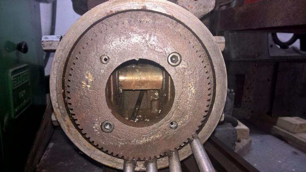

                      2016-10-09 16.33.09.jpgNot sure if it helps but here are pics of my gear, seems to show that the gears on mine are bevelled not straight cut like yours! (probably the wrong terminology but you can see what I meansmiley)
                      No idea where the spindle is so couldn't take a photo of that frown

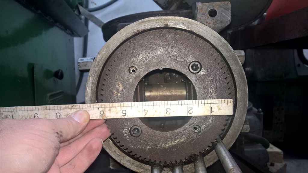

                        That's really useful Paul, and looks like i would have expected the gear to, with the concave tooth form. I wonder if you could find time to measure the diameter for me ?

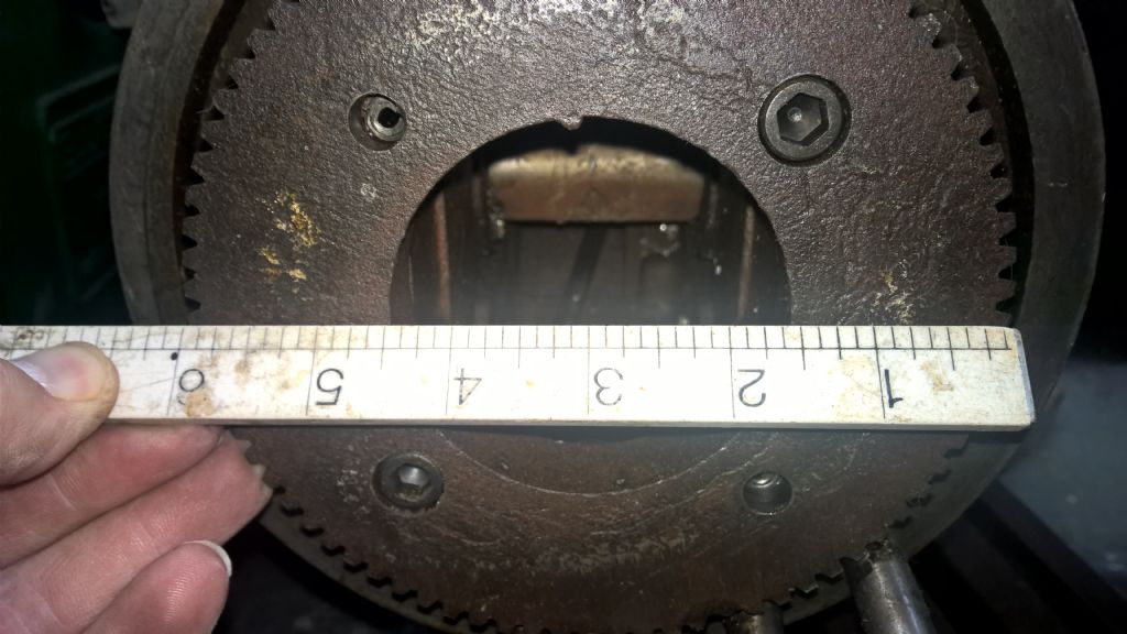

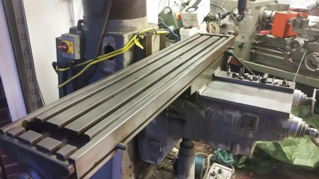

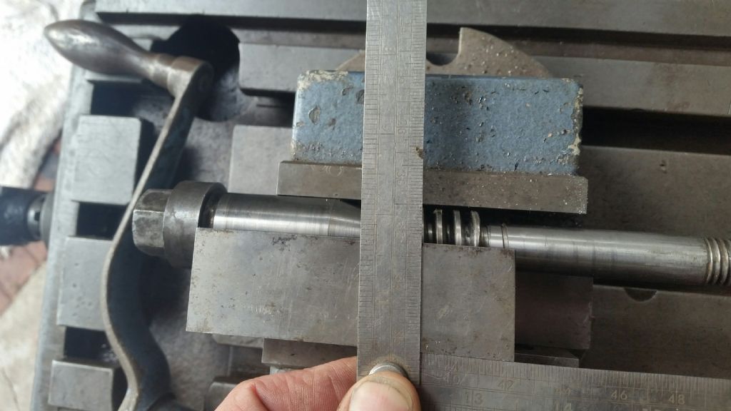

                        Had a closer look at mine today and did some measuring up, had the gear stood on end and it suddenly struck me that even ignoring the tooth form etc….the bloody gear is cut the wrong hand !
                        This picture shows how it would sit when in situ…..no
                        20161009_123916_resized copy.jpgThe only thing i had to try and measure the angle of the worm and gear teeth was a 2 ft rule with a line of chords on it……..not exactly precision, but after measuring both parts a few times i was getting consistent results, worm is 3 degrees and gear is 4 degrees20161009_125100_resized copy.jpgI just need to try and work out what form the worm is, and either have a go myself or get a new gear made.

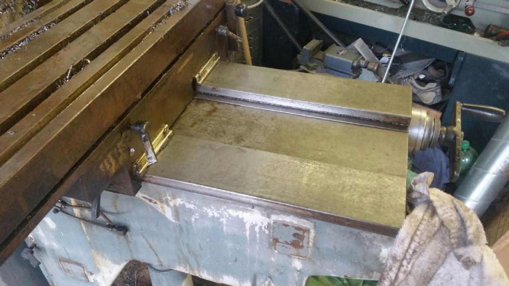

                        Did have some more progress today, moved lots of stuff around in my little corner, to try and make the area more workable, and also drilled and tapped the side of the mill to hold a nut and clamp set that i bought ages ago on ebay.

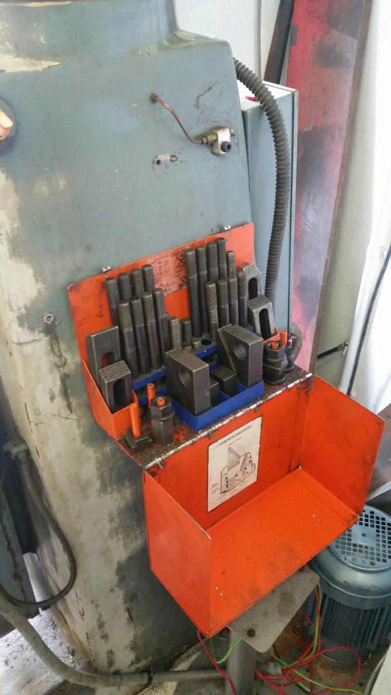

                        I never thought to question the size, and when it arrived realised the studs and T nuts were about 3 sizes too big for my old mill blush Fits this one perfectly though, so must have been fate cheeky
                        20161009_140925_resized.jpgAlso discovered my rotary phase converter has dropped a phase, so currently poking about inside to find the problem..surprise

                            sorry its taken so long to respond but here are some more photos of the gear. It looks to me like it is bang on 6 inches diameter. I'm afraid I didn't have time to count the teeh but hopefully the photos are good enough that you can do that from enlarging them smiley
