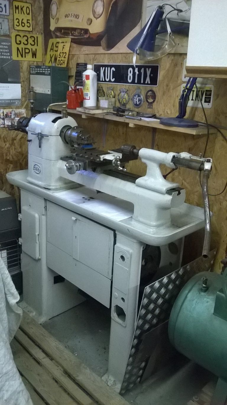

      Hi, I am an utter novice with a lathe. I bought my 1940s Boley lathe a couple of years ago and have only used it for polishing stainless fasteners until now. I am restoring an old GoldWing motorcycle and needed to make a couple of spacers so thought it was about time I got some practice in. My first attempts using a pice of 18mm dia. brass was awful and I managed to both seize and snap off an 8mm twist drill in it, I then tried some aluminium bar with more success but I now know I should have used some cutting fluid. I still have difficulties getting the parting tool centred and the tip of the tool fell off! The lathe is without a power feed but it will do most of the jobs I'll need to do on it. Boleys seemed to have specialised in watchmaking lathes but this is a decent sized floor mounted lathe, and they were of German manufacture.

          Brass is notorious for grabbing the drill, pulling it into too deep a cut and breaking, but normally with smaller ones than 8mm. Normally the chuck just spins on the morse taper. It is often suggested that you blunt the drill by stoning a flat on the cutting edge, that is making a flat for a few thou in line with the axis of the drill so there is no sharp edge and it is scraping rather than cutting. All very well if you can have 2 sets of drills.
          Otherwise you should use some oil so the chips can move easily and clear then very frequently to prevent jamming. Sometimes this type of drilling is called 'pecking'.

            I seem to have a charmed life drilling brass. I know it will grab so drill it's cautiously and take no notice of the noise it usually makes. Cautiously just means drill slowly. It takes very little effort at the feed.
            Can't really comment on your parting off problem. A photo of the tool might help. To post that you need to create an album – the green album icon up the page, place the photo in it and then post it in a thread using the camera icon. Or put some where on the web and paste a link using the one next to the camera.

              Your adventures suggest the lathe may not be perfectly adjusted, if tools are grabbing easily.
              Might be worth checking the spindle and slides to ensure they are all well lubricated and without shake as a starting point.

                Carrying on from Neil's suggestion, it's possible that the tailstock barrel has a lot of axial play.
                As said above, brass loves to snatch and pull the drill into it. So if the tailstock barrel can allow the drill to move freely by a significant amount towards the work then I could imagine that it could grab and seize up.

                    According to John's link, mine may well be a Model 4LE as it has a steel drawer and cabinet beneath the bed. I degreased the lathe and bought some special oil resistant paint in light grey so she looks as smart as those in the link. A previous owner has fitted an electrical box to one side with what I presume to be a rheostat so the speed can be altered with the turn of a knob. Another switch reverses the rotation. Two oil reservoirs are fitted but these weep so oil eventually finds it's way onto the tray. (Don't worry, I will eventually get to learn the correct terms).
                    It's very possible that some parts are incorrectly adjusted, understandable on a 65yr old machine I guess. Since getting the tools properly set up to the centre point of the job, I will need to get a pointed tool to fit in the tail stock and adjust the height of the cutting tools with this.

                      Today I went out to have another look at my old Boley after looking at numerous images of Model 4 lathes. The tailstock on mine doesn't have a wheel to wind the chuck in and out, but a long arm about 2ft long. I believe this may have been because the lathe was used for production work where the operator was required to produce dozens or even hundreds of a stock item.
                      The lathe is fitted with three oilers, all of which leak. Can anyone recommend oiltight oilers?
                      I have an adjustable parting tool on order through eBay.

                              Well after a few hours using my new 60yr old 'toy' I have turned up a stepped aluminium spacer for the motorcycle I am refurbishing, and today made two spacers, this time in stainless steel. They are now fitted to the bike and look very nice. Both the mudguard and the rear grab handle are now properly mounted to the frame and nicely bolted down with stainless Allen bolts.
                              So what did I learn? Well one YouTube video mentioned 'Rigidity, rigidity, rigidity' and he was right. Whilst I tried to keep the overhang of both round bar and cutting tool short, and ensured the parting tool was central, there was still a fair amount of chatter and some smoke. Unlike the videos on YouTube – 'Tom's Techniques' range of videos is interesting – when no cutting fluid was used, I actually did use some as this kept both the noise and smoke down, and the finish was better.
                              Also I was unsure of what speed to use. My plain lathe has no speed indicator just an add-on with a variable speed rheostat which goes from 'Dead Slow' to 'Fast'. So how fast for ally and how fast for stainless steel?
                              Cleaning up after doing some turning is a chore as the cutting fluid mixes with the swarf. Once cleaned down I have added a 'nappy' to the tray. These are oil absorbing pads made from layers of paper and used in aircraft servicing. My son can get hold of packs of them and they do absorb oil well such as when doing oil/filter changes on the bike or car.
                              The tool post on my lathe has a series of M4 Allen screws to hold the cutting tools and I don't think this is anywhere near secure enough. When I get around to it I shall drill and tap M6 or even bigger threads for larger Allen screws as these will hold the tools more securely.

                                Chatter on a lathe like that is more likely to be down to loose slides or head stock bearing possibly augmented by technique and tools.
                                M4 is big enough providing they are high tensile which they usually are. If not the ends bell out often making them difficult to remove.

                                          The drill chuck came loose yesterday and it seems I was over enthusiastic with lubricating the Morse taper. I've cleaned it off and replaced it dry.
                                          Is it good practise to mount a lathe tool in the tool post with packing pieces ABOVE and below the tool? I have only had the 5mm packing piece below the tool and with the screws bearing down on the top of the tool.

                                            No pictures yet of your Boley which I hope you will not modify without careful thought.
                                            Morse tapers should not be lubricated (although a thin film of oil keeps rust at bay and should do no harm).
