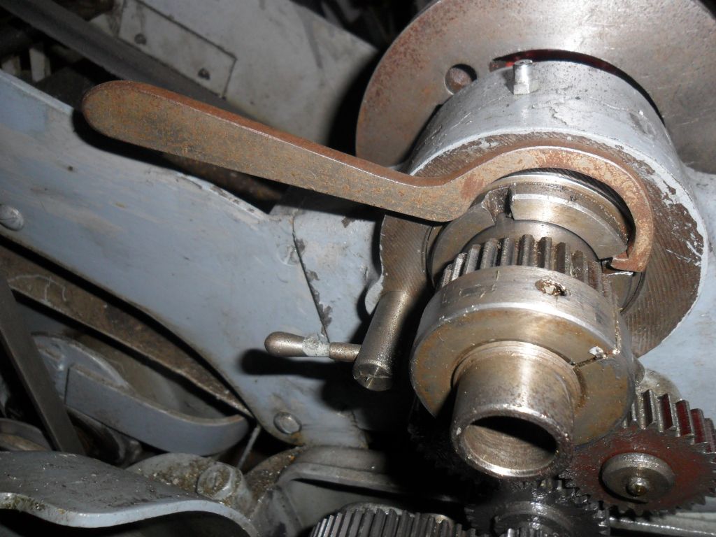

                                      Hello all, my name is Des. I have a Super 7, one of the early models with the horizontally le operated lever clutch and the cast in headstock lubricator with sight glass, prior to the wick feed.
                                      I foolishly engaged the drive with the chuck key in place, resulting in it striking the bed, which fortunately was undamaged but now the cone pulley rotates without driving the spindle.
                                      Before I attempt to dismantle the headstock I would appreciate advice from anyone cares to give it. My first thoughts were that a drive/woodruff key had broken. I believe a “half round spanner” is needed, dimensions would be appreciated

                                      Nobby
                                        @nobby
                                        Hi
                                        Where you switch over to use the back gear that may have sheared off. ?

                                        #74939
                                        Clive Hartland
                                          @clivehartland94829
                                          I am wondering if the Hex. locking bolt has just jumped out of engagement to the shaft?
                                          It has happened to me on my Myford ML10.
                                          You need a cut short allen key to fit the Hex. head bolt that is in the side of the pulley and loosen it and lift it up to engage the lock, then tighten afterwards.

                                          #74946
                                          Nobby
                                            @nobby
                                            Hi Guys
                                            If you take the spindle out you will find there is a wooruff key there as Desmond said it my be that one has sheared . You will need a C /1/2 round . when replaced it will give you a chance to set the that front tapered bronze bearing as per myford instructions.

                                              #74951
                                              Cabeng
                                                @cabeng
                                                Des:
                                                Another possibility is that the pulley has broken loose from its inner bronze bush. I know of two machines where this turned out to be the reason for the pulley rotating without driving the spindle.
                                                Not a disaster, after dismantling just loctite the bush back in place, re-assemble, adjust the spindle as already mentioned, and it’s fixed.

                                                Desmond Farthing
                                                  @desmondfarthing48201
                                                  Hello Nobby and Clive. Thank you both for your helpful replies.
                                                  No Nobby I wasn’t at the time using back gear. The information on the C spanner was unclear, but I think it meant one of 1 1/2 diameter. I shall get/make one. I shall disassemble the headstock and look for a broken woodruff key, and also also follow Clive’s advice about the Hex locking locking bolt, and details on the pulley.
                                                  Once again thank you both for you prompt replies to my request.

                                                  Nobby
                                                    @nobby
                                                    hi Des
                                                    I think this may help .I just ran down and took this photo.To set bronze bearing tighten
                                                    until spindle is tight/locked Them come back a 1/4″ .Please see c spanner Is that the right word? As you may know that is a split collar at the front tighten with allen key
                                                    Nobby
                                                    #74960
                                                    Nobby
                                                      @nobby
                                                      Hi Des & Guys
                                                      That split threaded adjusting collar (4) is for loading the back 2 ball bearings Don’t overload these as it will cause excessive wear Do this first tighten allen screw (3) Then load front bearing as I said before.
                                                      Nobby
