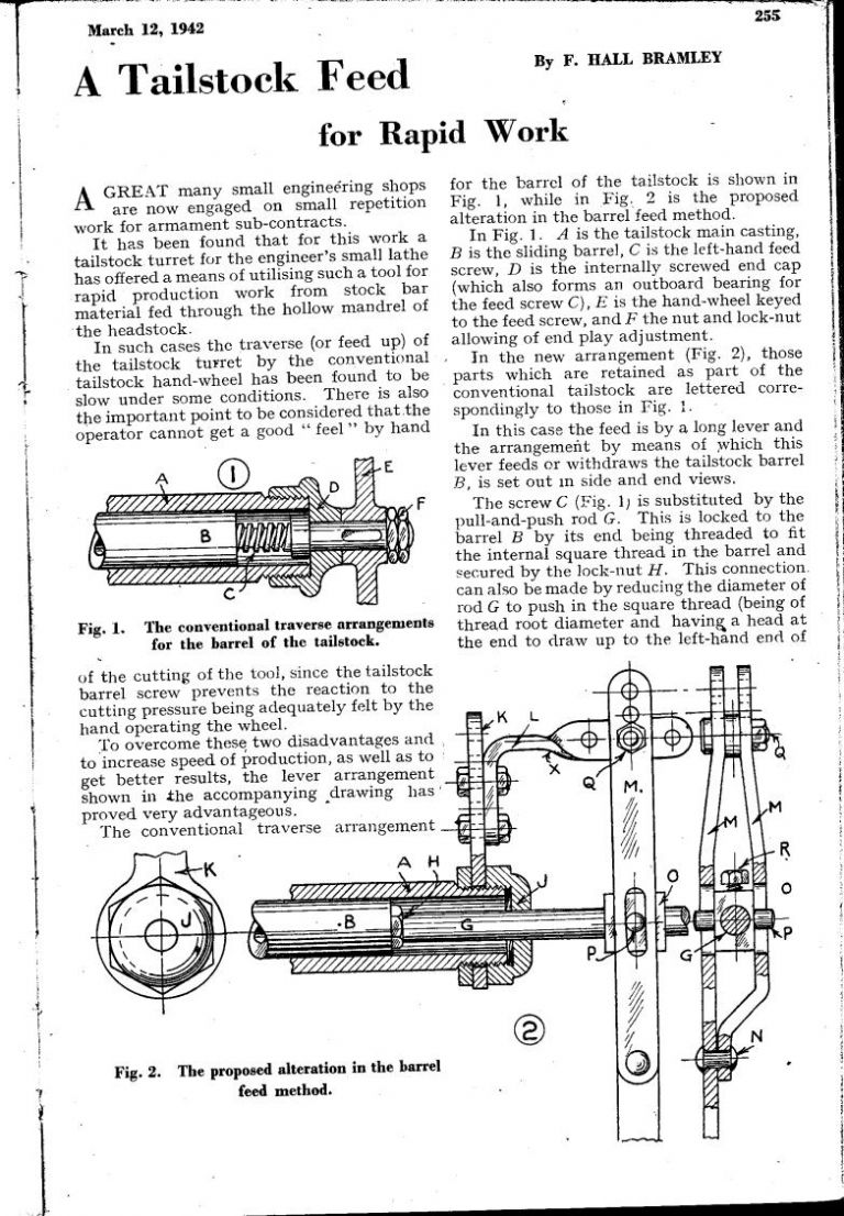

                        Heres one from 1942
                        #157410
