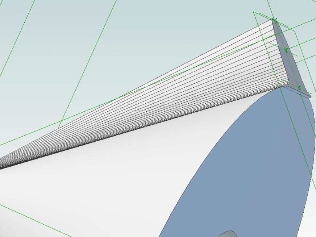

Hi I have been trying to model a bevel gear but have come to a standstill…………………..

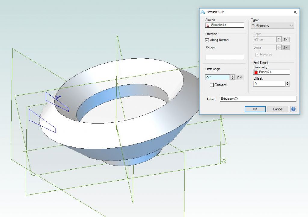

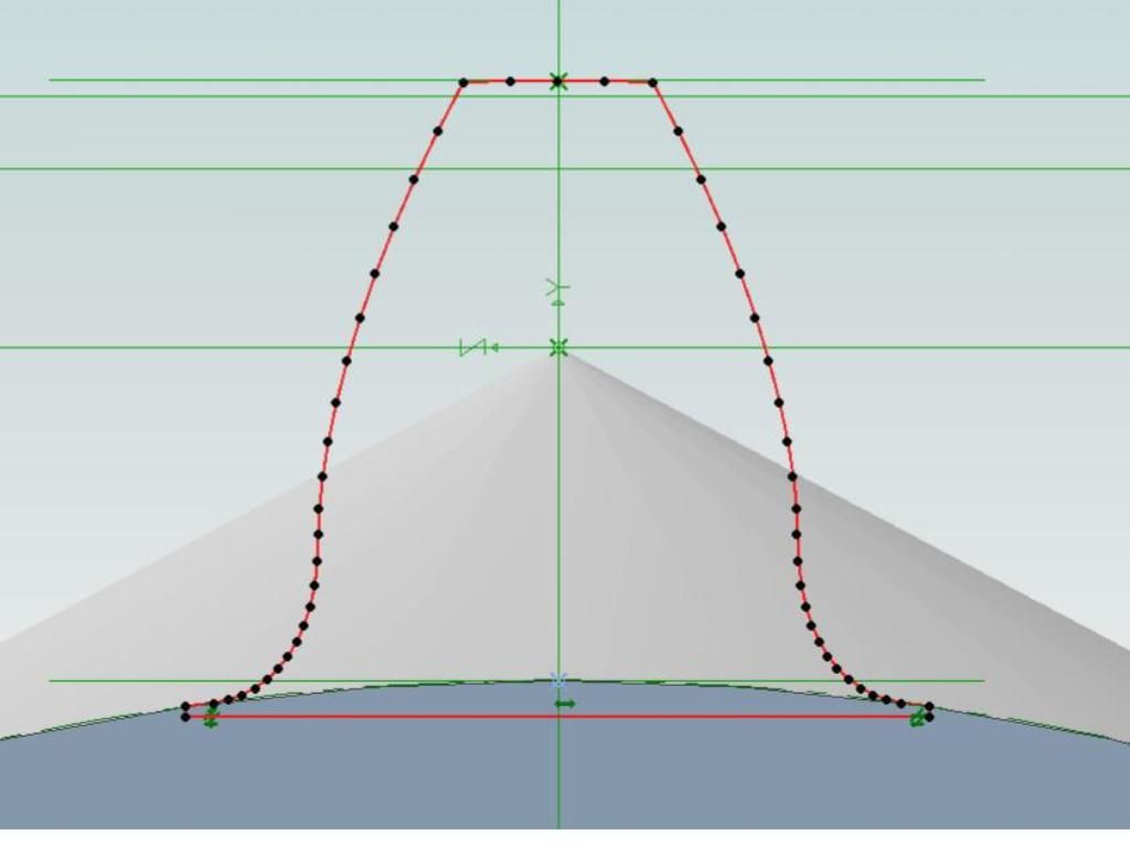

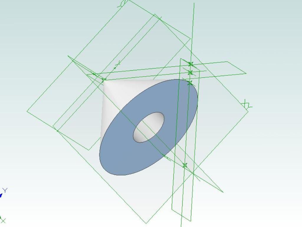

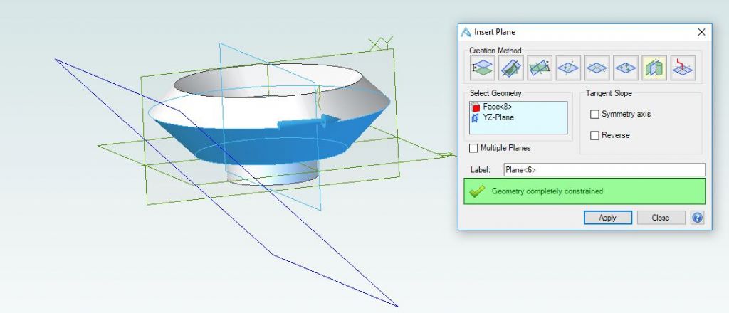

This is how I modelled a bevel gear, although be aware that I use Alibre Expert. First I calculate all the parameters. Then I set up the construction planes and axes to get a plane that represents the outer face of a tooth. Then I draw a cone that represents the root angle cone. The gear is initially drawn as 1DP.
Then a sketch representing the involute function of a single tooth is placed on the plane representing the face angle of the outer edge and adjusted to line up with the root cone. The involute sketch was imported as a DXF gear, the unwanted parts deleted and the DXF exploded to give a sketch consisting of straight lines. All in all a bit of faff:

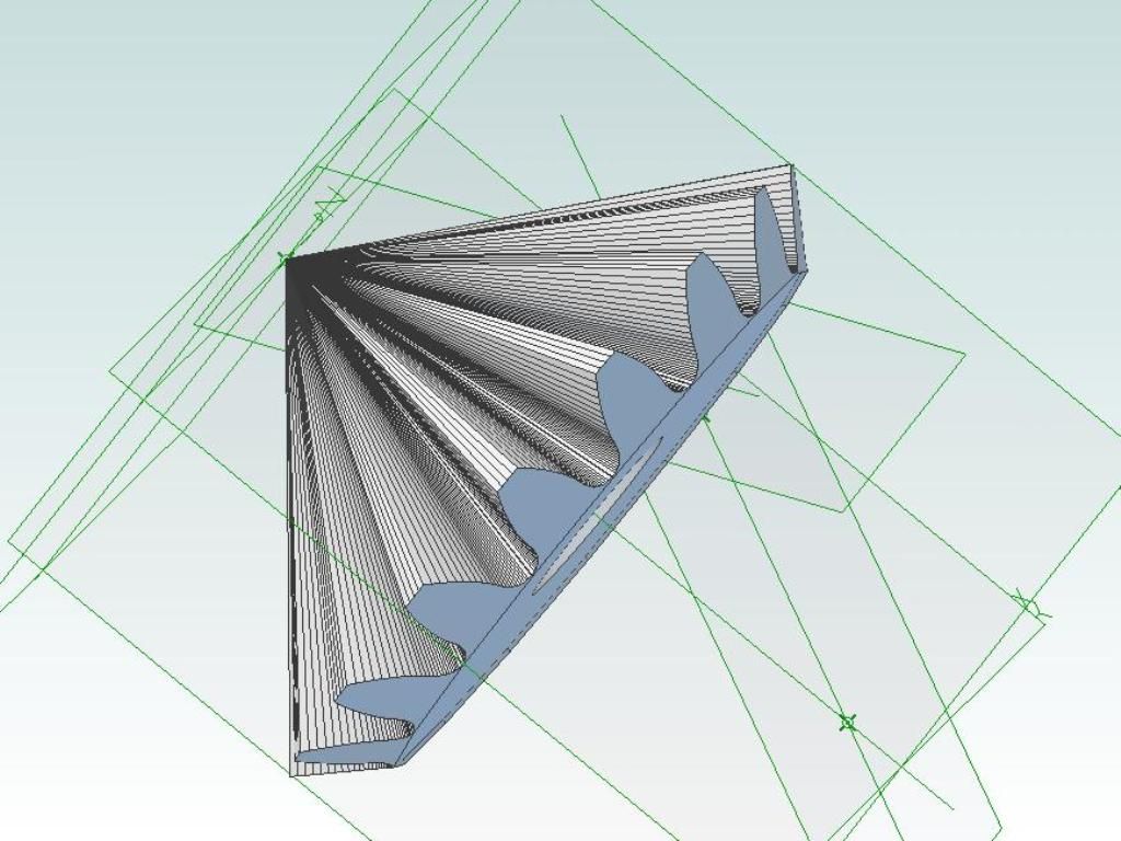

The sketch is then lofted to a single point at the origin to form one tooth:

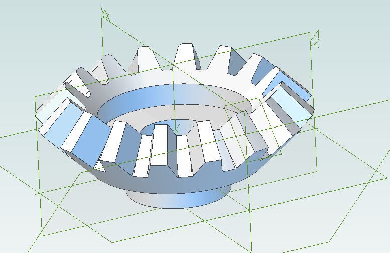

There seems to be bug in Alibre here; the loft won't work to a point even though the manual says it will.. I needed to draw a 2 thou square, 7 thou above the origin, and then the loft worked. Note that the outer edge of the tooth isn't a good fit. That's because the sketch was drawn on a plane rather than projected onto the cone that represents the outer surface of the gear. Next is a simple circular pattern for 16 teeth, although it takes a while to compute:

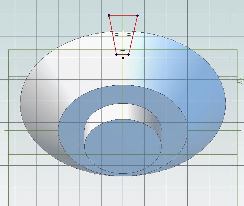

Finally a nunber of simple revolve cuts tidy up the model so we have a proper gear:

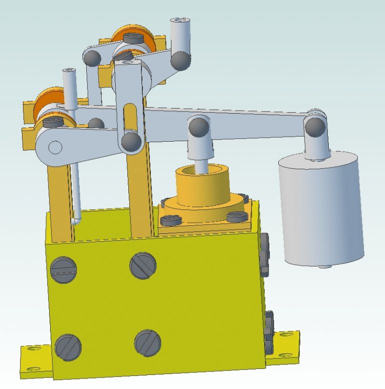

An assembly can then be created to visually check meshing:
