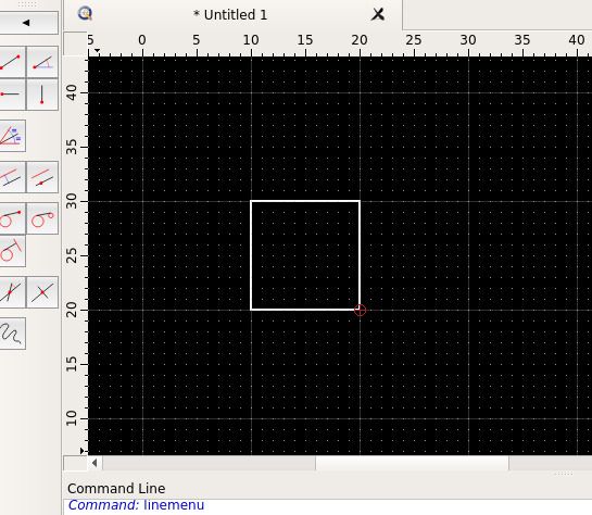

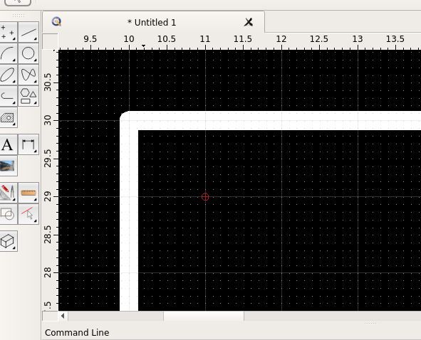

                            Here I've drawn a 10mm square. The grid has dots at 1mm.
                            If I zoom in on the top left corner:
                            the grid scales to a more helpful resolution. The dots are now 0.1mm apart, which is helpful for working on a detail.

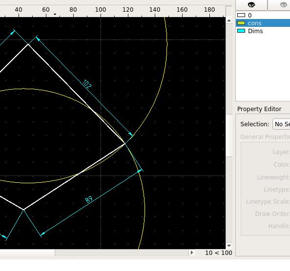

                                      Posted by Peter_H on 14/07/2018 22:31:25:
                                      So what is the grid?. Is it a 1mm grid or a 10mm grid?. If I want to snap the cursor to a specific grid multiple, I want it to be defined by me. The whole idea of a grid that changes is an anathema to me. If I want to snap to a 1mm grid, I want exactly that, I don't want it to change to 10mm or 0.1mm depending on zoom level. I cannot see how there is any application for that. The only thing that comes to mind is that maybe you see the grid as some sort of visual aid, where the normal in my experience is that it is something to magnetically snap the cursor to.
                                      The snap settings don't seem to be very stable either. I have twice lost application grid settings between program runs, and whether the grid icon and the auto icons, under the snap menu, are on or off at any particular time seems completely random. However many times I turn Auto off and click Grid on under that menu, they just revert at what feels like random intervals. Either there are some big bugs around this area, or, more likely, I'm missing some setting.
                                      Other than that quirk, it's the best 33EU I ever spent. Excellent piece of software, I'd use it for 2D work by preference.
                                      That's interesting. I thought it was possible to lock the grid to work as you describe, but the application settings sort of but don't quite work as I expected. It may be worth raising on the qcad forum.
                                      Could be an example of horses for courses – you use the tool differently to me! I'd not spotted before how the grid behaves because I rarely use the grid as my main snap guide. I use it to establish the base point and it's convenient for drawing lines that happen to fit the grid. But quite often my lines don't snap to the grid.

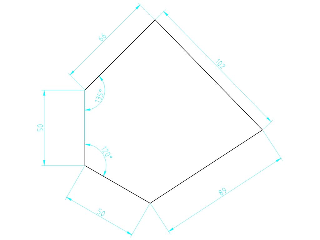

                                      My typical mode of working often requires a construction layer, maybe several. They contain the lines, circles, intersections and dimensions that establish snap points to suit the object I'm drawing. And, the more complex the drawing, the more likely it is that lines must be referenced from drawing features rather than a fixed grid.
                                      Try drawing this object with the grid:
                                      While qcad's approach to scaling the grid happens to suit me, it's not good for what you're doing. It may help to keep an eye on the grid scale at bottom right:
                                      10 < 100 means the dots are 10mm apart and the tiny dotted lines 100mm.
                                      Edited By SillyOldDuffer on 15/07/2018 12:54:54
