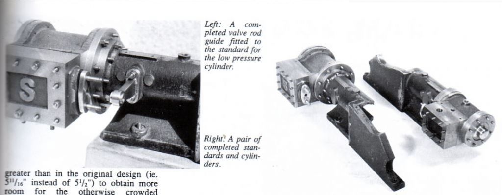

      Just don”t forget what I mentioned about getting to the standard to fit the cylinders with extra studs.
      #339892
        When John Bertinat did his compound version using many of the same castings he managed to use 8 fixings. To do so the minimum of metal was taken off the cylinder mounting flanges thereby increasing it's diameter, fixing size reduced from 6BA down to 7BA whichcombined allowed the PCD to be increased by 1/8" so the fixings had more clearance to the trunk guide.

            Thanks for the praise, Emgee and Chris, much appreciated although that was not what I posted for. Engine was 95% complete when pics were taken, see through oilers and drain cocks fitted since.
            Just wanted to say that the clearance is limited between the cylinders and standards, was a pain to fit the nuts to the studs with the room available, took a lot of work to provide clearance with the Dremmel.
