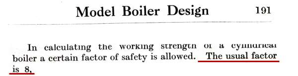

              Yet the UTS Method proclaims a FOS of 8 (Average)
              Clearly the UTS Method is both incorrect and misleading, because it does not allow for the Yield Point of annealed copper.

                                              There are three (3) main points of the YPM that people on this forum continue to ignore. Continue to ignore.
                                              1) Nobody can explain nor justify the so called “safety factors” in the UTS method. They all seem to stem from Henry Greenly’s book written in 1915. Repeat: 1915. That’s 110 years ago.
                                              Why on earth do people still cling on to that ancient and unfounded belief?
                                              henry-greenly-page 191-annottated-600
