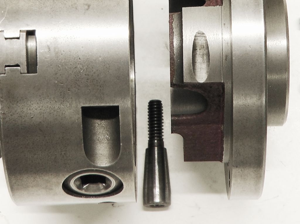

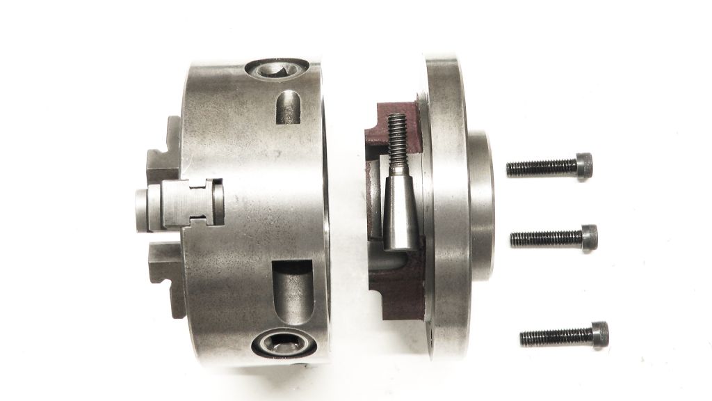

2.    Adjustment wedges removed.
There are also three tapered wedges (for want of another word) which screw into the body and mesh with machined grooves in the back plate protrusions. Photograph 2 shows these removed using the dedicated hexagon on the chuck key fixed cross bar. These must be removed prior to removing the back plate photo 3. Photograph 4 shows the small, machined groove that the taper meshes in.

4.    Showing how the wedges mesh with the taper slots.

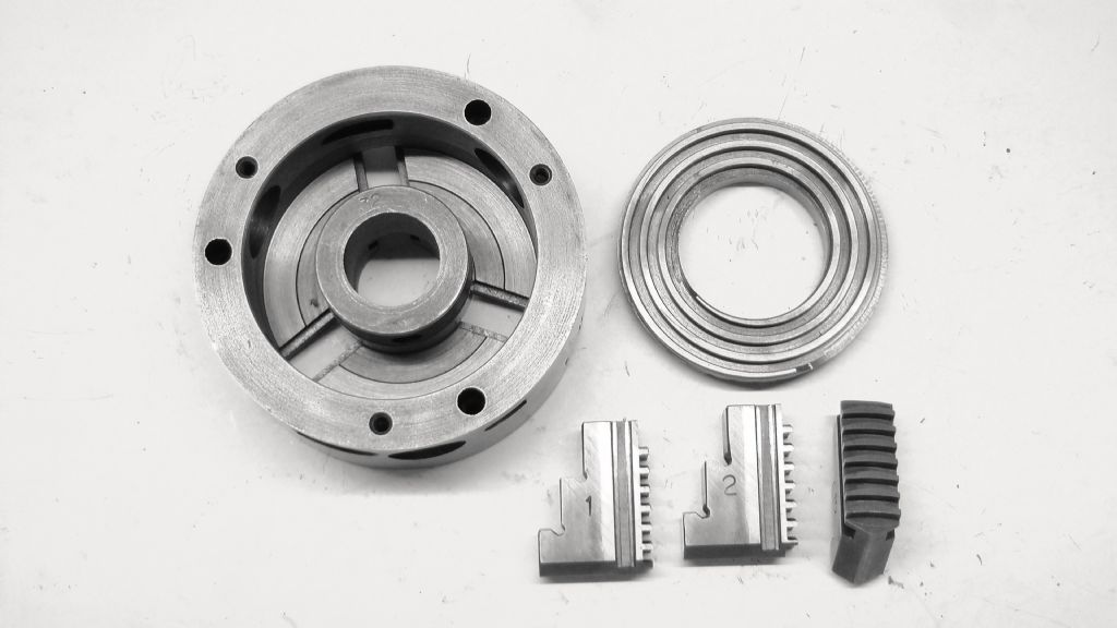

Photograph 7 shows the scroll and chuck jaws removed. The jaws could have been removed before starting the dismantling.
7.    Fully dismantled chuck.
Everything must be cleaned leaving no swarf, especially in the scroll grooves and the teeth on the jaws which mesh with it. Reassemble in reverse order with Molybdenum grease, sparingly on the running surfaces and a small blob on the scroll teeth. Do not put any on the jaw slides or the actual scroll, they will collect swarf.
