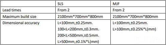

Both MJF and SLS offer industrial-grade 3D printing with high dimensional accuracy. MJF is slightly outperforming in dimensional accuracy, mainly because the MJF printhead prints at 1200 DPI ( or about 1 dot per 0.022mm ), while the typical laser spot diameter of the SLS system is about 0.3-0.4mm. In addition, the detail agent used in MJF helps print fine features and sharp edges.

Tolerances for SLS and MJF in PCBWay
