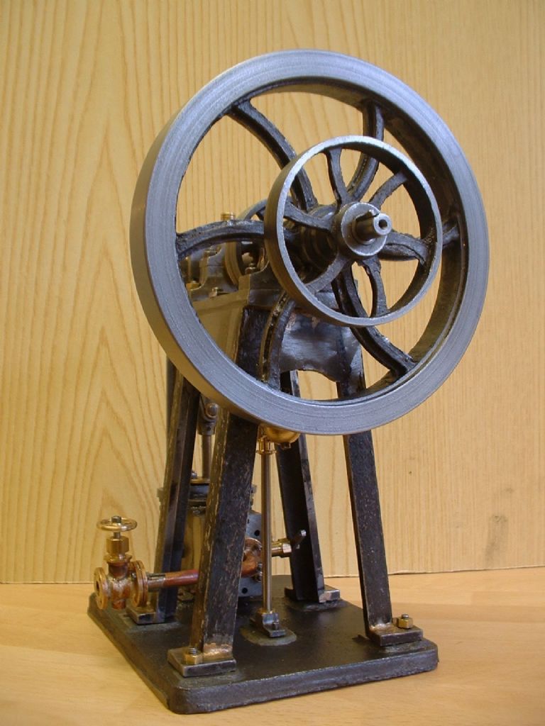

A tiny sketch, reproduced here larger than original size accompanied the letter. I had been considering making a scale model of an ‘interesting’ prototype for some time. Despite its apparent simplicity, the sketched engine was characterful and immediately appealing – it is clear why it attracted Mr Lees notice. The ‘bed like a table’, distinctive flywheel and the arrangement of cylinder and slide bars all looked like presenting worthwhile challenges. None of these challenges was too difficult to overcome, and the end result was an unusual and rewarding model (Photos 1,2).
Nordern steam engine
Nordern steam engine three quarter view
The model is based solely on Mr Lees drawing and description. In all cases I followed the dimensions in the letter exactly. Except where the sketch is obviously simplified, I followed it as closely as is practicable. I don’t claim perfection, and there are a few areas where constructors might improve on my interpretation.

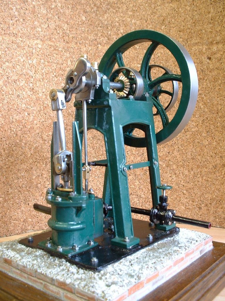

I produced my own patterns and had castings made for key components and tried to avoid buying in anything other than fixings. On the whole, I achieved my aim, which makes an unusual model of a unique engine. Although there were some interesting puzzles along the way I didn’t encounter any problems that would stop any model engineer from doing the same. Whilst I can’t promise anyone a gold medal, I am happy to assert that any reader of this magazine who has already built a simple steam engine, is capable of building the engine.
To summarise what I did myself: all of the castings (base, cylinder, pulleys, flywheel) are from my own patterns. The patterns for the flywheel and the two smaller pulleys were turned and milled from solid disks of aluminium alloy. The pattern for the base was fabricated from basswood (lime) and birch plywood. That for the cylinder comprised several materials, including wood, aluminium and acrylic sheet.
Some other details of the model are that castings were obtained for the steam chest and its cover and the cylinder top cover, but the patterns were undersized and the parts machined from the solid instead. I have since remade the patterns for these parts. The table is not a casting; a pattern was prepared, but rejected as too complex to cast at this scale.

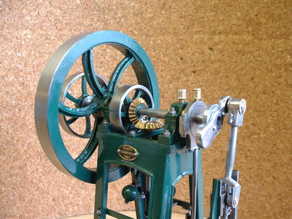

The governor spindle runs in brass bushes and operates a butterfly valve on the front of the steamchest. It works, but is not very effective – speed control is best left to careful adjustment of the steam stop valve. All the parts assembled to the crankshaft are held in place solely by cotters and wedges, and the piston rod bearings have three sets of wedges and cotters. I machined the bevel gears with my own cutter made using the methods described by Ivan Law. I used brass gears rather than cast iron ones, though brass were used on some prototypical gears of this size (9” diameter) cast iron would be more likely.
Aside from production of the patterns, the model took about five months of spare time to construct. The main machine tools used were a much-modified Clarke CL300M lathe, a pillar drill and an ARC X2 mill. My bandsaw also played its part.
The finished engine runs smoothly and very quietly on air at less than 1.4psi (Measured on a genuine and rather fine 19th century Compound Gauge by Bourdon of Paris, reading +/- 4psi) at a steady 70 rpm, and with care can be persuaded to run slower than this.

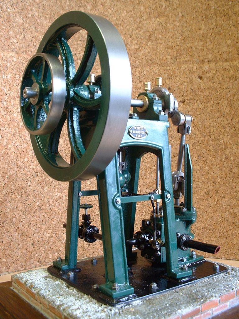

I have since discovered, or been guided to, a small number of Chadwick engines., notably at the Northern Mill Engine Society and the Manchester Museum of Science and Industry. These engines all appear different to Mr Lee’s description of Norden, which may represent one of Chadwick’s earlier engines. All of these engines have three features not seen in Norden – the A-frame is bolted down inside the angle of the legs and the guide bars are braced to the A-frame, finally, the ‘alligator-crosshead’ is hollow and the connecting rod has a single eye, instead of a fork as I have modelled it. You may wish to incorporate these features in your model, as I suspect that this would have been the arrangement on the original prototype of Norden..
Post-Postscript
As a, hopefully, final note to this tale I was unsatisfied with the rough 'concrete' base. I modified this by levelling it and adding sandstone flags, which I think looks much better.
