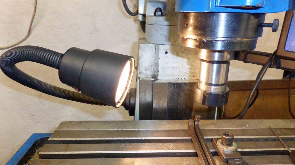

My Chester 6”x26” vertical mill, around 10 years old, was supplied with a with a low voltage halogen spotlight photo 3. The light from this machine light is yellowish but at least the bulb is protected from flying hot metal behind a glass sheet and it can be positioned close to the work with the goose neck support arm. I find I have to remove the protective glass shield and give it a good clean, as oil seems to burn onto the hot glass. A work light like this is very desirable I find and if the mill didn’t have one I would have added a more sophisticated Quartz Halogen spotlight or LED light.

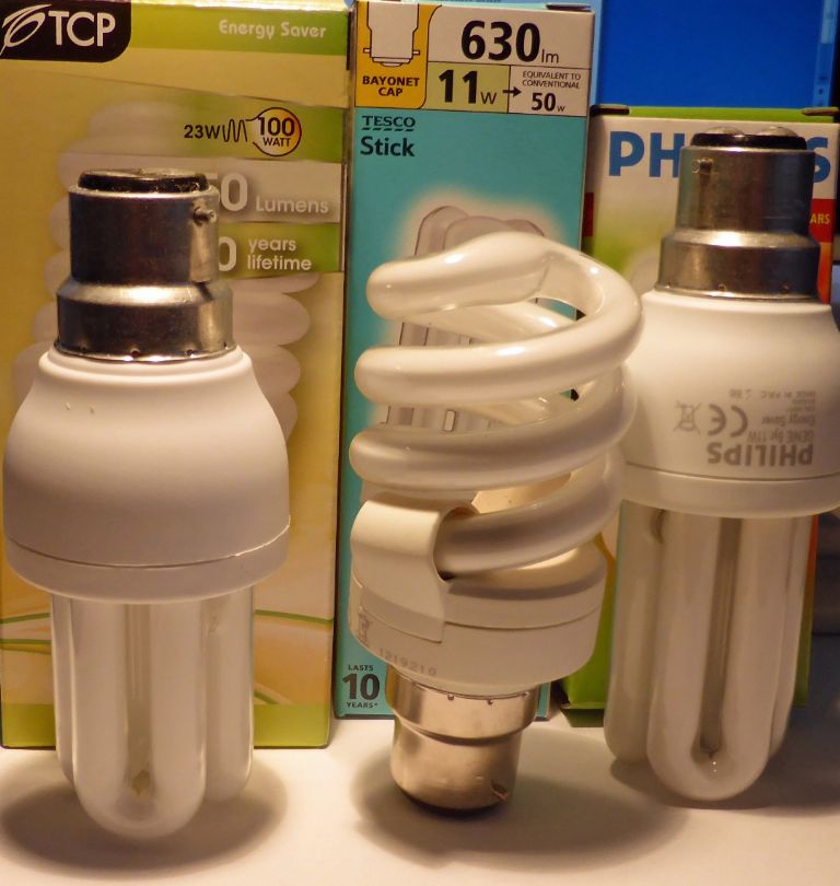

These are a miniaturised version of the office overhead fluorescent strip light. Roughly 9 watts input will produce 450 lumens and the light colour can be tailored by manipulation of the phosphor coating inside the glass envelope. Photograph 5 shows the type of bulb which most will immediately recognise as the ‘energy efficient light bulb’. These are available as screw in or push and twist replacements for the old incandescent light bulb. They save energy, last a long time (over 10,000 hours but this is shortened by repeated on/off operation).
Compact Fluorescent Bulbs 5
Despite all their energy saving performance CFLs annoy many users because they don’t achieve full brightness for some seconds; this is especially true in a cold workshop and some designs seem worse than others in this respect. These CFL bulbs contain electronic ballasts, which is one reason why they cost more than filament bulbs.
Millions of these CFLs were distributed ‘free’ in the UK by Electricity Supply Companies in preparation to the switch over to low energy lights a few years ago. By shopping around one can find 5000K+ CFLs and these give a good white daylight colour temperature and quite acceptable CRI. These are definitely worth searching for, in my opinion. I try to avoid those offering ‘warm soft white’ 2700K bulbs. Some manufacturers use all sorts of names to avoid quoting degrees Kelvin. Colour rendering of about 80% seems common.

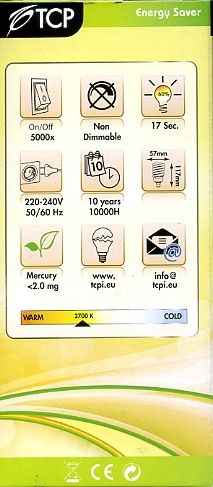

Normally a 23-watt CFL is quoted as 100-watt equivalent. CFLs show a huge energy saving over filament bulbs, though some users maintain that the Industry exaggerates the quoted wattage equivalent compared to a filament bulb.
Some CFLs can be dimmed, most not, so read the box before purchase. A typical CFL box will have a panel of symbols similar to this that tell you most of what you need to know. Notice that CRI is missing from this particular one. See photo 6 for the general label and photo 7 for the efficiency label.
lighting Information label  6          Energy efficiency label 7
CFLs contain toxic mercury and many countries have collection schemes for end of life units to stop mercury escaping into the environment via landfill. The mercury is recovered and recycled. Without the phosphor coatings the light produced by CFLs would only be the mercury emission lines, which contain a lot of Ultra Violet. UV is not good for your skin or your eyes. To get the colour temperature required a mix of different phosphors is used as a coating inside the glass envelope. Phosphors absorb UV and re-emit it as visible light.
Because most electronic ballasts in CFLs operate at a much higher frequency than the 50 or 60 Hz mains frequency, combined with the persistence of the phosphors, the risk of stroboscopic effect is apparently quite small. The stroboscopic effect is observed when moving objects appear stationary under a flashing light. Remember the Old John Wayne movie Stagecoach where the wheels appeared to turn backwards or were static? There must have been serious Industrial accidents in the past with the old fluorescent tubes with mains frequency ballasts.

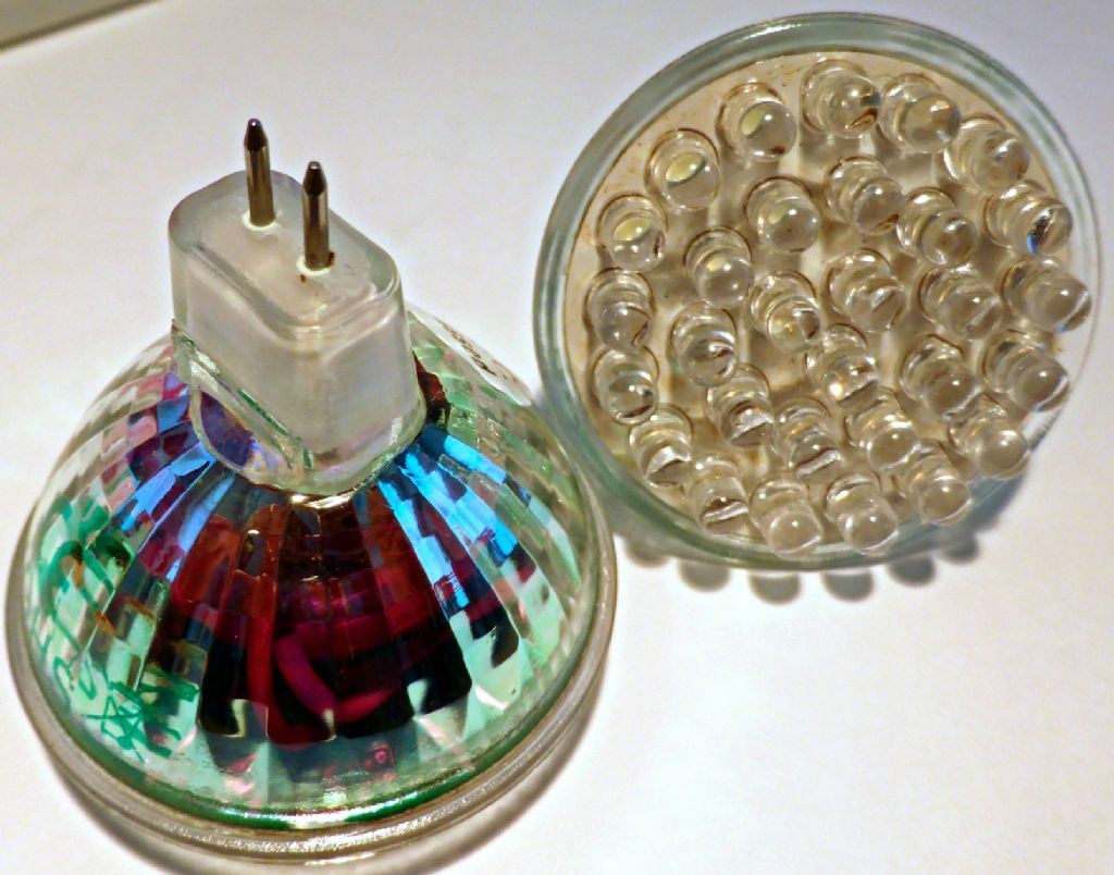

Photograph 9 shows a fairly recent MR16 LED downlight (spotlight) which is rated at 12volt AC/DC 1.8 watt that claims the performance of a 30 watt halogen. As you can see it’s constructed with 30 individual LEDs mounted in a glass reflective envelope. It has colour temperatures of ‘day white 6000-6500K or ‘warm white’ 3200-3500K. Plugging this into an existing circuit produced a brief flash of light then it extinguished! The existing transformer produced too high a voltage at the new lower current and the internal circuits shut the bulb down. Clearly specialised LED drivers are required.

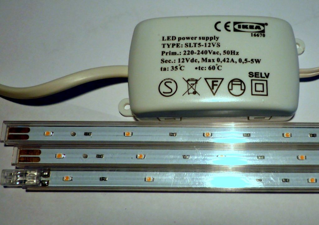

Photograph 10 shows a LED light strip and its power supply (driver) sold to provide lighting in display cabinets. The strip can be extended by plugging units together. These are examples from the IKEA Ledberg range.
The small yellow items are surface mounted LEDs and the even smaller black dots the resistors. The driver is ‘intelligent’ and can handle different numbers of strips, each being about 0.6 watts from 7 LED’s. Should you have a model display cabinet these strips could be ideal lighting.

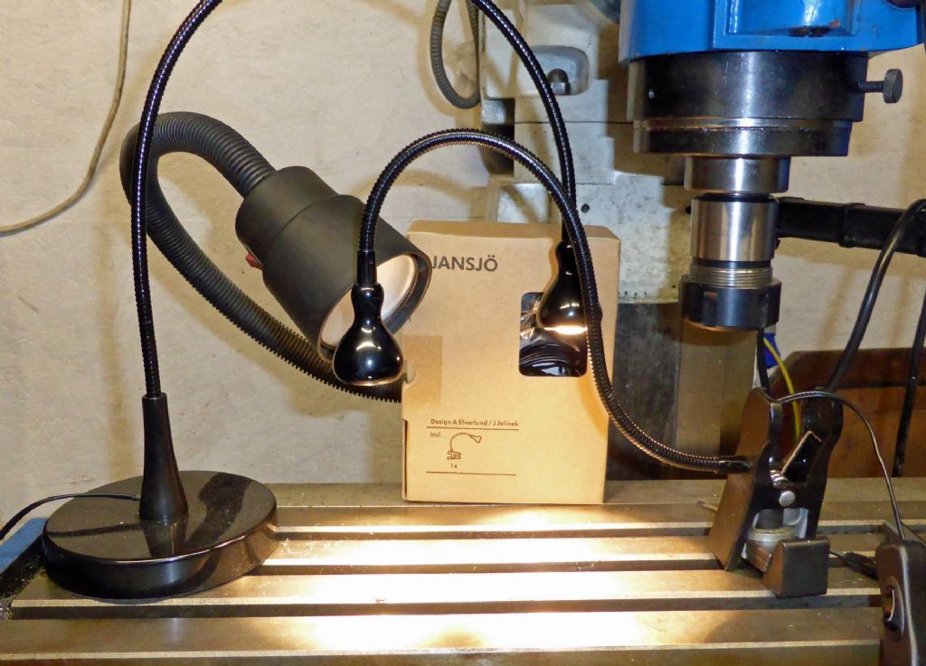

Photograph 12 shows 2 different versions of IKEA Jansjo 3 watt LED desk lamps. Where do IKEA get these names from? These lamps have proved useful in my workshop on the drilling machine and for marking out work. Like all the IKEA LED lamps I have seen they are ‘warm white’ 2700 K. IKEA quote a very long life and the LEDs are not designed to be replaced.
A friend who operates a small lathe and a mill in a garage with no mains electricity, using a 12 volt car battery and an inverter for all his workshop power, found that two of these mounted either side of his mill column gave excellent results. I have to agree. They contain a single SMD LED and I think represent about the minimum power that is useful for detailed close up work.

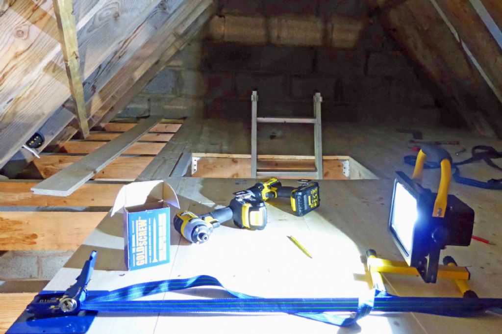

Photograph 13 shows a 10-Watt LED portable work light that has proved invaluable when I was installing T&G wooden flooring in my loft. It is powered by an internal rechargeable battery that can be recharged from the mains or from a car cigarette lighter socket. It has a single COB LED about the size of a postage stamp. It produces 900 Lm for 3 hours with a CRI of 70+ and a colour temperature of 5500K, ‘Cool White’. 90 Lm per watt seems to be the present limit of the LED technology for high powered LEDs. COB stands for ‘chips on board’ and is a method of mounting multiple chips spread out over a wider area to cut glare.
Since I bought this work light from Screwfix it has had a lot of use on all sorts of jobs around the house and workshop.
