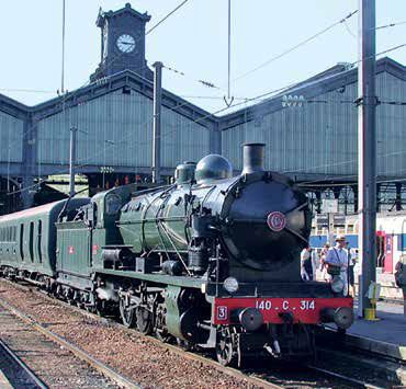

Recently put back onto its wheels after being jacked up for inspection and repair, 140C314 is a 2-8-0 tender locomotive built in 1917 by North British Locomotive Co. Ltd., Glasgow, works No. 21651, for the Chemin de Fer de l’État (photo 1). She is one of a longlived and successful class, the origins of which date back to the final years of the Compagnie des chemins de fer de l’Ouest (West Railway Company) as a separate company before it was taken over (‘le rachat’ or buyback) by the Chemins de fer de l’État (State Railways) on 11 November 1908.

The CFTV’s example (photos 2 and 3) started her career as État No. 140-314, being landed at Saint-Nazaire and allocated first to Saint-Brieuc depot. Following formation of the SNCF she became 140C314 but remained in the Ouest Region (as shown by a figure 3 in a white box on the front buffer beam, just visible in photo 1).

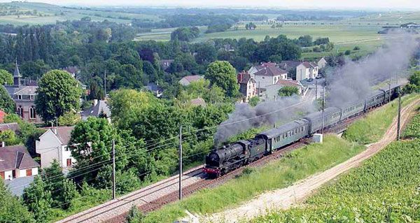

Photo 4: A run to celebrate 150 years of Reims Station.

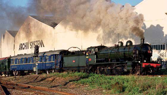

During the Second World War 140C314 was requisitioned by the Germans, being returned to France in 1950. Following repairs which included a new ‘Nord’ type smokebox door and Coale safety valves, the locomotive worked until the 1970s. The locomotive was acquired by the CFTV in 1994 and, in addition to service on the CFTV, has also made occasional forays onto the SNCF main lines on special trains and for filming purposes (photos 4 and 5).

Photo 5: Awaiting departure on the French main line.
