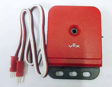

I really couldn’t justify fitting a commercial DRO system but I managed to buy the cross slide screw assembly taken from a Pultra (I think), at a very reasonable price in the club auction and grafted it onto the Perris. I resigned myself to having to make a new dial for the feedscrew when Paul found some rotary encoders on the Internet (ref 1 and photo 1). At less than £10 each I bought two to have a play.

The linear encoders sold by Machine DRO and others are attached to the saddle and cross slide and so tell you directly where the tool is. They are not subject to backlash. A rotary encoder fastened to the feed screw tells you how much you have turned the handle but does not account for backlash. However, when using a lathe you nearly always feed towards the centre with the cross slide and towards the chuck with the leadscrew so backlash isn’t really a problem. This would not be the case with a milling machine (except for the knee up motion, where gravity does the trick). Typical commercial scales have a resolution of 0.005mm, although they are available with much smaller resolution (at a higher price). As will be explained later, the rotary encoder produces 360 pulses per revolution so, with my 1mm pitch leadscrew, has a resolution of somewhat less than 0.003mm. I wouldn’t pretend to be able to work to such fine limits but this shows that the rotary approach has potential. A 3mm pitch leadscrew (appproximately 8 tpi) would have approximately 0.010mm resolution. There is, of course, no reason why the encoder should not be driven by a toothed belt at a higher speed than the leadscrew in order to get finer resolution, although I’d make up some better bearings.

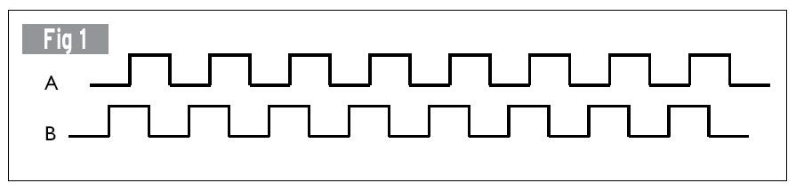

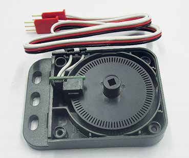

Taking the lid off the encoder reveals a disc with 90 slots and a sensor incorporating two optical switches (photo 2). These are arranged so that each sensor produces a square wave output and the sensors are displaced by ¼ of the distance between the slot centres so that the two outputs are displaced as shown in fig 1.
Each change of state (High to Low or Low to High) is called an ‘edge’, so it will be seen that each slot produces four edges. This is exactly the same as a linear encoder but bent into a circle. As long as you maintain the slot width and pitch, you could make our own disc with as many slots as you like (I haven’t actually tried this). The electronics then sorts out which way the disc is turning and at each pulse adds or subtracts ‘one’ from the current position count. Having previously told the electronics how many pulses represent 1mm (or 1 inch), the count is translated into position and displayed on the Liquid Crystal Diode (LCD).

The slotted disc has an integral shaft with a 1⁄8 inch square hole. As my spigot protruded into the encoder housing, I had to machine a bit off one end. The square drive seemed like overkill to me so I just reduced the end of the leadscrew extension to 1⁄8 inch diameter (strong) and clamped the disc axially with an M3 nut. It was a bit of a fiddle to get the axial position right. The slotted wheel, mounted on the extension without the rest of the encoder, is shown in photo 4.This is when you remember that the screws which hold the two halves of the encoder housing go in from the back. As it was still ‘under development’, some duct tape engineering provided a temporary solution. I will eventually get round to doing it properly. In retrospect it might have been easier to make up a new bracket to hold the optical sensor, and finally fit a cover over the whole thing, not using the existing housing at all.

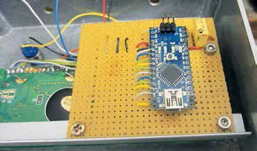

I would have set to and built a bespoke circuit board with a PIC but Paul introduced the idea of using an Arduino nano. This is a ready made board incorporating the controller and various other necessary bits of magic (these can be found for around £10 Ebay). Using this massively reduces the soldering and doesn’t actually cost a lot more than buying the components. Output is displayed on a Liquid Crystal Diode, type HD44780 (around £2 on Ebay for the large digit version but they can be hard to find; the small digit ones are even cheaper if you buy from Hong Kong). All you need then is a push button for the reset to zero and we also incorporated a toggle switch for metric/imperial select.
Power supply is from a 5V mobile phone charger and the die cast box came out of the scrap box (never throw anything away!). The internals and externals are shown in photos 5, 6 and 7).
