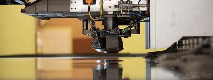

CNC Metal stamping is a manufacturing process used to create metal components. It is the conversion of flat metal sheets into a range of shapes. CNC stamping techniques include punching, blanking, embossing, bending, flanging, and coining. Many are carried out by a metal cold stamping machine and the results are flawless.
 As a manufacturing process, metal stamping is generally low cost and high speed. The process allows for a high volume of production and is an easy way to create lots of identical metal components. It can be used for both short and long production runs.
The Basics Of Metal Stamping
Most metal stamping companies follow the same processes. A high-quality sheet of flat metal will be placed in a stamping press (the sheet metal may be in coil or blank form).
 In the CNC machine, a tool and die surface form the metal into the shape you desire. Depending on what it is you need from the process, there are many types of metal stamping.
