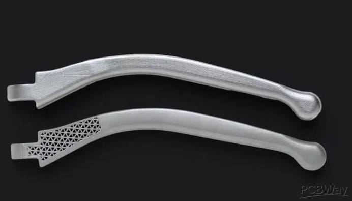

Metal 3D printing is considered the vertex of all 3D printing. The earliest metal 3D printing patent is DMLS (direct metal laser sintering), which was obtained by EOS in Germany in the 1990s. Since then, metal 3D printing has gradually developed many kinds of printing processes. Each metal 3D printer usually uses one of the following four types of processes: powder bed fusion, binder injection, direct energy deposition and material extrusion.

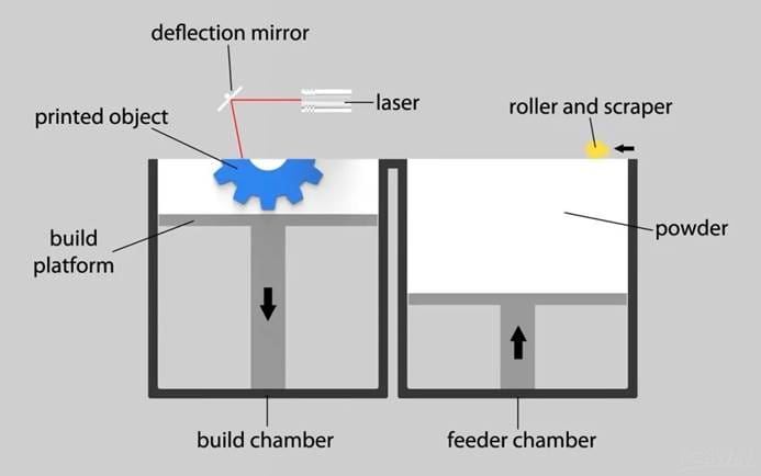

Metal Powder Bed Fusion
Common processes include DMLS (direct metal laser sintering), SLM (selective laser melting) and EBM (electron beam melting).
Description: Metal parts produced by PBF melting technology can reduce residual stress and internal defects, and become an ideal choice for harsh applications in aerospace and automotive industries.
Direct metal laser sintering (DMLS): It can be used for almost any metal alloy building objects. Direct metal laser sintering disperses a very thin layer of metal powder on the surface to be printed. The laser passes through the surface slowly and stably to sinter the powder, and the particles inside the metal are fused together, even if not heated to complete melting state. The additional powder layer is then applied and sintered to ‘print’ a cross section of the object at a time. After printing, the object will slowly cool down, and the excess powder can be recovered from the construction room and recycled. The main advantage of DMLS is that it produces objects without residual stress and internal defects, which are extremely important for metal parts under high stress, such as aerospace or automotive parts, and the main disadvantage is that it is very expensive.
Selective Laser Melting (SLM): Each layer of metal powder is completely melted by high power laser, not just sintered, resulting in very dense and solid printed objects. At present, this process can only be used for certain metals, such as stainless steel, tool steel, titanium, cobalt chromium alloy and aluminum. The high temperature gradient during SLM manufacturing can also lead to stress and dislocation in the final product, thus damaging the physical properties.
Electron beam melting (EBM): It is very similar to selective laser melting and can generate dense metal structure. The difference between these two techniques is that EBM uses electron beam rather than laser to melt metal powder. At present, electron beam melting can only be used for a limited number of metals. Although cobalt-chromium alloys can also be used, titanium is still the main raw material for this process. This technology is mainly used to manufacture parts of aerospace industry.
Technical advantages: It can manufacture almost any geometry with high precision. Wide range of metals, including the lightest titanium alloy and the strongest nickel superalloy, are hard to process by traditional manufacturing techniques. Mechanical properties can be compared to shoulder forging metal, like traditional manufacturing metal parts for mechanical processing, coating and processing. Technical shortcomings: high cost of materials, machinery and operation. Parts must be connected to the build board through the support structure (to prevent warping), which produces waste and requires manual reprocessing. Construction size is limited and metal powder processing is dangerous, requiring strict process control.
△ PBF powder bed melting

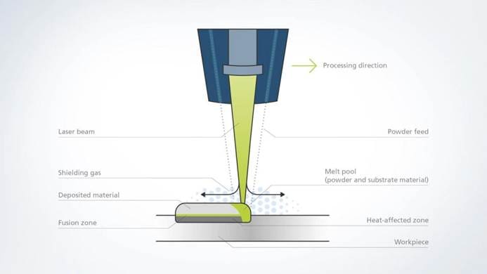

Direct Energy Deposition
Common processes: DED (direct metal deposition), WAAM (arc additive manufacturing), LMD (laser material deposition)
Description: This method squeezes metal, whether it is metal powder or wire, and then is immediately impacted by high energy (it can be melted by plasma arc, laser or electron beam). The energy melts the metal, and the molten pool immediately drops to 3D space for position operation through the manipulator. It is very similar to welding, so one of the main applications is to repair the existing metal parts and increase the functionality of the parts.
Technical advantages: Metal wire is the most economical form of metal 3D printing materials. Some machines can even use two different metal powders to manufacture alloy and material gradient. 5-axis and 6-axis motion can be produced without supporting materials. The damaged metal parts can be repaired and new components can be added. Large volume, efficient use of materials, high density of parts, good mechanical properties and fast printing speed.
Technical shortcomings: Poor surface quality of parts, usually need machining and finishing, small details are difficult or impossible to achieve. Mechanical and operational costs are high.
△ Laser metal deposition (LMD)
