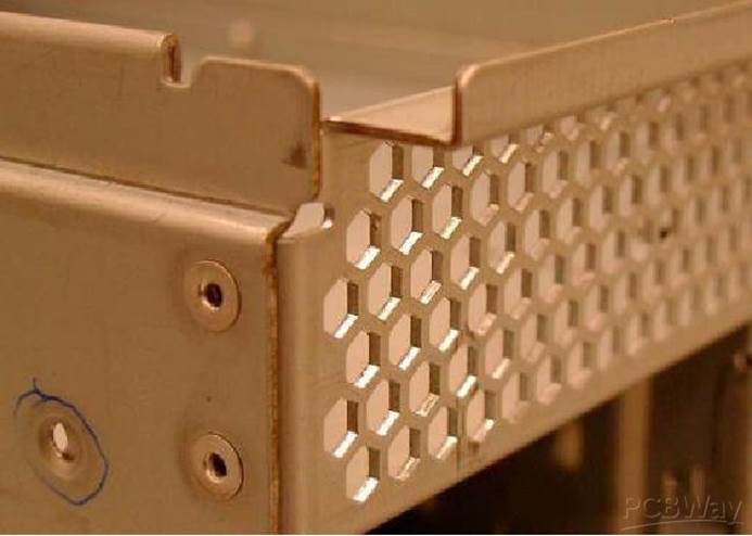

1.For two adjacent holes, the shortest distance from the edge of the hole to the edge of the other hole should preferably not be less than 1.5 times the thickness of the material. Or the female die is easy to crack and the production line is disconnected. Disconnection, mold repair, etc. are the causes that increase the cost and reduce the profit. If it is necessary to be less than 1.5 times the thickness of the material, the tabbing method must be used.
The round hole is the strongest In the mold making, which is easy to manufacture and maintain, but the opening rate is low.
The square hole has the highest opening rate, but the corner edge is easy to wear and collapse because its 90-degree angle, which will result in the need to repair the mold and stop the line. The hexagonal shape has 120-degree angle, which is stronger than the square hole, but the opening rate is a little worse than the square hole at the edge.

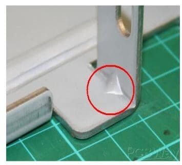

1.After the sheet metal is bent, the metal material will protrude on both sides of the bending angle due to the extrusion material, resulting in a larger width than the original size. The protruding size is related to the thickness of the material used. To avoid this situation, you can make a semicircle on both sides of the bending line in advance. The diameter of the semicircle should preferably be more than 1.5 times the thickness of the material. When the edge material is designed to be folded back, it should be handled in the same way.

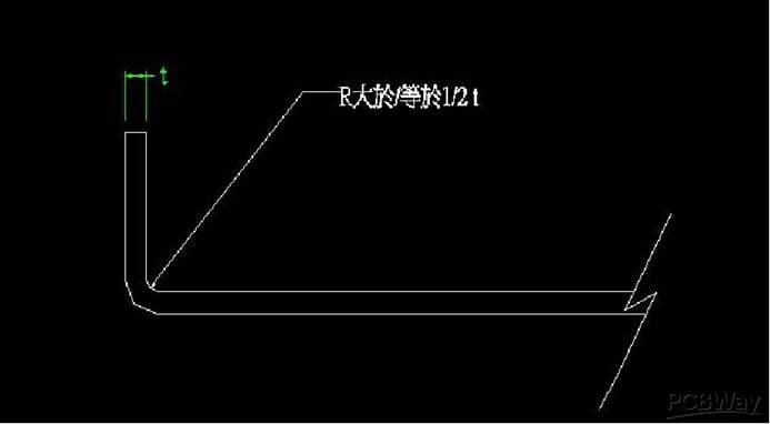

2.When the sheet metal is bent, the internal R angle is preferably greater than or equal to 1/2 of the material thickness. If the R angle is not made, the right angle will gradually disappear after many times of stamping, and the R angle will naturally be formed. After that, the length of one or both sides of the R angle will be slightly longer.

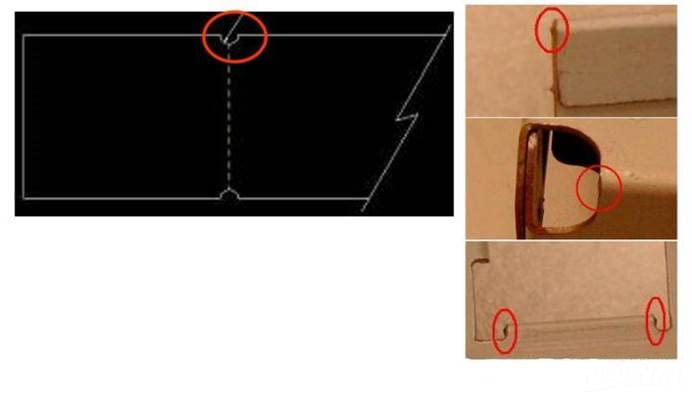

5.The turning point between the plane and the bending surface is best to have a narrow hole, or the edge of the opening should be retreated after the bending, otherwise there will be burrs. Tthe width of the narrow hole is preferably greater than or equal to 1.5 times the thickness of the material. And remember to mark the R angle when drawing. Molds with right or acute angles, male and female molds are prone to cracking. Future line stop and mold repairs are additional losses.
