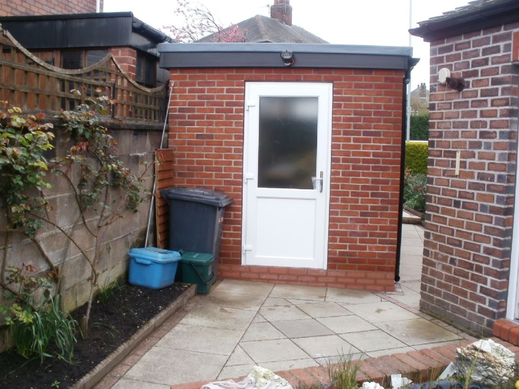

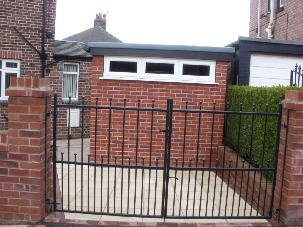

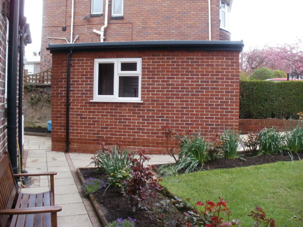

                                      #93146
                                      ianj
                                        @ians
                                        p4220816.jpgp4220815.jpgHi All.
                                        Thanks for the comments and advice. I went for two rows of two double four foot fittings running the length of the workshop set in two feet from the walls.
                                        The walls are single brick with studding and 40mm kings span insulation & clad with 18mm ply painted satin white. I have a high level window across the width at one end & a side window where my lathe is positioned. With individual swan neck lamps for the lathe,mill etc.
                                        All in the end result is excellent , ample lighting & well insullated (cool in summer, & I'm sure it will be snug in the Winter )p4220814.jpg

                                          #93156
                                          I.M. OUTAHERE
                                            @i-m-outahere
                                            Hi Ian.
                                            Thats a cosy looking workshop and being brick will keep the noise down as well .
                                            I recommend that when one is seting up lighting to close all of the doors and pull the shades on the windows because you want the lighting set up so it is suitable for for night time as you don't want the lighting level to change or get worse if the outside conditions change or it gets dark .
