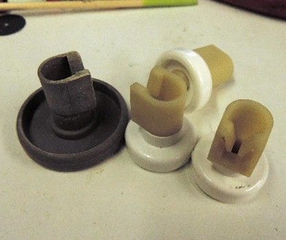

      My daughter's dishwasher has broken. It's obsolete with as far as I can see with no spares available, yet with a bit of DIY it could be repaired.
      What appears to have happened is that the wheels at one side of the upper basket have disappeared – one was found in the bottom of the machine – so all we need are a new set of wheels. Steel will rust, aluminium will corrode, although how fast I don't know, so the answer would be a plastic of some description. So, any thoughts on which would be the most suitable plastic.
      The wheels themselves are similar to a sewing machine bottom feed bobbin, only slightly larger, and no holes in the flanges. The inside diameter consists of a short parallel section, perhaps 5mm long, then a ridge followed by a tapered section maybe 10mm long. Internal diameter about 10 to 12mm. The flanges are 1.5-2mm thick, 22 & 25 mm diameter whilst the centre portion is perhaps 19mm dia and 12mm wide.
      MTIA,

          #163994
            Hi Peter,
            You can get most bits from espares, but if what you see is in the picture below suit, I'll send you a few – once one goes, others follow. They are spares I kept in hand after many years of dishwasher resuscitation, but we bought a different type of dishwasher.
            The white ones are new, the grey one, rather used but OK

              Peter G. Shaw
                @peterg-shaw75338
                Swarf, Mostly,
                Noted. Thanks.
                Neil,
                I've been onto espares, Zanussi, and other sites, and whilst the wheels you show are relatively common, the ones that I need are similar to this:
                http://www.spareparts.ie/shop/Zanussi-Basket-runner-%285031681371672%29.1538?layout=grid&filters=Zanussi-m24
                except that it is, I think Irish.
                This site:
                http://www.buyspares.co.uk/zanussi/dishwasher/wheel-support/product.pl?pid=316144&shop=zanussi&path=10829
                Shows something similar, but does not mention my daughter's Model No.. Or rather, says that it can't be found. Now I could order this up, on spec, and see what it looks like. On the other hand, I may give them a ring and ask for dimensions.
                But just for the moment, making them seems to be the only sure method of getting exact copies.
                Thanks anyway.
                Cheers,
                Peter
                p.s. It's a Zanussi DI720 by the way. I've found references to a DI720B and a DI720W, but not the plain DI720.
