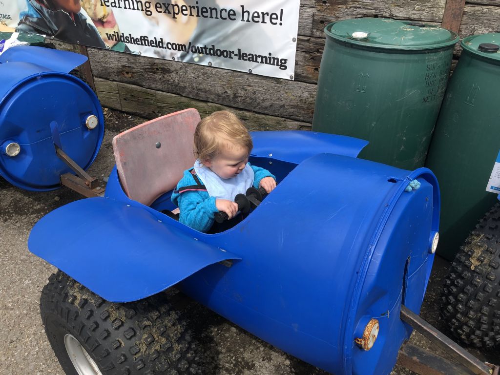

        Can anyone recognise these wheels tyres? And any idea where i can get a pair?d953791b-b83a-4c21-b9c9-7f37b3d8d64f.jpeg
        #414993
          Google "ATV" tyres, for example
          Edited By JasonB on 19/06/2019 11:12:03
          #414998
          Ian Parkin
            @ianparkin39383
            Thanks Jason
            i had searched for “all terrain vehicle” to no avail
            ”atv “ brings up loads !!!!!

              That badly needs a thick rubber edging strip…or harness.

                Ride on mower tyres ?

                  Agree with Jason, they are ATV tyres, they must have sizes on them.

                        thems quad bike tyres…aweful on the road but good in the mud – loads on ebay

                          They are off of a sit on lawn mower used on golf clubs, google Toro grass equipment

                              I like the way the cockpit cutouts have been made into the mudguards.

                                Ian where abouts are you as I have a set going free off my old wheelhorse ride on. Also new tyres an inner tubes.
                                Pm me for more info.
                                Hugh

                                    Posted by old mart on 19/06/2019 22:12:58:
                                    I thought that.
                                    A bit nervous about what might happen if pulling a chain of these and they lock up or twist with kids on board.
