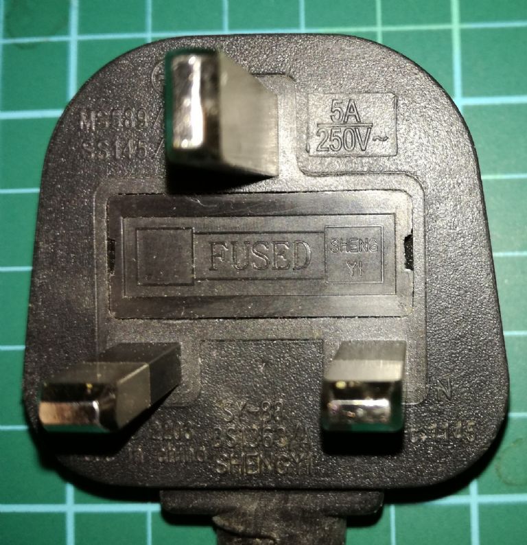

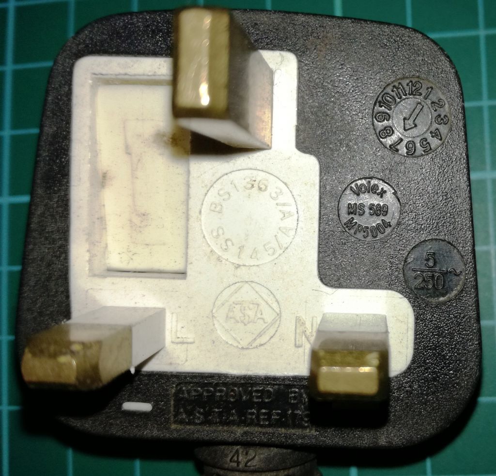

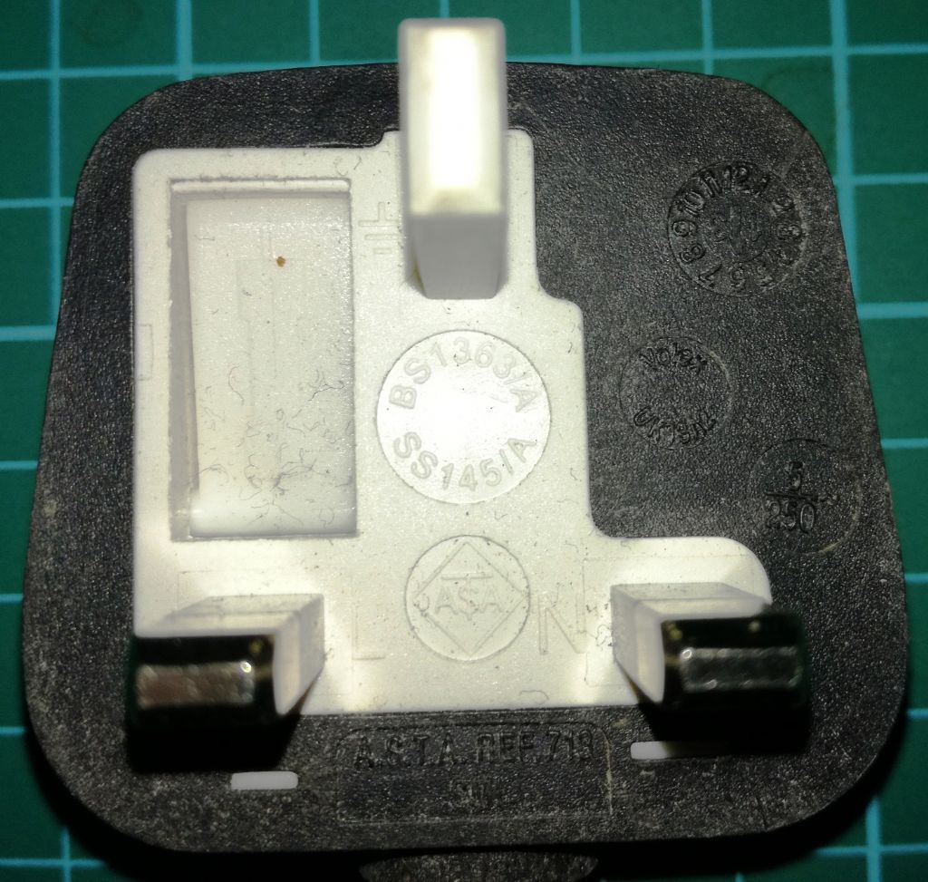

                Moving on to BS1363 type plugs, many of those that have a moulded-on plug and serve a twin flex with a two-pin socket on the end, do have a plastic pin for opening the shutters on the wall sockets, just like many wall-warts have, however, it is important to know that not all of them are capable to carry a 13 A load whether they have a plastic or metal pin in the earth position, and are quite often limited to 5 A and should never have a fuse put in them higher than that stated on the pin side of the plug. Three photos shown below, first and second are twin flex with a twin socket on the end, and the third one is a three core with a Euro three pin socket on the end. The first and third photos shows the amp rating just above and to the right of the neutral pin, while the second photo shows it to the right of the earth pin, and they also show the maximum voltage as well.

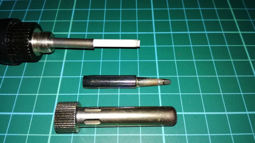

                    Struggling to remember from the mists of time, but I seem to think that some mains soldering irons had isolated ceramic shafts for the bit to fit over???

                        Hi Nick Clarke 3, the one on my soldering station has the heating element buried in a ceramic sleeve, and the tip fits over it and is held in place by a shroud.
