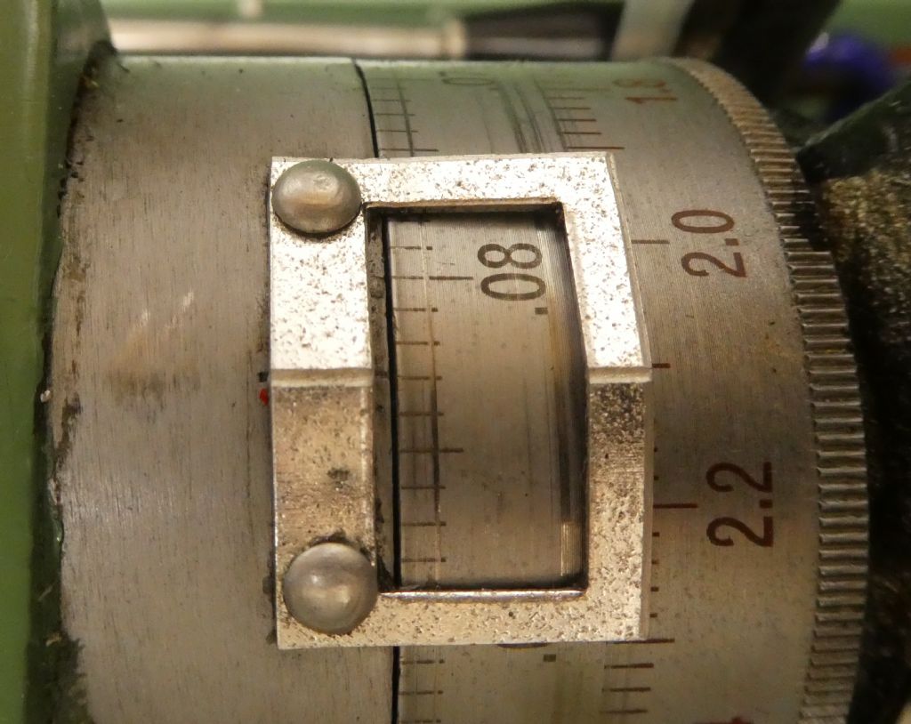

      As you might see from the picture the satin chrome on the dial is being scored by debris collecting under the primitive indicator window. I have already replaced the cross slide dial which was heavily marked but it was quite pricey and in order to avoid further expense I intend designing a "window" with a bit more clearance.
      So to remove the existing windows I need to remove the two bang in self tappers that hold them in place. So what is the best way – and by the way, are these screws hard? If not maybe I could drill them out with a HSS drill?
      Lathe is WARCO BH600G so either Chinese or Taiwanese.

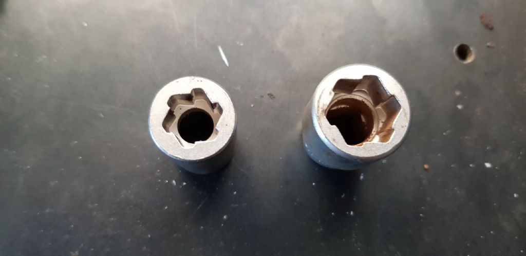

        Steviegtr
          @steviegtr
          Most of those type of fasteners are of the spiral flute design. Usually clockwise. So in theory they need to be turned anticlockwise. I have a set of damaged nut / bolt removers which would, if you could get a small enough one, do the job. Those pins are usually made from a hard material.
          Steve.

          Pete Rimmer
            @peterimmer30576
            They are called drive screws. I usually lift them by carefully tapping old feeler gauges under the plate they are holding down. Go slowly and you can raise the drive screw enough to get side cutters under the head.

            J Hancock
              @jhancock95746
              Or try to put a ultra thin Dremel cutting disc slot across each one and use a screwdriver on them.

                old mart
                  @oldmart
                  Some careful tapping with a wedge with a similar profile to a wood chisel between the head and the plate, not just in one place, but at several positions. Then as the head starts to lift, a blunter wedge and finally they should be high enough to turn. I would expect them to have a right handed helix.

                    noel shelley
                      @noelshelley55608
                      Gentle tapping in all directions will normally loosen them. A very small chisel is ideal for applying the tapping and pliers to unscrew them. plan B, grind 2 flats on opposite sides and mole wrench to unscrew.

                        Clive Brown 1
                          @clivebrown1
                          My Warco 16B mill had nothing as sophisticated as hammer drive rivets holding the index marks. Just aluminium round head rivets seemingly banged in skew-whiff by the youngest apprentice. They were the worst feature on an otherwise well finished machine. When I decided to replace them they popped out easily with a small chisel. i drilled the holes deeper, tapped 7 BA, or M2.5 in new money, and retained the markers with small screws.

                                          Howard Lewis
                                            @howardlewis46836
                                            Hammer drive screws are HARD, and will fracture if the blow is sideways on
                                            If it does not break when hammered sideways, it will enlarge the hole, reducing grip when replaced..
                                            Being dome headed, they are difficult to grip, but with a good ole Grip, (Vise Grip etc ) they can, eventually be unscrewed. Patience and some strength is needed.
                                            Can you manage to bend the "window" upwards a little, rather than remove?
